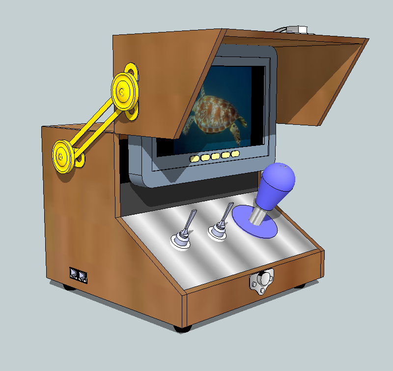

That box looks really nice :shock: How do you plan on keeping the screen up?
Pilikia
Posts: 65
Location: Kauai, Hawaii
Re: No Name ROV
Post by Pilikia »
Something like this, I guess . . .
Byron Jonson
Posts: 12
Joined: Aug 17th, 2011, 10:39 pm
Re: No Name ROV
Post by Byron Jonson »
Hmm... I might have to steal this design. :twisted:
That is, you know, if you don't mind. :|

SoakedinVancouver
Posts: 117
Re: No Name ROV
Post by SoakedinVancouver »
The turtle is not swimming, and there is no coffee stains on the map, yet I am so impressed! Let's see the final product soon, eh?
Pilikia
Posts: 65
Re: No Name ROV
Post by Pilikia »
SoakedinVancouver, yea, yea, yea, I'm about to pull the trigger (I think). But modeling the turtle swimming and the boat rolling enough to slosh the coffee out of the mug are good ideas too. :D
What I'm really trying to do is learn this FREE software, called SketchyPhysics, a plug-in that works with Google's FREE CAD program, SketchUp. It supposedly enables being able to apply "real" forces to virtual objects. It includes things like mass, buoyancy, viscosity, thrusters, motors, hinges, servos, to name a few maybe relevant to ROVs.
Actually, the program (SketchyPhysics, not the very stable SketchUp) seems to be in early beta, has no documentation, and is highly prone to crashing at any moment for no apparent reason. It pretty much drives me crazy! :evil: But maybe I just don't have the hang of it yet.
The attached video shows an early version of my ROV being dropped into the water, then being driven around by thrusters positioned at the propellers, which are shown spinning whenever a thruster is being used. It's not very convincing because there's no time lag between the props beginning to spin and the thrusters moving the ROV. There's probably a way to fix that, but I haven't found it yet.
