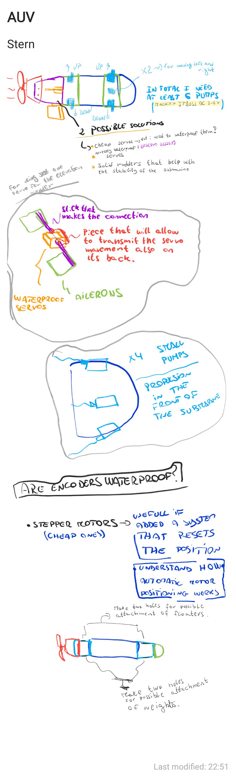

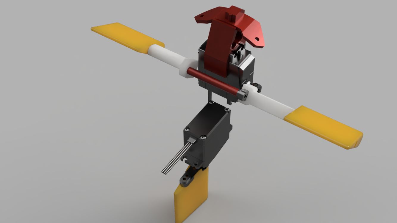

I also started to put on "paper" some possible ideas that I had to make the rudder and aileron part and for the descend ascend module. What do you think?

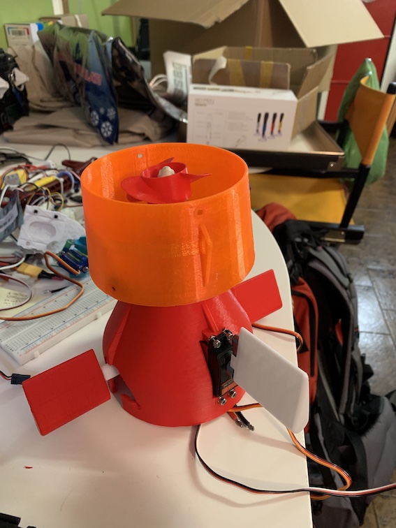

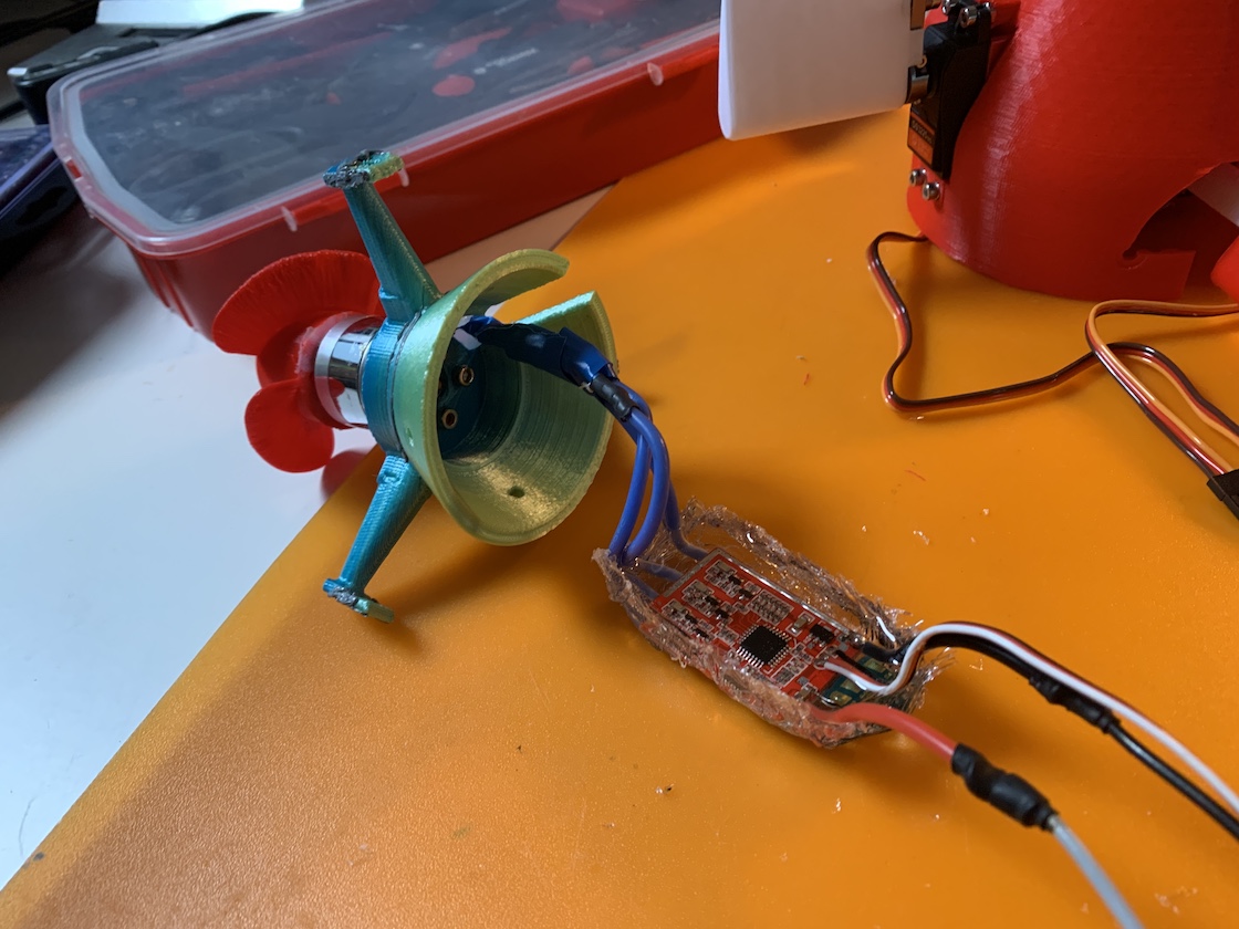

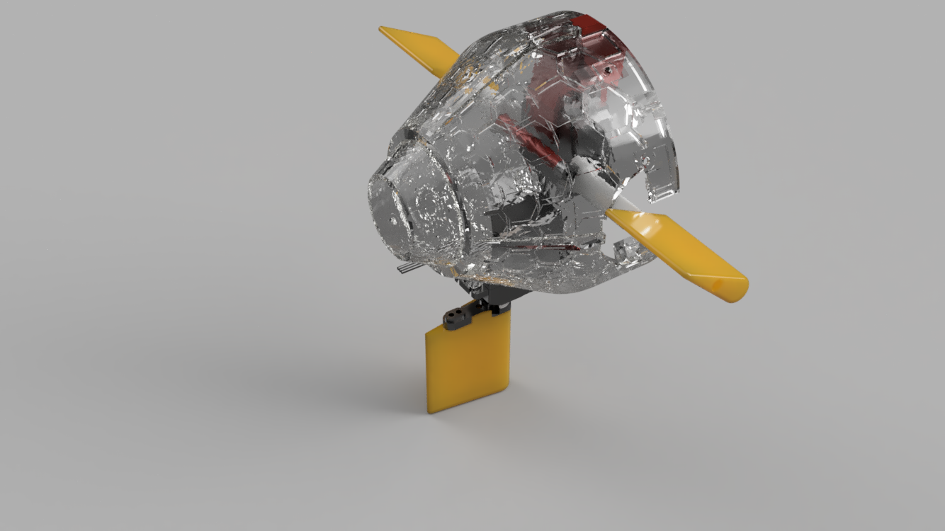

Heres the stern 3D printed. Tomorrow I will use resin to waterproof the esc. The bottom file is a little gif.
fryslan76 wrote:Beautiful designs
And thankyou :)

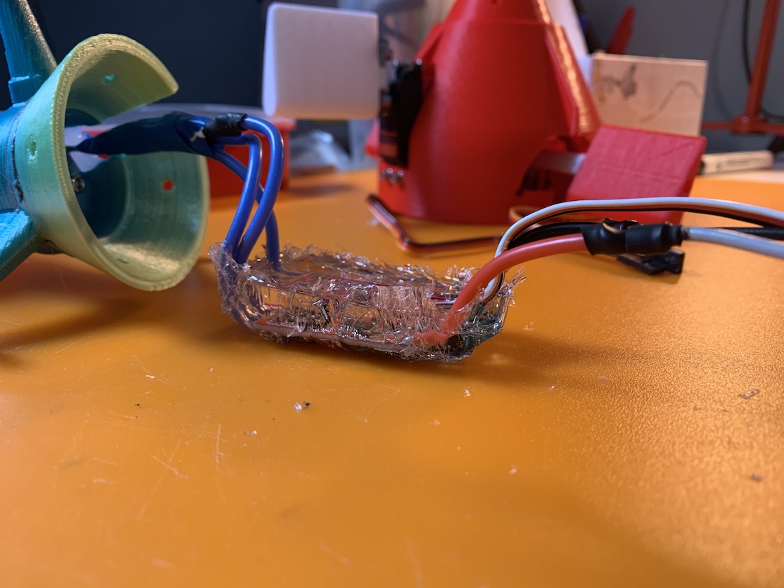

Hre is the ESC waterproofed with epoxy resin...

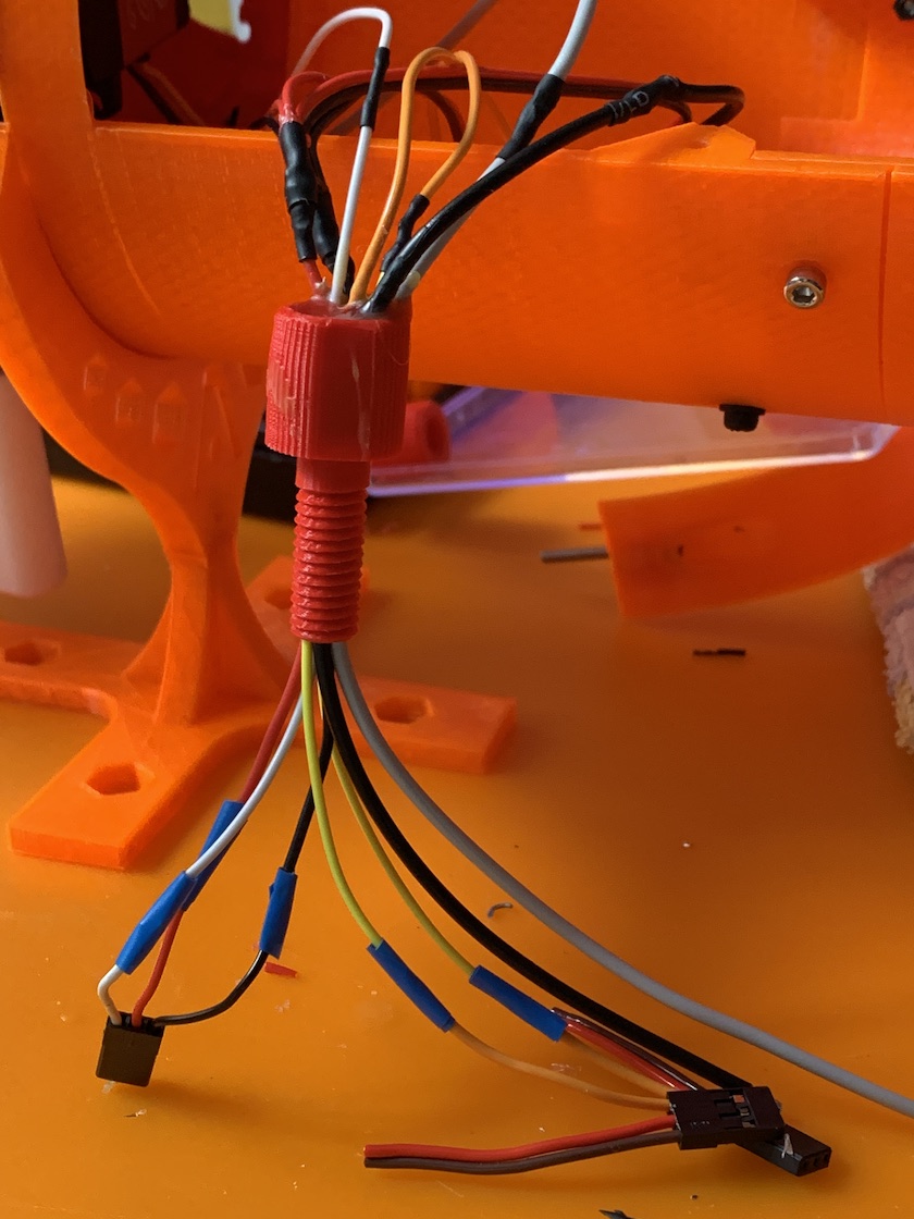

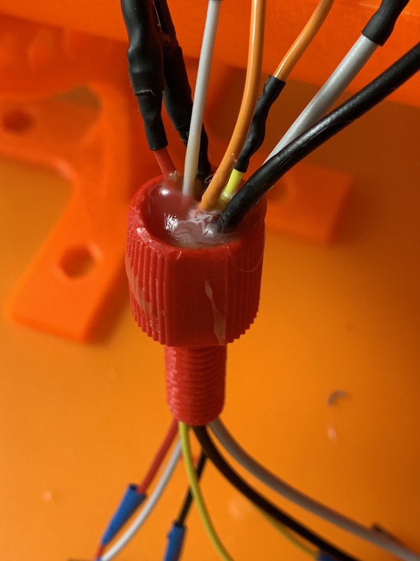

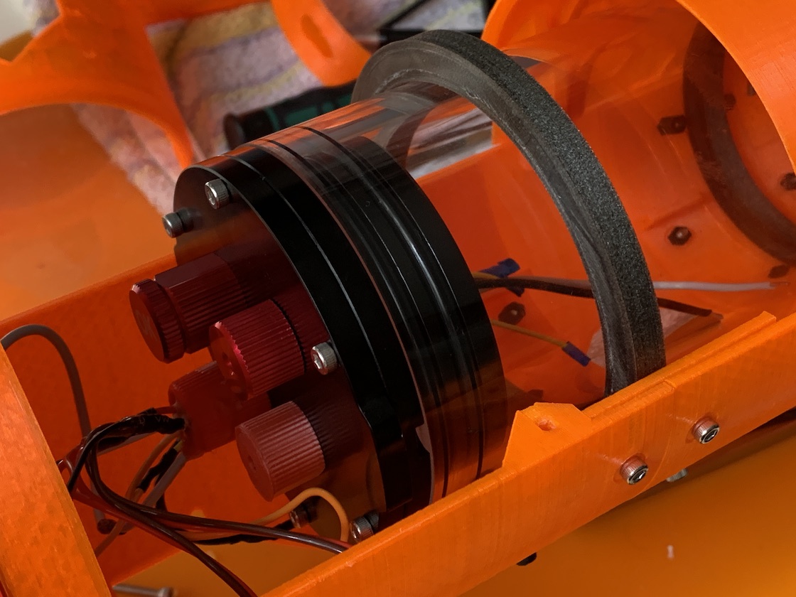

Heres the penetrator with all the wires used to control the servos and the motor.
The penetrator was 3D printed for testing purposes. The penetrator was closed using wax and hot glue.

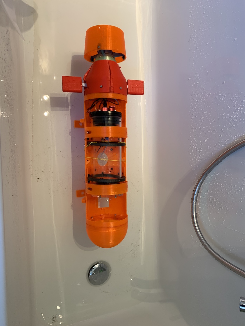

BathTub Test:
There are no major leaks.

You went a little overboard encasing the ESC in epoxy...i just meant, thin it with denatured alcohol so it has the consistency of water, and brush it on...thin...lol.
And those wires going through the penetrators??
I hope you stripped the insulation off of the part of the wire that goes through the penetrator, before you potted it...otherwise water will find a way inside the insulation somewhere, and force it's way along between the insulation and the copper until it's past the penetrator and inside the WTC.
