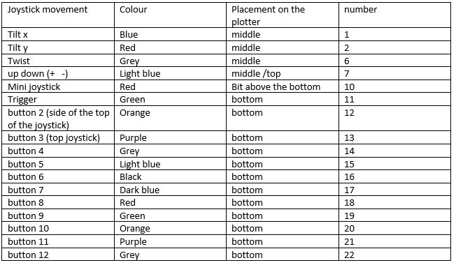

Scanro
Posts: 22
Joined: Aug 15th, 2019, 4:30 am
Re: 6 motors controlled via ethernet with game controller
Post by Scanro »
here is the mapping info I have gathered so far. The number says the position of the affected value in serial monitor (I didn't count that &JOY) and the colour and position tells the position in the serial plotter.
The up down (+ -) on the joystick refers to the small little throttle thing below the logitech branding. The idea for now is to get the up down to control the thrusters that make the ROV go up and down, then the tilt x controlling if it goes forward or backwards, the Y tilt to control side to side movement and then the mix of those two to get it to turn somewhat on the spot.

Bennachie
Posts: 113
Joined: Jul 6th, 2018, 11:38 am
Post by Bennachie »
Ok so x is fore/aft, y is lateral and +- is vertical
Can you confirm directions for me? Normally, the following is true with joysticks-
Forward is x=255
Backward is x=0
Left is y=0
Right is y=255
Up is +-=255
Down is +-=0
Is that correct for your stick?

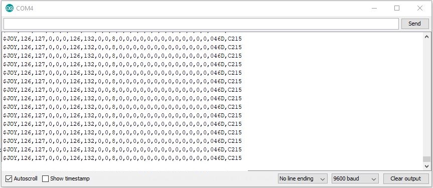

And another thing. Looks like you are using serial port 1 for the stick. You'll need another serial port for the comms between topside & vehicle. I will assume this to be serial port 0, but you can change it.
I've also never written code for two serial ports at the same time, and assume you need to be using 9600 baud for the stick. It might get complicated switching baud rates between the ports so I may try it, or may have everything running at 9600 baud instead. Usually I use 115,200 baud.

Bennachie wrote:Ok so x is fore/aft, y is lateral and +- is vertical
Forward is x=255
Backward is x=0
Left is y=0
Right is y=255
Up is +-=255
Down is +-=0
I can't access my code until next week so it'll be a while before I have a go.
X=0 is forward here
X= 255 is backwards
Y is correct
Down +- = 225
Up +-= 0
Interesting that they have switched this around

Bennachie wrote:And another thing. Looks like you are using serial port 1 for the stick. You'll need another serial port for the comms between topside & vehicle. I will assume this to be serial port 0, but you can change it.
I tried setting it to 115,200 baud, but then it only spits out values for a little over 1.5 lines, so I assumed that it didn't work with such a high rate.
Could be the cable you are using between the various components. The higher the baud rate the better your wiring has to be.
I'll aim for 9600 baud.

Bennachie wrote:
I didn't really think of that, right now we are just using those standard cheap arduino cables in all kinds of colors. We do plan on getting some better wires, but first when we have everything working and wired correctly.
