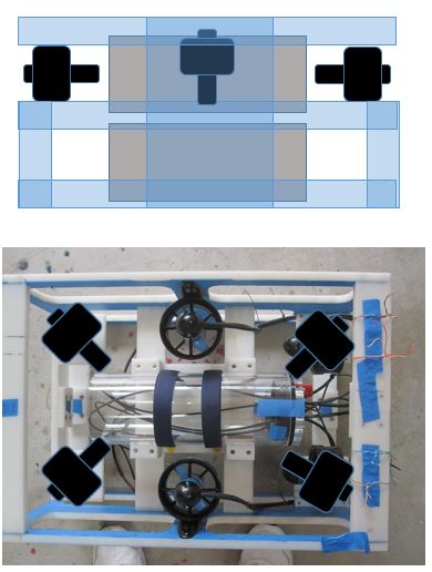

WOW! Very Impressive thread! I see you have been very busy!
I like the direction you are going! I too am playing with a 6 thruster design using the BR T100+BlueEsc and 4" WTC.
I am also struggling with the skeleton/frame of the ROV... It would appear you have a much better grasp of the concept... Below you can see my current concept, slightly modified to fit your design.
Layout Suggestions.JPG (41.04 KiB) Viewed 24721 times
I am looking at only 1 - 4" WTC, which would contain everything but my lights. I am also toying with the idea of 2 - 2" lower tubes to contain my batteries...
Keep up the GREAT posts!

I have been told that I have too much shielding of the Thrusters in the side panels for an effective six Thruster configuration with vectored horizontal Thrusters as you have laid out above.
I thought that I would go with this present configuration and shake any bugs out in the hardware and control system and then move on to the six Thruster configuration which will require a little more complex Thruster control system and firmware.
As I have indicated in my thoughts on the six Thruster configuration I will try to salvage as much of the four Thruster configuration as possible when fabricating the six Thruster configuration.
SSN626B/TCIII
