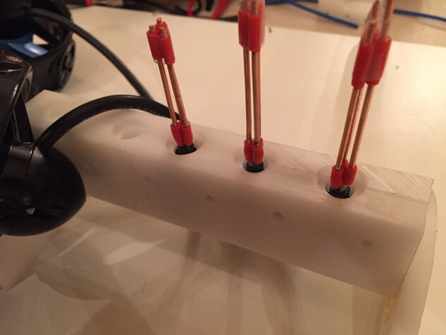

I made a small mold so I can hold the wires straight and in the center of metal body
And fill the metal shells with epoxy after I put it in the oven for a few minutes to make it more runny.

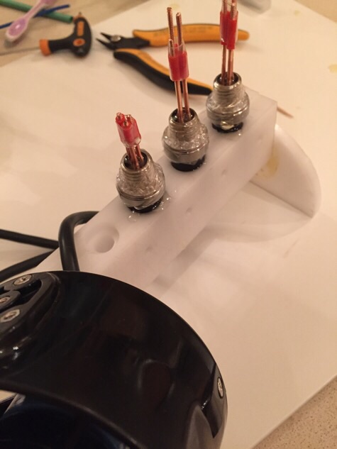

So after a day the epoxy is fully cured and the cable penetrator is almost ready
I made a small mold from derlin so I can encapsule the potted shell with urethane resin
I mixed urethane resin and filled the mild to the top
After a day the urethane is fully cured and the first penetrator is ready. :P
Four more to go.For extra protection I will wrap the molded parts with a shrink sleeve with glue.

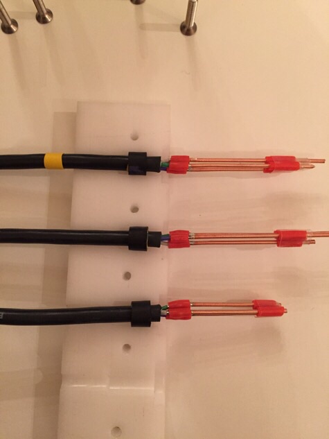

Thank you Steve!Yes the water is leaking if you pot stranded wires.Up to 2 bars was ok,but when I push it harder you could see small drops of water coming out!Only solid wire with a good grip worked for me.
I like the idea from the link below and made a few modifications
http://svseeker.com/files/Thru_Hull_Con ... ota_FL.pdf

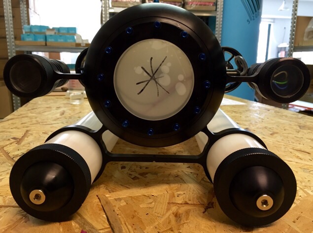

UPDATE
Finally I finished all comectors and receieve all aluminium parts hard anodized .
I assemble all the parts together to check if everything fits ok.
I have to finish a few things before I test it at sea (empty)
