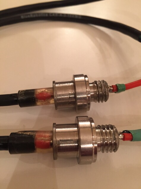

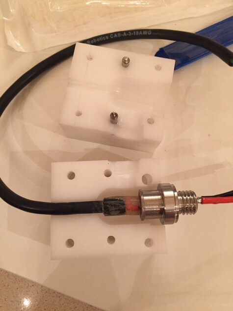

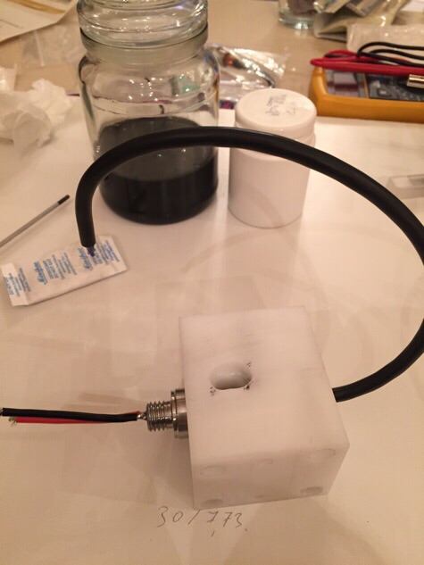

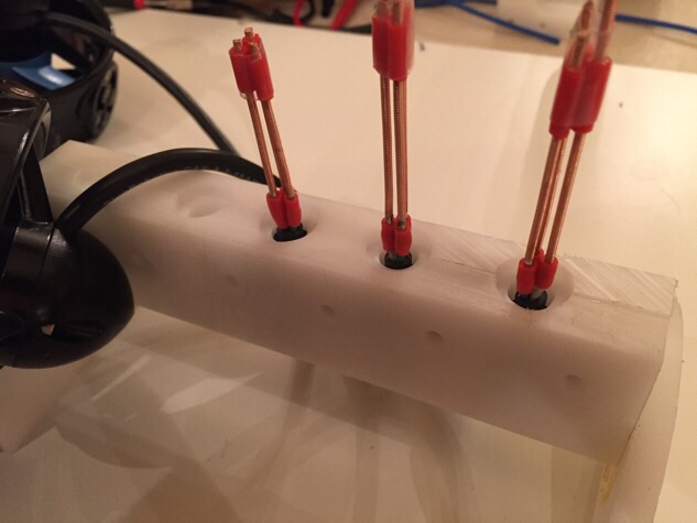

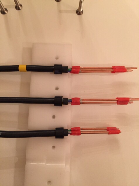

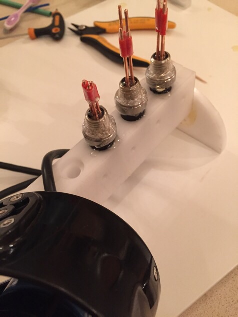

I made a small mold so I can hold the wires straight and in the center of metal body
And fill the metal shells with epoxy after I put it in the oven for a few minutes to make it more runny.

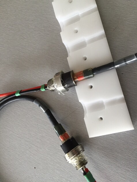

So after a day the epoxy is fully cured and the cable penetrator is almost ready

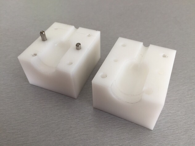

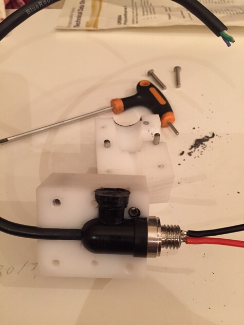

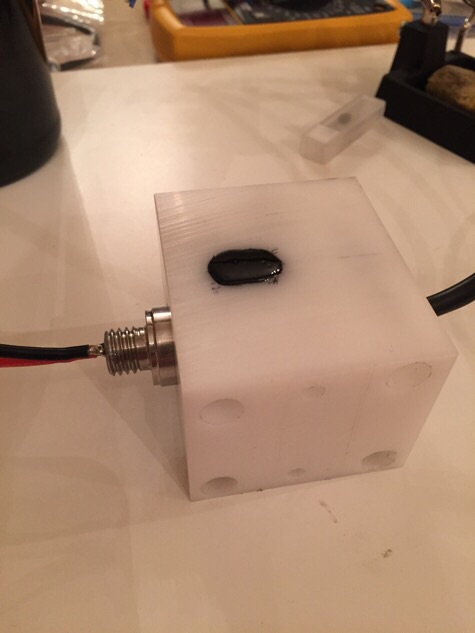

I made a small mold from derlin so I can encapsule the potted shell with urethane resin
I mixed urethane resin and filled the mild to the top
After a day the urethane is fully cured and the first penetrator is ready. :P
Four more to go.For extra protection I will wrap the molded parts with a shrink sleeve with glue.

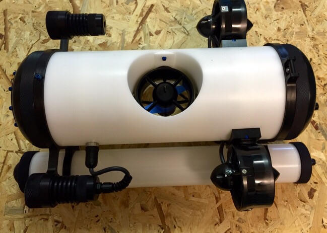

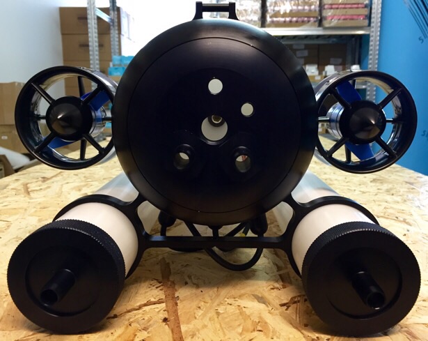

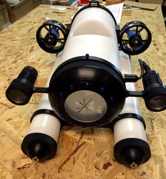

Finally I finished all comectors and receieve all aluminium parts hard anodized .
I assemble all the parts together to check if everything fits ok.
I have to finish a few things before I test it at sea (empty)
olegodo
Posts: 222
Location: Bergen, Norway
Re: DROV-bubbles rov
Post by olegodo »
:o
Posts: 289
Location: New Jersey Shore
Post by a_shorething »
Damn dude!!!! I'll take two of them. :)
That is some serious artwork right there.
