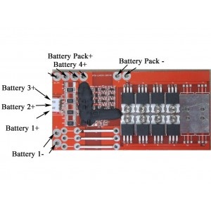

For battery power I decided I would like to build my own LiFePO4 cell so I bought some 4 15 ah cells from BMS battery and I am going to have a go at this I noticed no one else using them so they may not be the best of ideas but I'm in this for the learning curve so I'll try them out
This is the management board
http://www.bmsbattery.com/bmspcm/405-10 ... -case.html
And these are the cells
http://www.bmsbattery.com/lifepo4-cell/ ... -cell.html
- Battery management board
- image.jpg (23.95 KiB) Viewed 8442 times

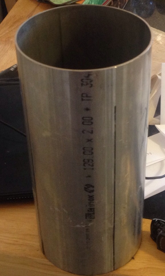

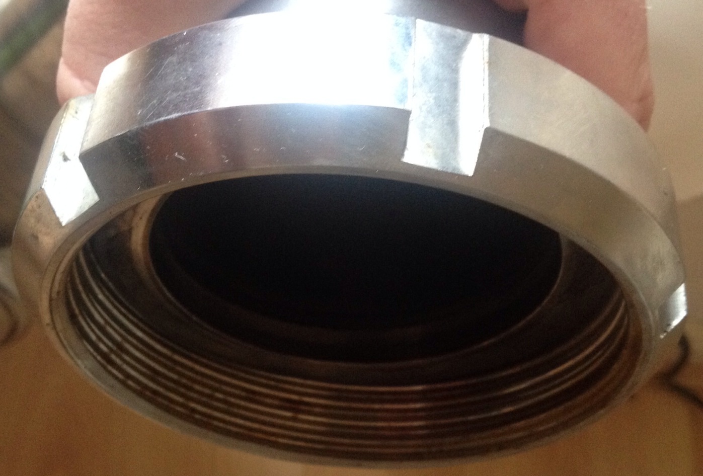

So my idea for the hull I'm sure will not be very popular,
I want to use stainless steel dairy piping
I can have it welded here and could even pressurise the hull with nitrogen or an inert welding gas
To minimise pressure differentials , I like the idea and am having a hull welded as soon as my mate gets a chance
I know it adds a lot of weight, but I'd rather upgrade the thrusters then change the hull I think anyway here's some pics
- Dairy pipe union
- image.jpg (278.55 KiB) Viewed 8442 times
- 5 inch 316 dairy piping
- image.jpg (122.66 KiB) Viewed 8442 times
