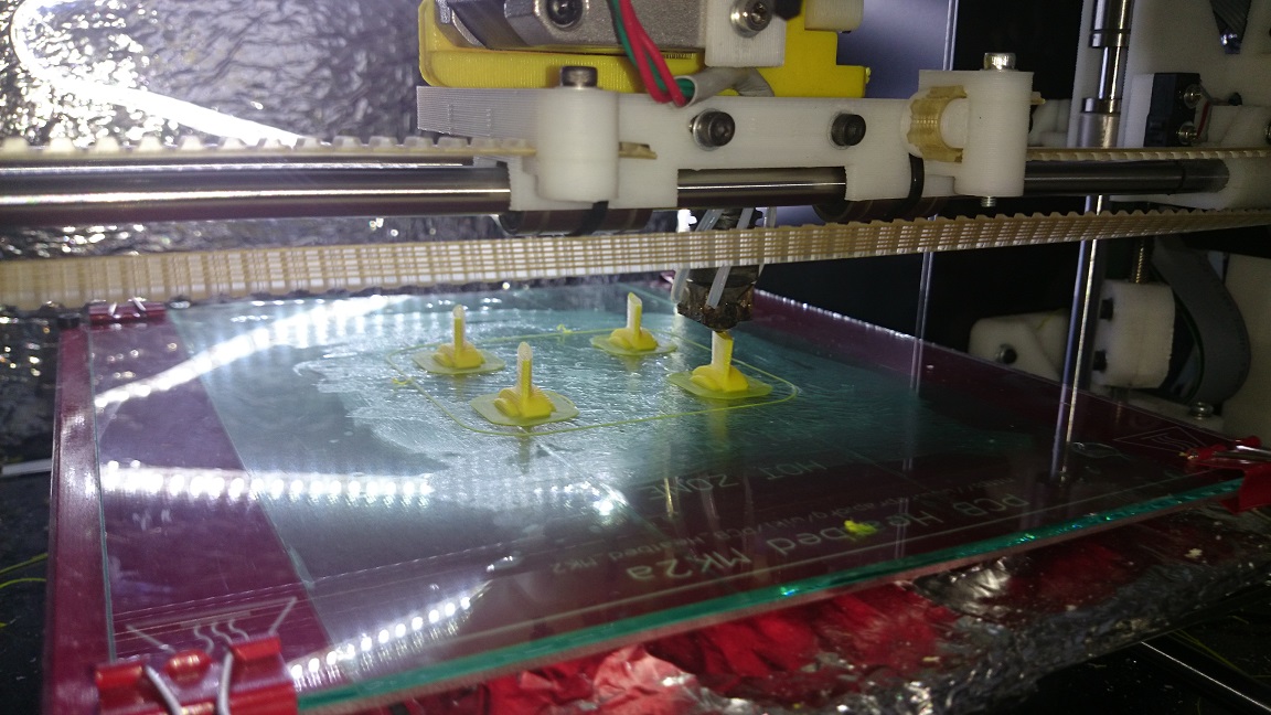

Blades being printed.

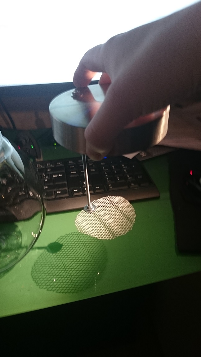

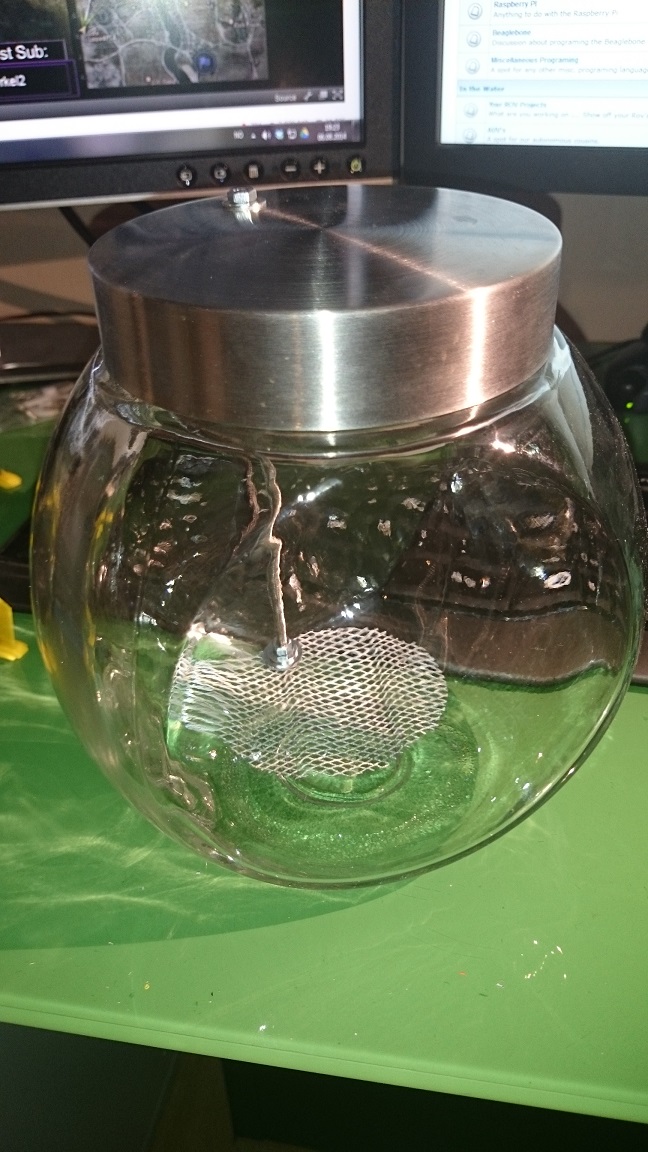

Simple kitchen storage container. Note that I have removed the gasket so that it never gets pressurized. Very important!
2014-08-06 19.23.35.jpg (253.82 KiB) Viewed 4935 times
The platform for the printed parts lifts out with the lid.

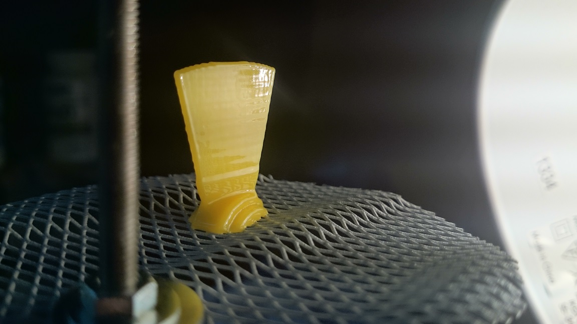

Blade sitting in acetone vapor
2014-08-06 19.45.30.jpg (168.64 KiB) Viewed 4935 times

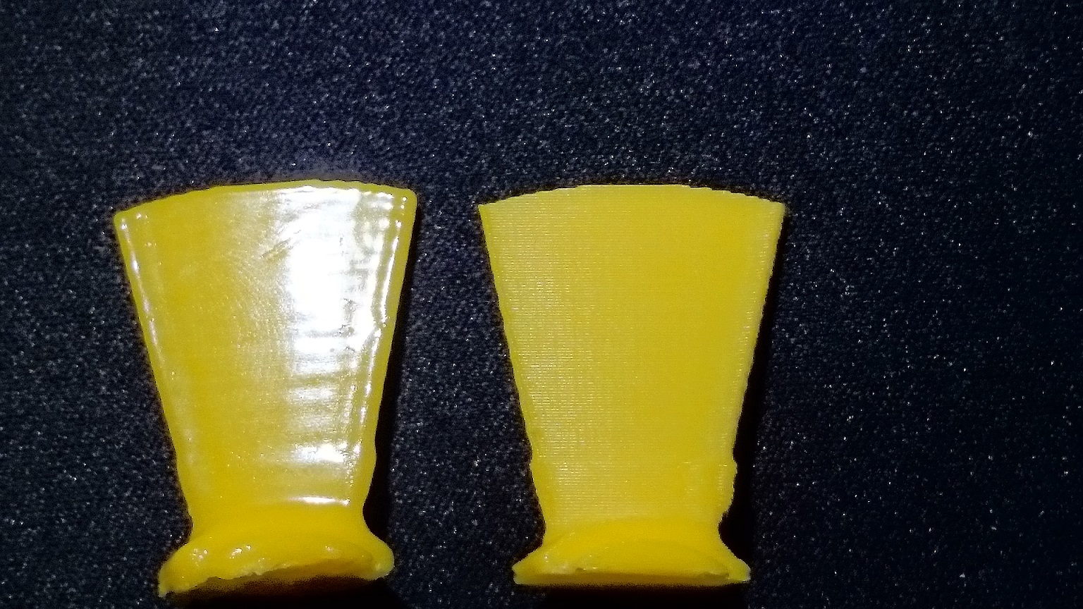

Treated prop blade to the left. Untreated to the right
2014-08-06 22.17.00.jpg (552.27 KiB) Viewed 4935 times
Re: I'm jumping in!
That's a pretty awesome finish, I was reading about that acetone trick and it looks like it works great. I'm going to have to get some ABS and give it a try myself soon. Thanks for posting this....

How long do you leave them in the acetone? I imagine not too long.
olegodo
Posts: 222
Location: Bergen, Norway
Re: I'm jumping in!
Post by olegodo »
Somewhere between 5 and 10 minutes on that piece.
