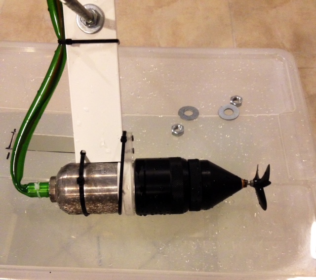

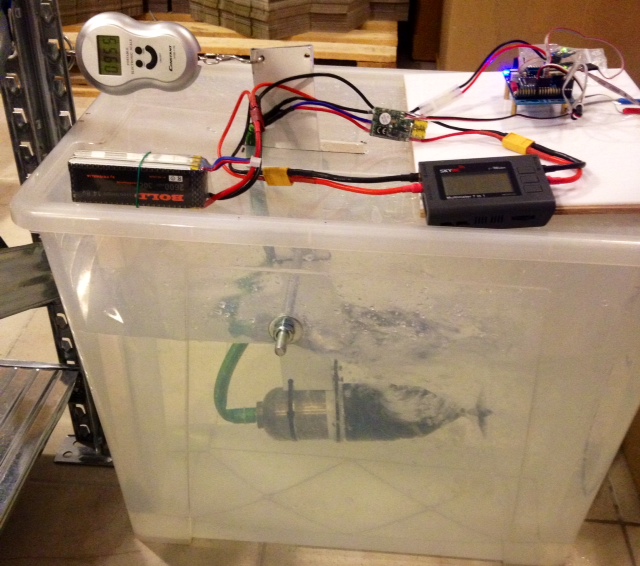

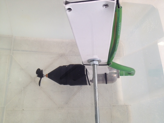

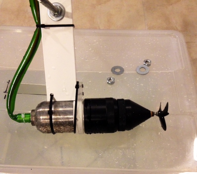

I just finished my first thruster test.
Thruster cylinder :aluminium 6082 t6,magnetic coupling shaft
Motor: Robbe Roxxy 35-29 500 kv navy
ESC: Robbe Roxxy 930-6 (with reverse)
Propeller:Graupner D65 3 blade propeller (2308.65)
Battery:lipo 4s
Test tank:Ikea 60L (too small)
I test forward and reverse at 100% and 50% power.
FORWARD
100% power
THRUST:2.3 kg/5,07 lb
AMBER :8,7a
Watt:139,3
50% power
THRUST: 1 kg/2,20 lb
AMBER :2.5a
Watt:40
REVERSE
100%
THRUST:1.1 kg/2,42 lb
AMBER :7.07a
Watt:117
50% power
THRUST:0.300 kg/0,66 lb
AMBER :1,5a
Watt:21,45
Battery:lipo 4s
FORWARD
100% power
AMBER :8,7a
Watt:139,3
50% power
AMBER :2.5a
Watt:40
REVERSE
100%
AMBER :7.07a
Watt:117
50% power
AMBER :1,5a
Watt:21,45

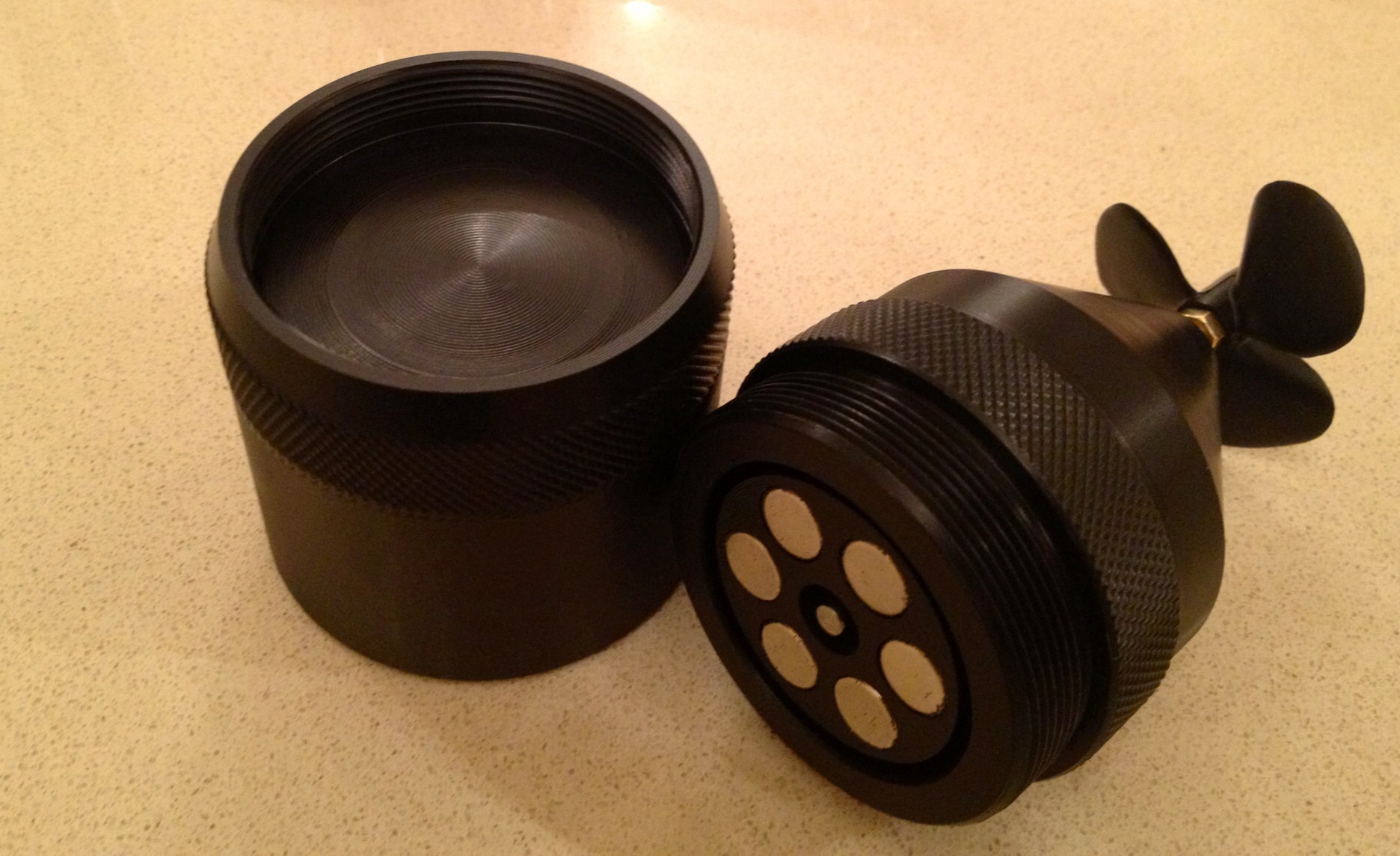

Re: draw, thrust, and components
Sweet setup Bubbles, can you tell us more about your housing and shaft seal? Looks like a professional thruster!

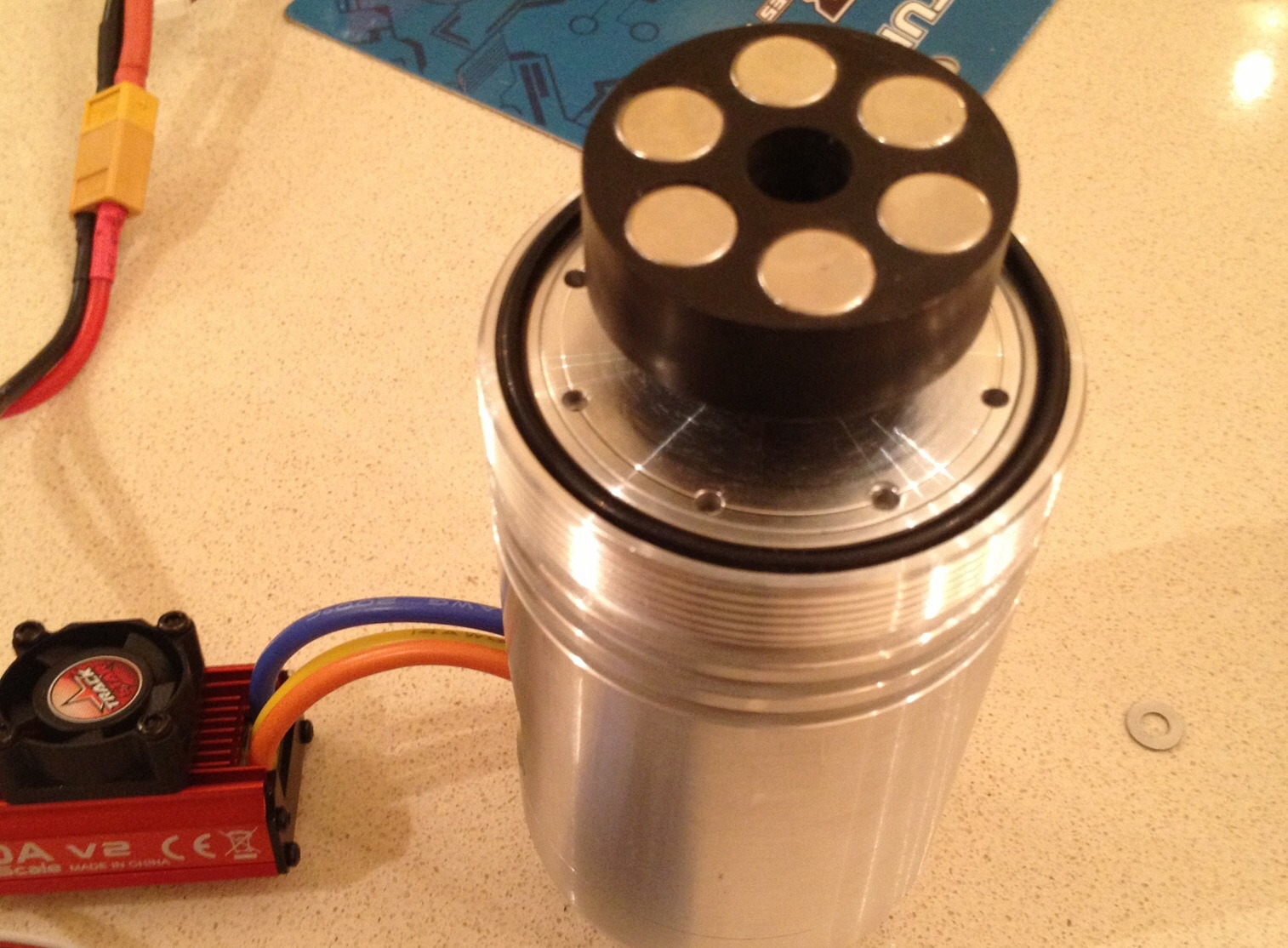

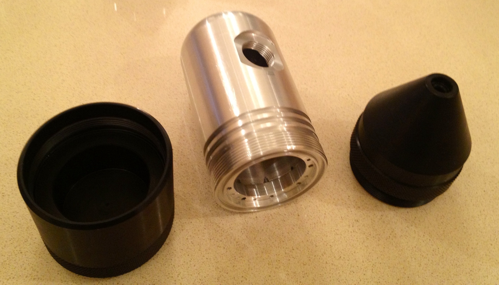

Thank you Tigershark.The thruster housing is a combination of aluminium 6082 t6 and acetal.
Housing diameter is 60mm and the wall thickness is 7mm.Total lenght is 23 cm and the total weight of each thruster is 850gr.The shaft has two bearings and I made the magnetic couplings with 6 neodymium magnets on each side .The thickness of separation plate between magnetic couplings is 5mm.I use two orings between aluminium and acetal.
