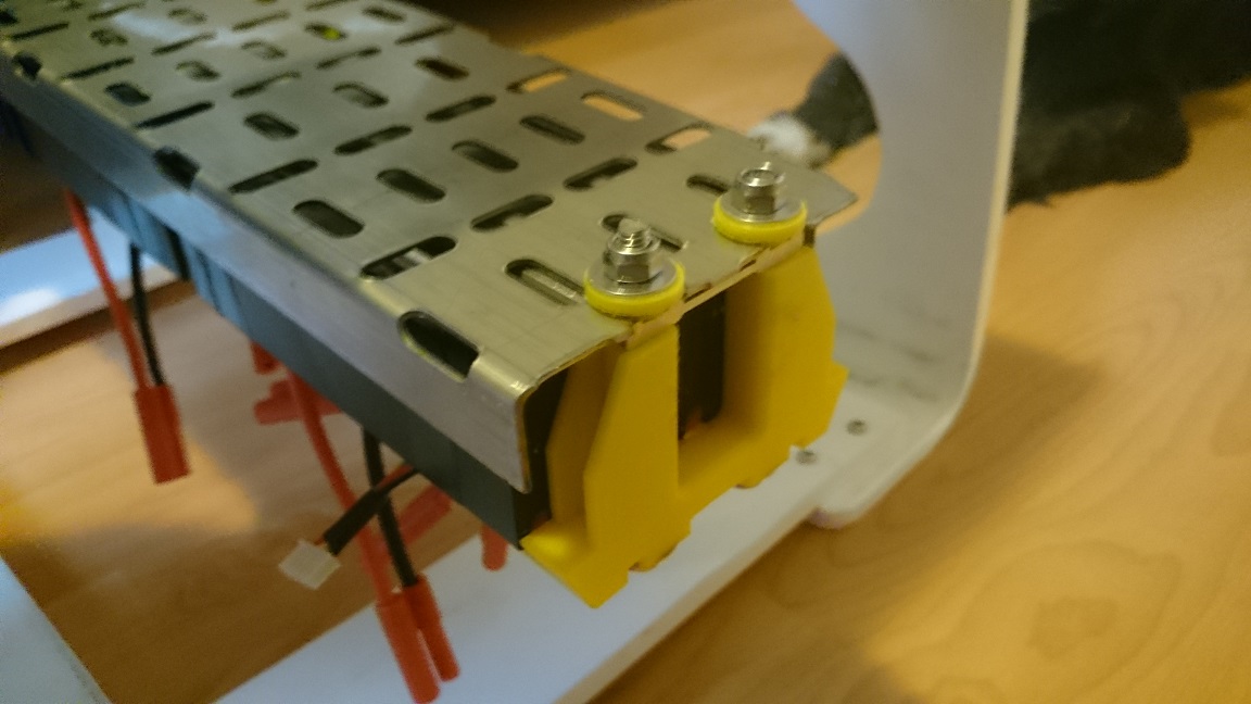

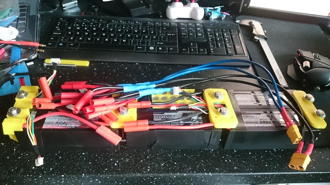

Battery is coming together... It's a little "hackish" but hard to make it pretty with the very limited space inside the WTC aka filter housing.
6 x 5000mah 4s lipos in parallel.
Have mounted them to an aluminum backbone/rail and made wiring harnesses to connect them all together.
I have made it so that the battery slides on to the frame inside the housing on my ROV.
Just align it from the back and slide it forwards so that it slots in to place. Stays perfectly secure.
I didn't want to remove the original connectors from the batteries so i kept them on.
The harness has HXT connectors in one end for the batteries and two XT90 connectors in the ROV end. One for positive only and one for negative. These should give plenty of headroom when it comes to amp draw.
I now need to secure all the wires to the batteries and clean it up in the end.

Frame inside the rov. Battery will be mounted underneath. All electronics on top.
Battery front
Battery front
Battery back
Battery back
Battery mounting slots in the back of the ROV.

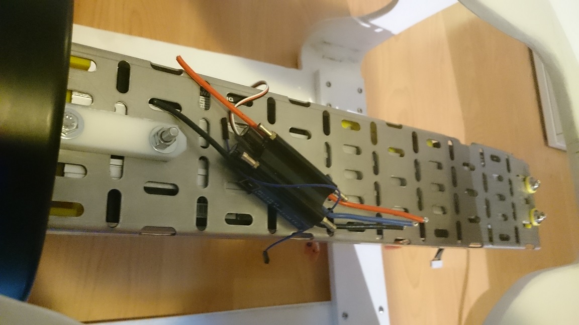

Battery mounted. One of six 50A ESC's on top of the frame.

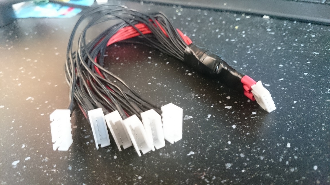

Balancing harness
Balancing harness
