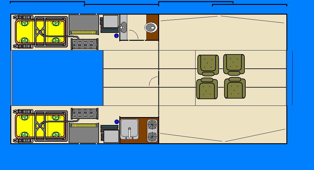

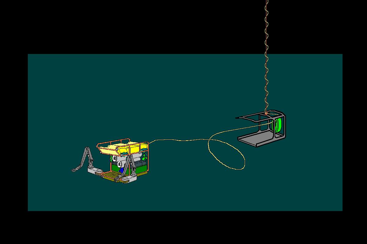

Yeah, my boat will be a custom-built 28' pontoon boat, two rows of plastic 55gal drums down each side, boat expandable sideways to 14', cabin roof raises/lowers to make the boat 7' tall on the road to 11' tall (8' ceiling) on the water, small kitchenette and bathroom, 14' square control room with 2 720p projection monitors, 14'x10' moon pool room. Moon pool will be 6.5'x8', with overhead double gantry cranes for lowering the 2 ROV's into the water, also for heavy object retrieval.
Of course i'll be hacking it together myself, like i do everything.
- Pontoon Boat Layout.JPG (60.89 KiB) Viewed 34448 times
- Tether Managment System.JPG (37.98 KiB) Viewed 34448 times
