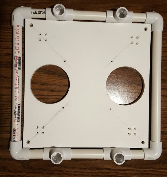

1. I've designed a skeleton base for my ROV. I will be mounting my 4" WTC and 6 BR thrusters to this.

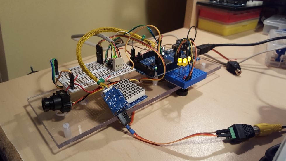

2. I've designed a basic chassis to mount electronics to inside my 4" WTC and started populating it with components. This really helped clean up the work space and condense the Subside electronics.

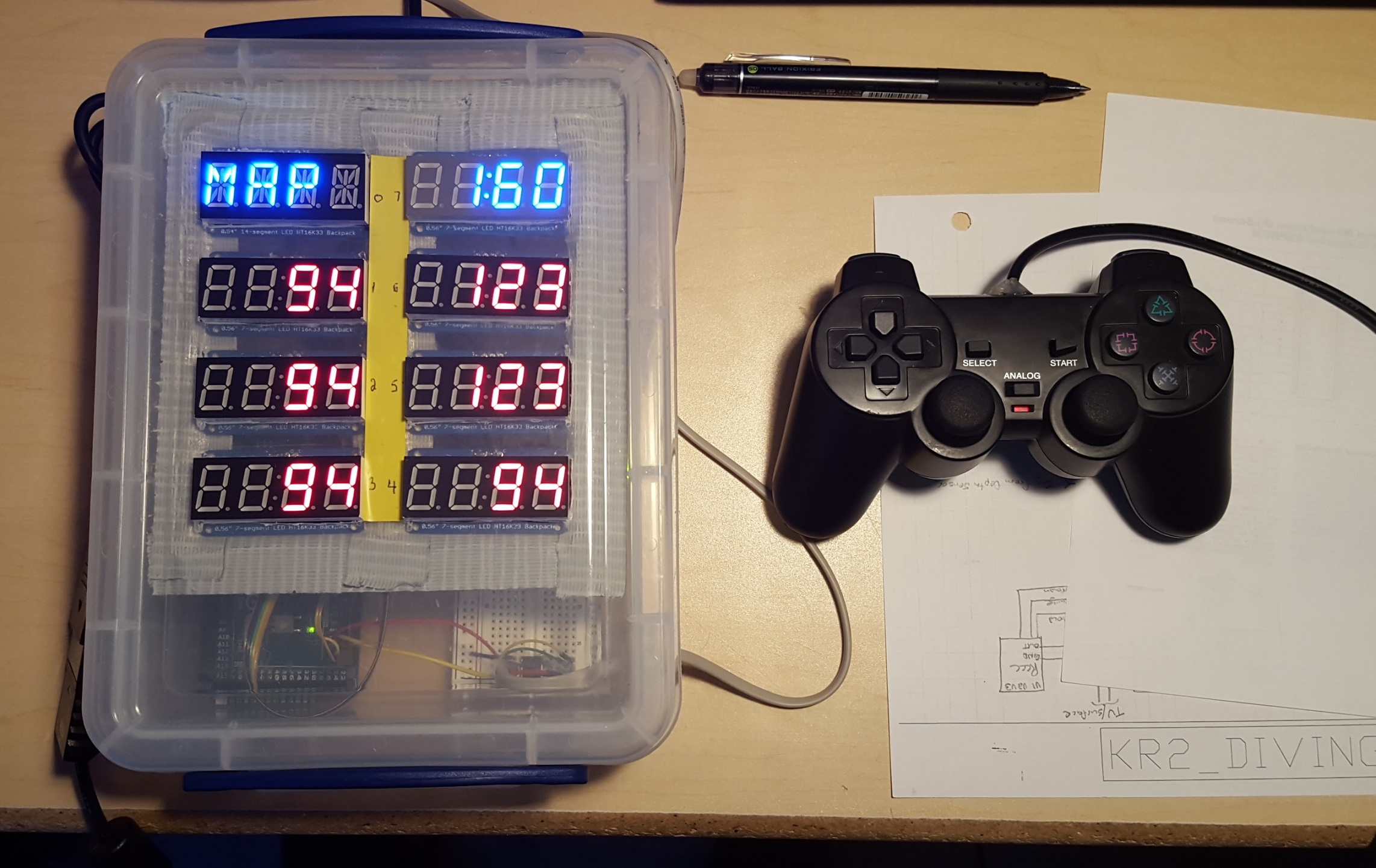

3. I've mocked up a TopSide control station, containing the topside Arduino and Qty 8 7-seg displays for monitoring things while diving. Currently, displays Thruster values, raw data from PS2 controller and LED brightness and state. Also cleaned up work space a bit more!

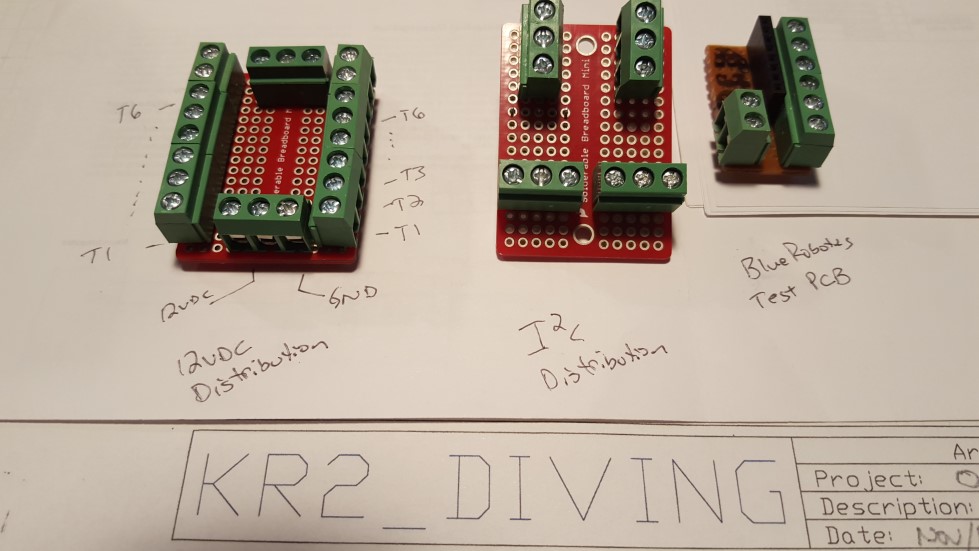

4. I put together some distribution PCBs for the Thruster Power and coms... not sure I will go with this design in the final ROV, but i think it will work... hoping to test soon!

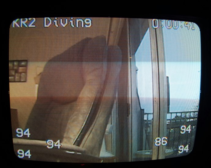

I have run into what may be a bigger problem later on as I add in my Subside sensor packages. It seems between the EasyTransfer library and OSD refresh/print lag, it loose about 50ms per scan on the arduino... not sure this is an issue yet... but I am afraid it might be... even Bindo noticed this.
Bindo wrote:you must have a small-ish set of delays in your code? (approx 100ms?) looking at the way it counts?
To overcome this for the moment, I have added a toggle that turns the OSD on and OFF... but I am hoping to find a more efficient fix without loosing functionality.
Anyone who has played with the EasyTransfer Library... have you found a good and STABLE way to eliminate the 10ms delay in the loop on the data receive function?

Alternatively, anyone have any suggestions on how to speed up the OCD refreshing?

Here is what the display looks like IRL at the moment.

Ok... Bit more progress! I was getting antsy and wanted to mock out the frame to see how how the thrusters and WTC come together!
All in all... I can say am quite happy with how it is coming together! 8-) :D

Re: KR2 ROV
Posted: Feb 21st, 2016, 7:39 am
by olegodo
Don't you need to turn the horisontal thrusters 90 degrees?
The way they are now your rov will not be able to turn arround its own axis. :)
Re: KR2 ROV
Posted: Feb 21st, 2016, 9:55 am
by KR2_Diving
olegodo wrote:Don't you need to turn the horisontal thrusters 90 degrees?
You are SO right! :oops: I knew something was looking off last night when I threw that all together!
