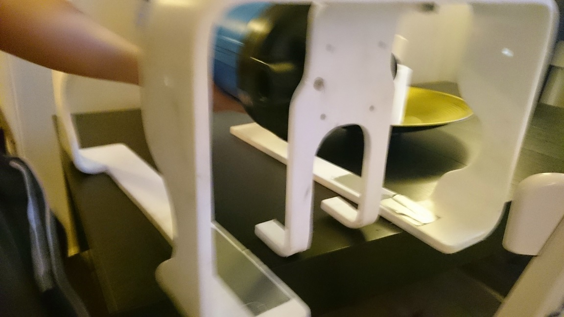

Progress day!
I made the new frame and camera housing today. I were planning on using the water filter as a camera housing, but that thing was just to bulky.

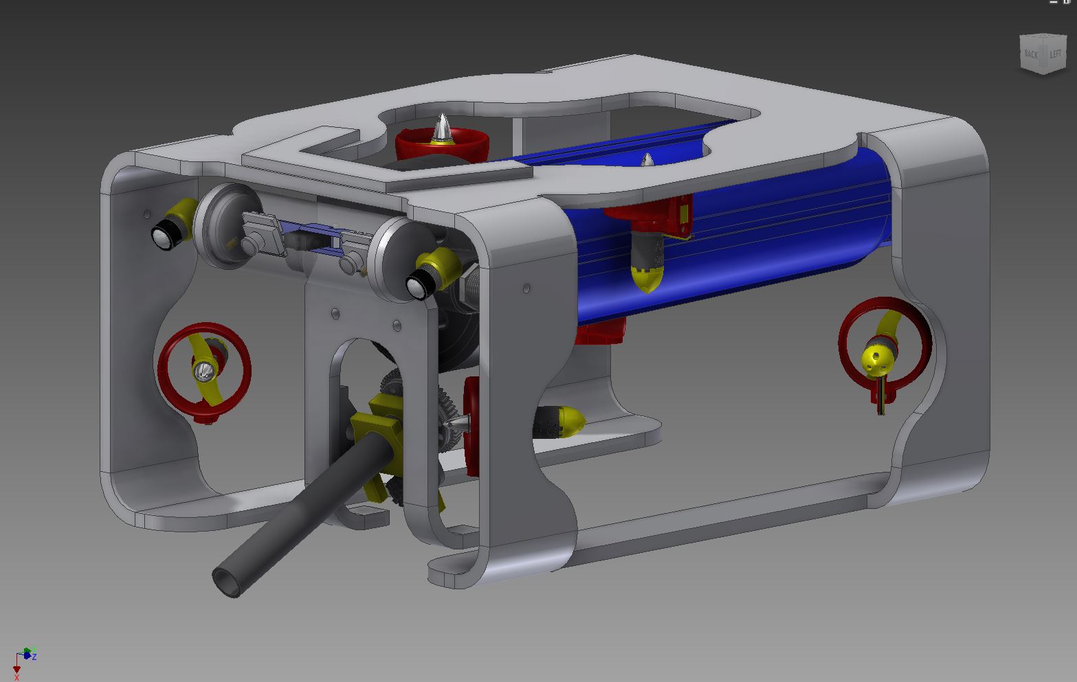

This is what I am working on now. Just so you get a general idea of how the layout will hopefully be.

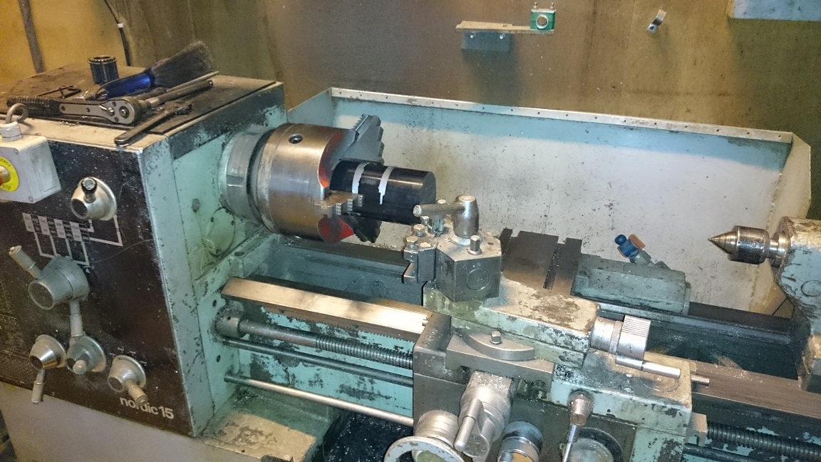

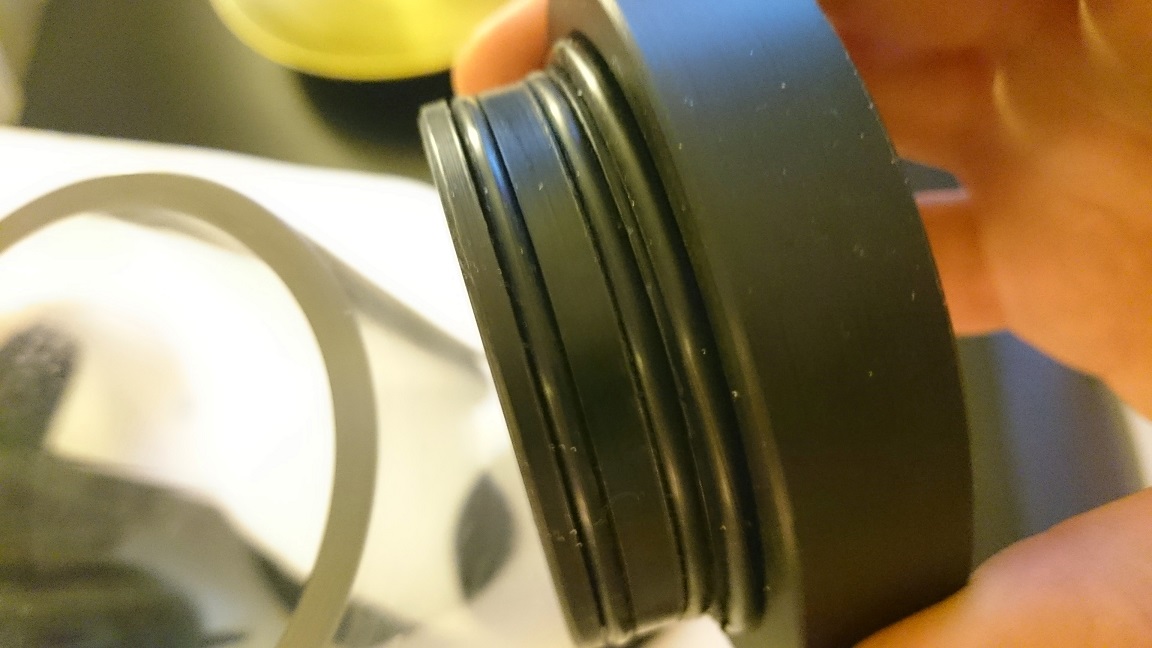

I used an old and tired lathe at work to turn down a lexan tube and end caps for it. The tube diameter is 70mm outside, 60mm inside and 200mm long.
The ends are made from black POM (Delrin). Machined to take 3 o-rings.

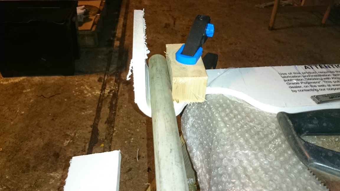

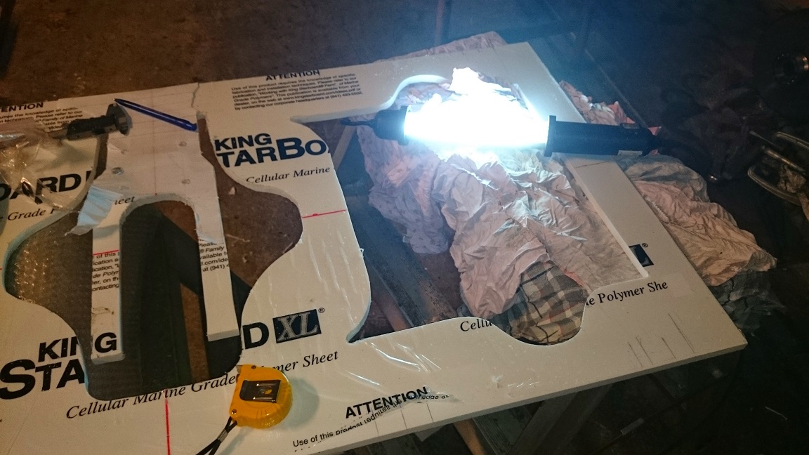

The frame itself is made from one 1220mm x 610 x 12.7mm King Starboard plate XL plate. This XL version is actually a celular polymer plate. So this might have problems at depth/pressure. This was the only thing they had in the store and it was considerably cheaper then buying a solid POM or similar plate in the same size. I think it will be ok, but we will see :P

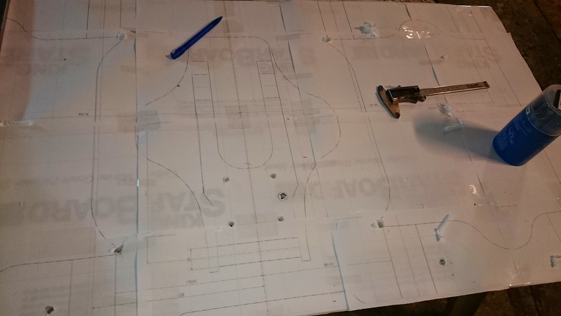

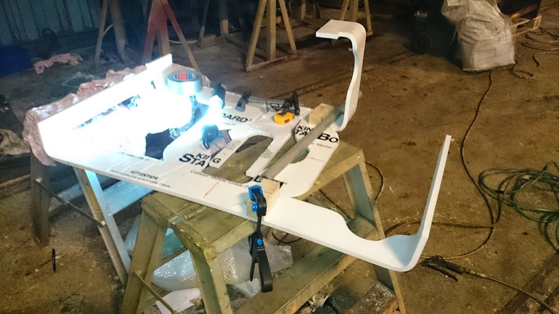

I made a drawing in Inventor of the frame and printed it out so that its shown as unfolded. Took 20xA4 sheets. I then taped them together and stuck them on the sheet of plastic.
This gave me clear lines where to drill, cut and bend.

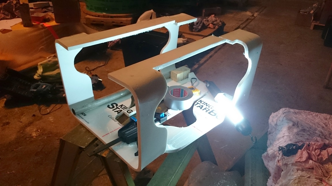

I then used a heat gun to heat the plastic and bend it over a 30mm steel pipe.
olegodo
Posts: 222
Location: Bergen, Norway
Re: I'm jumping in!
Post by olegodo »

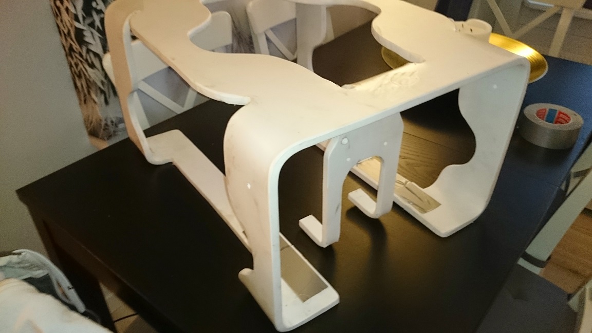

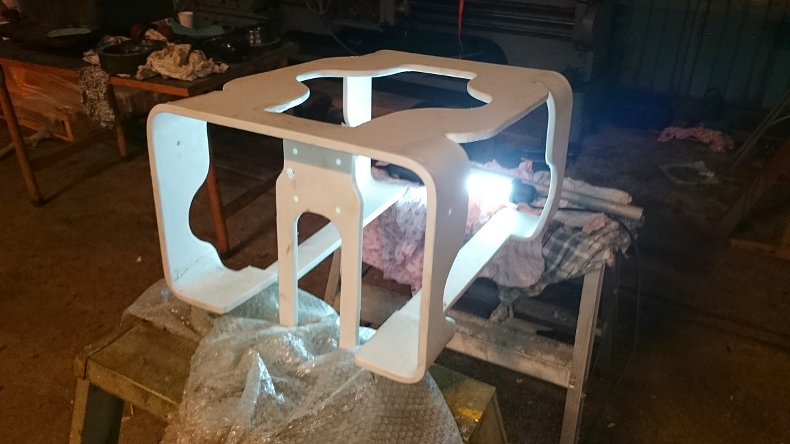

Finished frame. There is still a bottom frame missing. This will help align everything and correct the angles. Considering its done with a hacksaw and other hand tools I think it came out good. Needs cleaning!

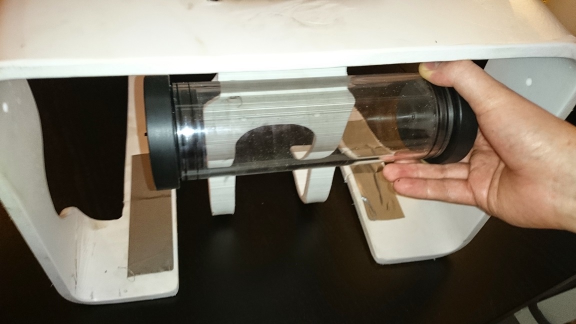

Camera housing.

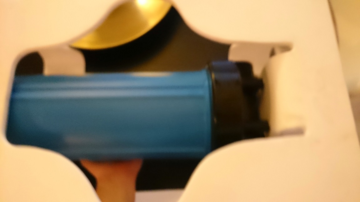

Where the WTC (big filterhousing with all electronics and batteries) will be mounted.
