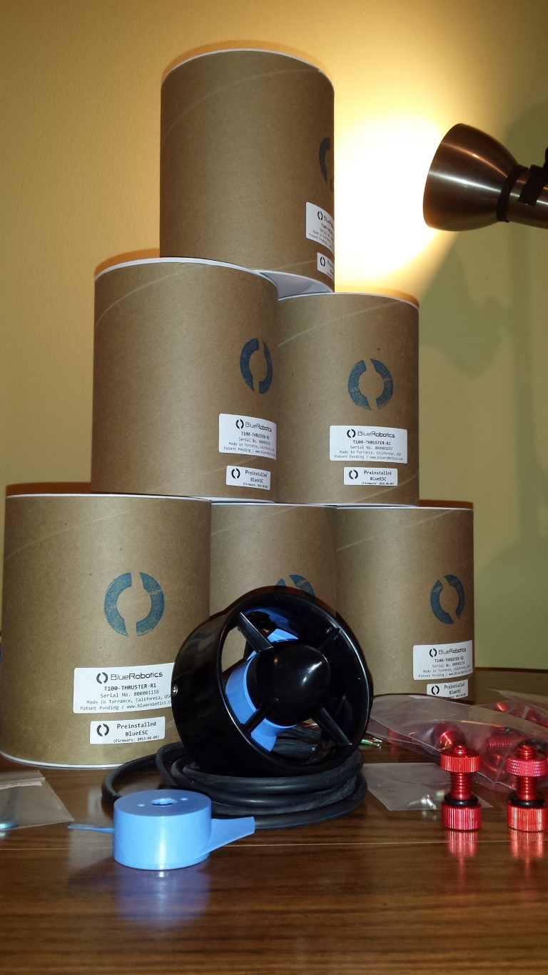

My shipment from BlueRobotics arrived today!
First impressions:
These thrusters are pretty solid! Feel a lot heavier and solid in the hand then I was expecting! Cables all appear very sound, and the build quality is GREAT! It is a shame it is going to be such a crazy week, or I would have these guys up and running already!
Rest assured, any free time I have will be spend getting these up and running! Watch this post for updates!

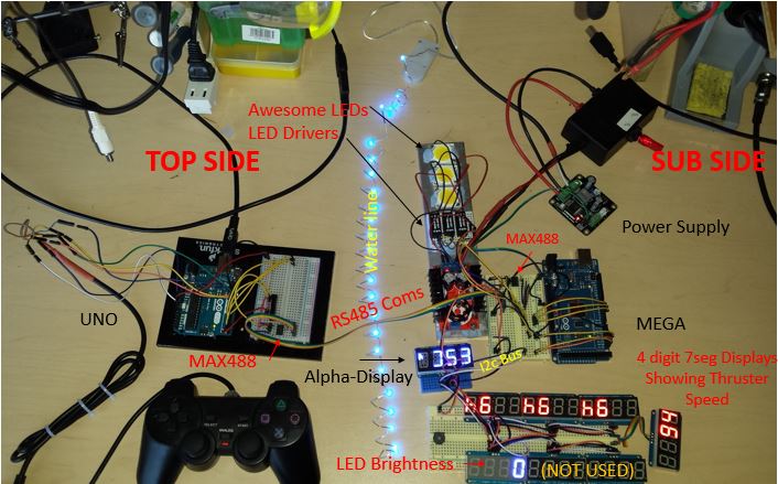

Status Update!
So... I have been so excited to get my BlueRobotics T100's up and running... that I haven't even touched them yet... sad... I know...
But I have had some time to tinker with some other stuff.
Today I got my Easytransfer Library back up and running, and tested. I wanted to make sure I understood the i2c Bus and EasyTransfer before I tackled the challenge of flashing all the firmware on the T100s to change addresses...
Anyway, you can see below the current layout of the system.
Layout
Layout
ROV system Layout Sept 2015 labled.jpg (77.09 KiB) Viewed 16472 times
All of the 7-seg displays are are the same i2c bus. I am using the LCD Backpacks from Adafruit.
Here is a link to the video of it all in action! Warning: the LED's get BRIGHT!
The Left and Right Sticks control the thrusters, the Left Pad UP/DOWN control the brightness of the LEDs, Start Turns them on, Select turns them off. The colon on the BLUE display will turn on when the LEDs are on.
All seems in order, so now I think I can tackle the T100's!

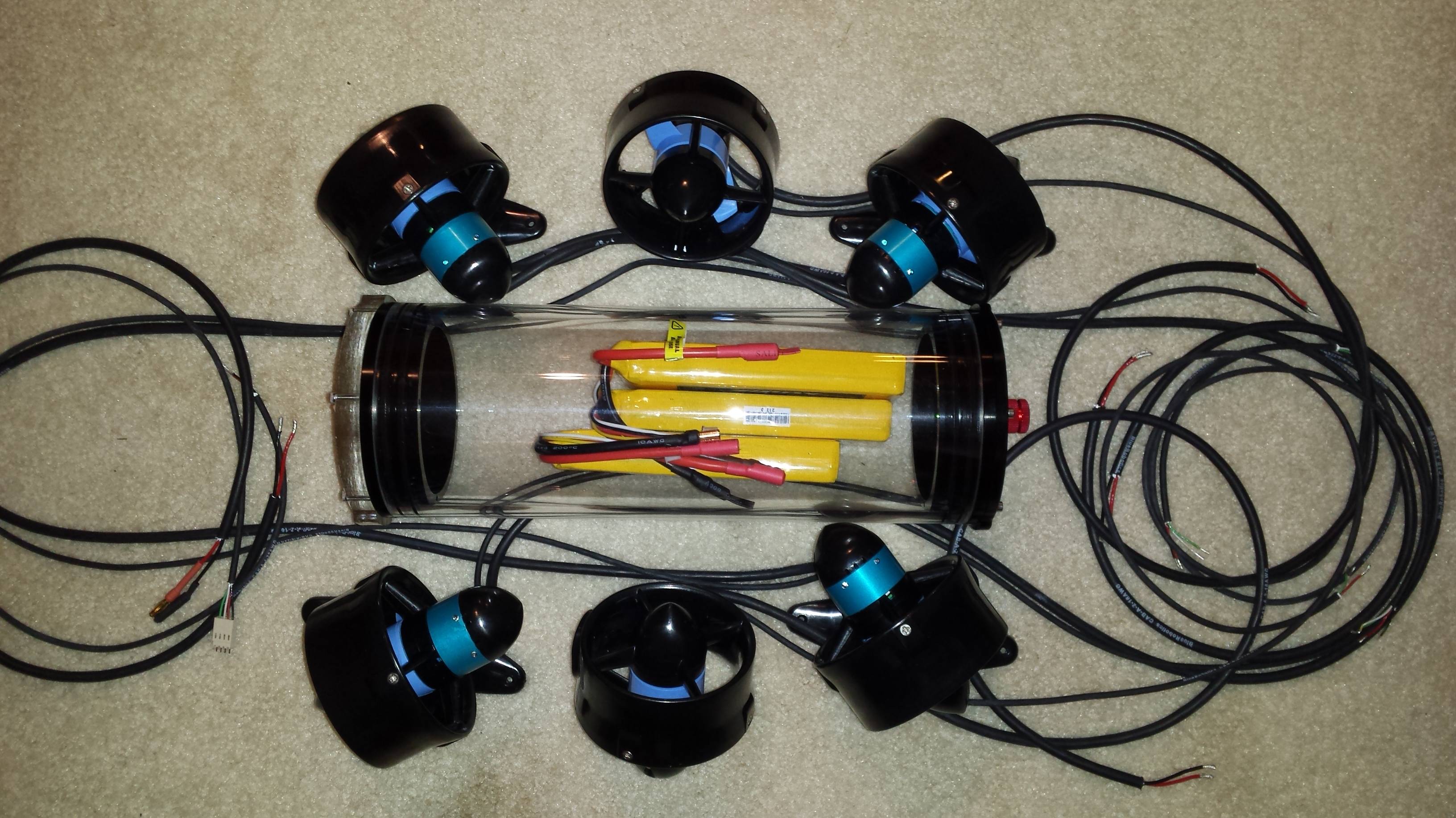

Had a few minutes this evening to finally unpack my T100's and 4"hull to see how things laid out.
Starting to get the picture!
ROV Layout.jpg (632.84 KiB) Viewed 16366 times
The creative juices are flowing... Hoping to gain some momentum on the build and move Version 1 from the drawing board to the diving board!
