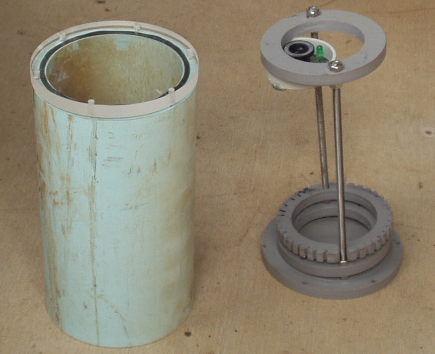

Pressure hull number 5: Numbers 1 and 2 were 90mm downpipe and worked well for the intended purpose despite having flat washer seals rather than O-rings, but too small in diameter for practical installation of any more gear. Number 3 was 100mm sewer pipe with appendages :shock: , to be used on the yellow coffee table shaped ROV and later an elliptical cross sectioned streamlined ROV, then I decided to go circular instead of elliptical :? and that pressure hull would have been too wide. Coffee table and most of hull went to the ROV archive. Number 4 was of 100mm sewer pipe - so fitted inside the streamlined housing - but I found cracks in the end caps going right across the O-ring grooves and visible both sides of cap (2 caps). May not have leaked but not worth risking the work involved in finishing the wiring penetrations etc. These caps have 3 spanner points on the end face. So finally decided to try cutting some O-ring grooves in 100mm mains pressure-pipe, and make my own caps from PVC sheet and clear acrylic. Only just enough wall thickness to accomodate the groove and the flange screws. O-ring is from the sewer-pipe cap, and a bit big. Will be interesting to get it to stay put once greased.
