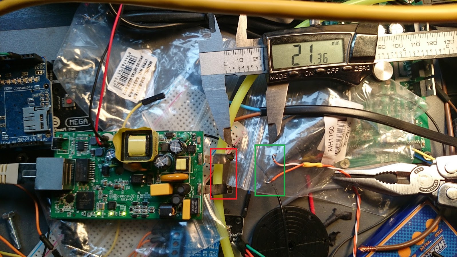

- Funny think. Even with the end of my test tether over 20mm from the contact points on the TP-link adapter I still got a stable 30Mbit connection.
(Red square shows contact points on TP-link adapter, Red square shows my test tether.
This could mabe be used as a tether solution that does not require bulkheads of any kind. - DSC_0145.JPG (503.66 KiB) Viewed 23950 times

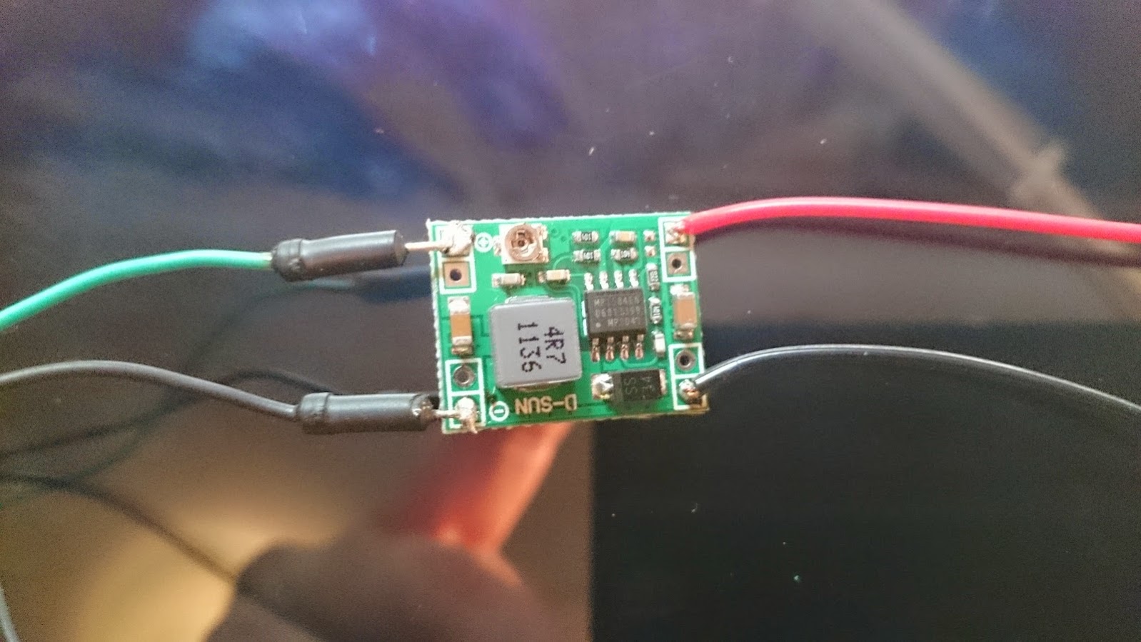

- Simple voltage regulator that will be used to power the bottom side Tp-link adapter.
- DSC_0142.JPG (202.01 KiB) Viewed 23950 times

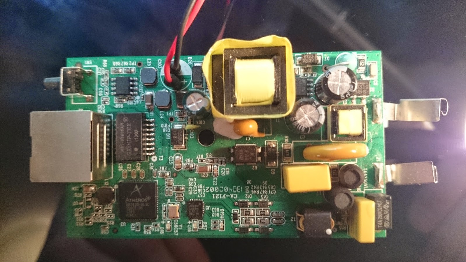

- Shows my adapter. A little hard to get a really good picture.
The adapters I am using is TP-Link TL-PA411
All I have done to it this far is to remove the capasitor that was located where you now can see the 12v power leads come in (black and red.
To the right on the adapter is where the 230v AC is supposed to come in. This is where my tether wil be connected using some kind of quick disconnect plug. - DSC_0138.JPG (269.04 KiB) Viewed 23950 times

Thanks for the photos. Your board uses the same chip as mine the AR7420. During my search for information I came across a few hack messages and the antenna function of the cable which made it an easy hack. Looking at your first picture and the gap, I have to agree. Not that I worry about it with a ROV.

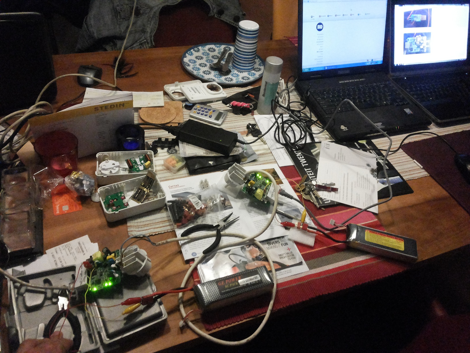

In general the easy route would be that each user who succesful demoblishes a unit and gets the network working should post a picture and a desciption of the components on the board. That way other users can buy units and follow there lead.
So here is my succes picture: The left pc is using the powerline network. I ran a speedtest over it and that was running the same speed as on a direct connection. Oke the details, I removed the capasitor and injected 12V there. That is all.

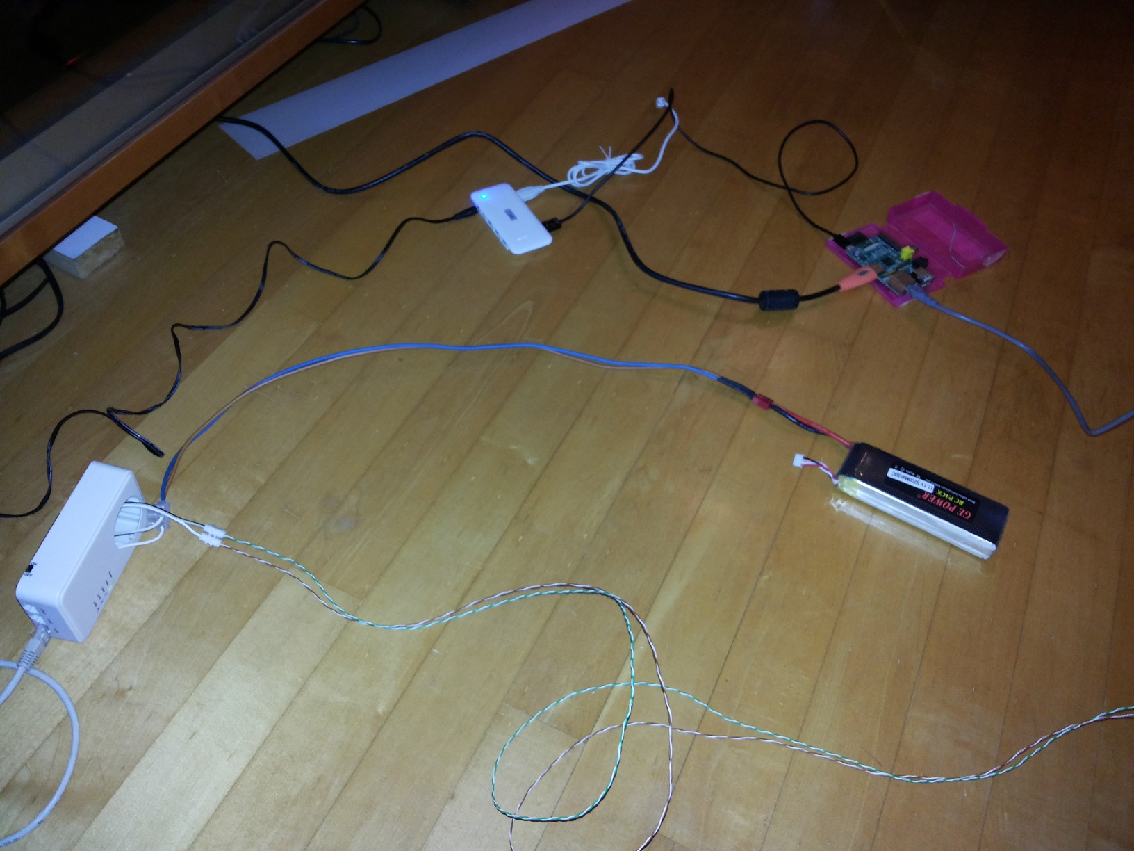

Oke I can around to some testing this evening. Had some troubles with soldering the power connections to the boards. Not my best work and never will be my strong part.
So I have my laptop now connected through two strands from a UTP cable about 1.5meter long. And have my raspberry PI connected together with the laptop and did a test run with ping about 5 minutes without a single packetloss. From my laptop I have a ssh connection with X forward running also and it forwards my USB camera without a problem, same framerate as before. Even watching RV Seekers youtube movies about his great build at 420P was no problem.
Just for the fun some pictures:
screen cap from usb camera connected to PI. The floor without the camera present. the table with laptop and one unit powered through a lipo. oke now the next part of the project.
