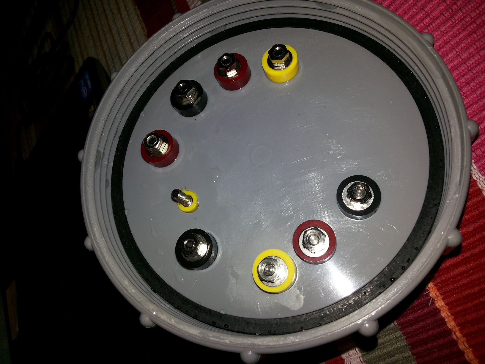

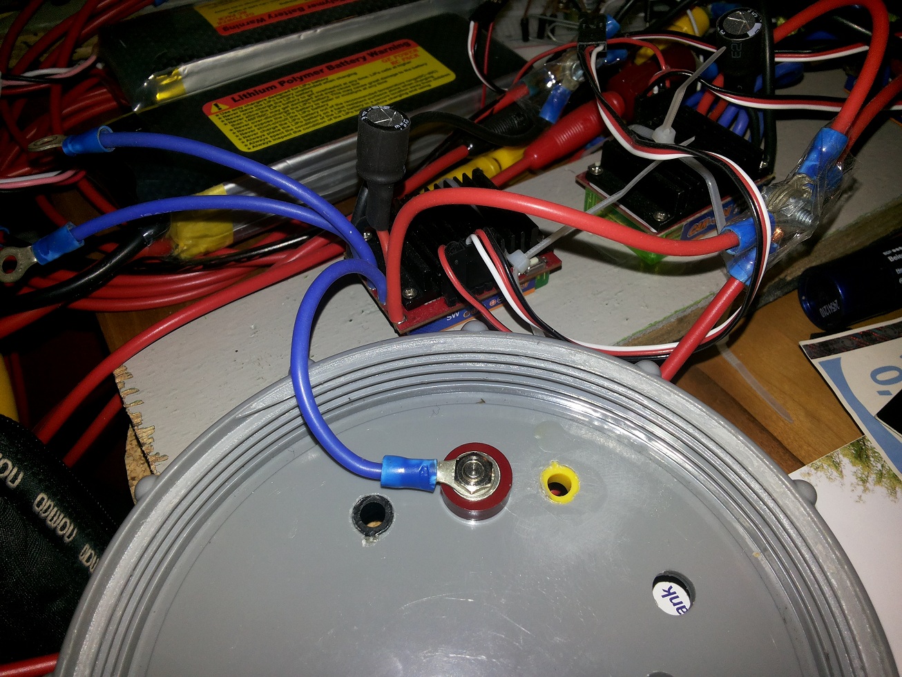

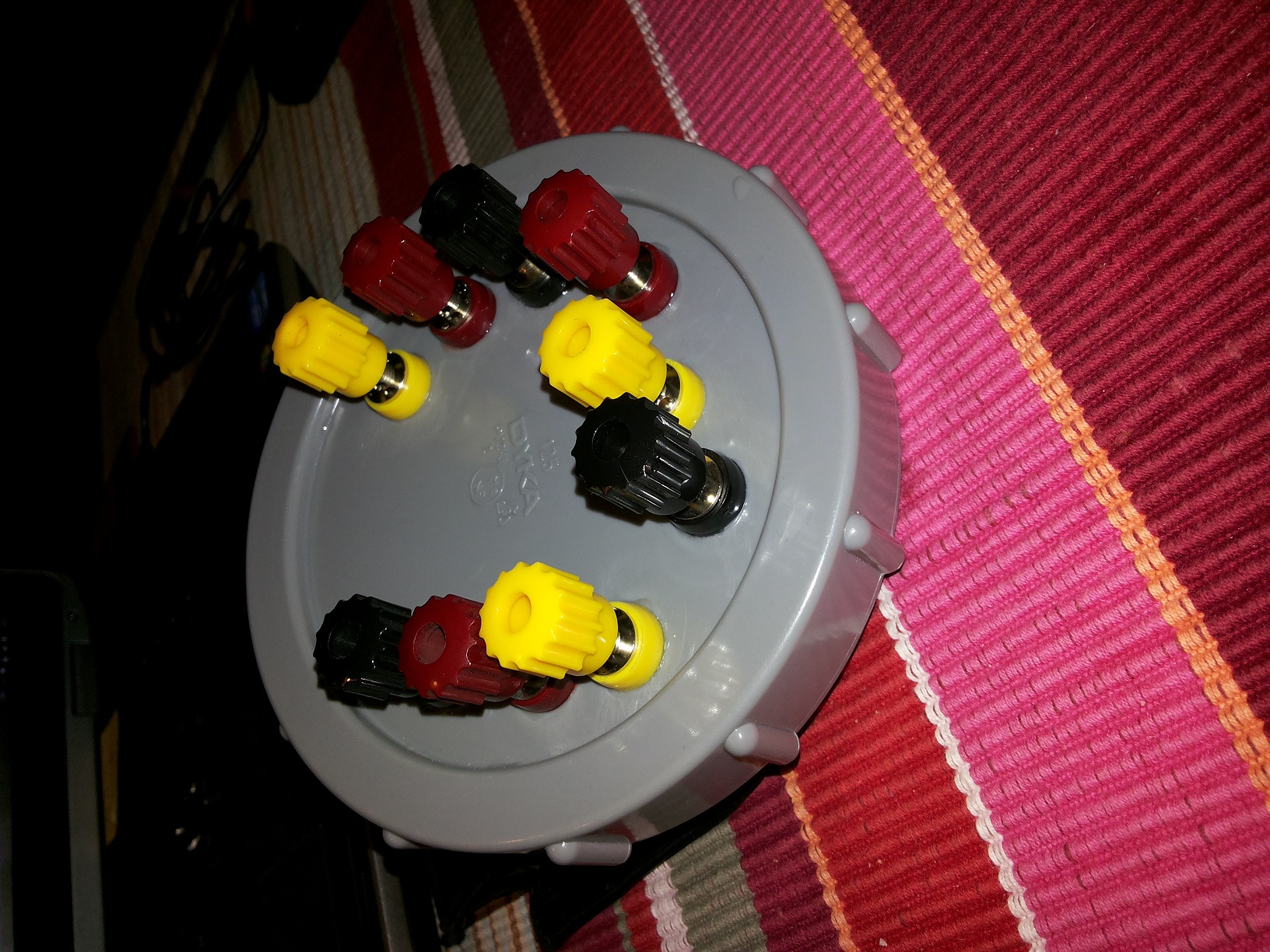

Finaly making something again. The connections to the outside world through the hull. I bougth some car cable connectors which should be able to handle the amps of the motors.
This is located at the back of the ROV.
Three holes per motor, seen from the outside.
The inside with for the photo a connection to an esc.

Finally making some progress again.
Halfway now with the backside of the ROV. Still have to pour some resin in it to really seal it off. Did a quick waterproof test and it lived up to expectations, leaks everywhere :)
Want to pour some on the inside to coat all the connectors and then add rubber seals to prevent water from entering.
Outside view
Outside view
Inside view where resin should be also.

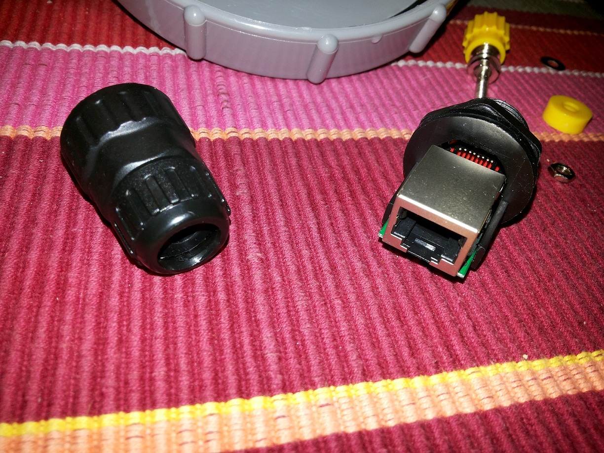

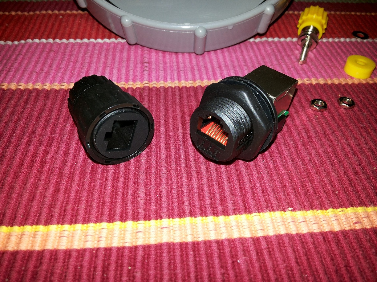

The only connector missing is now a UTP cable connector. I have found one that is ip67 so nowhere waterproof enough. But the concept is easy lots of rubber on the outside allready and resin on the inside should fix it.
Re: Dutch Rov.
The UTP connector

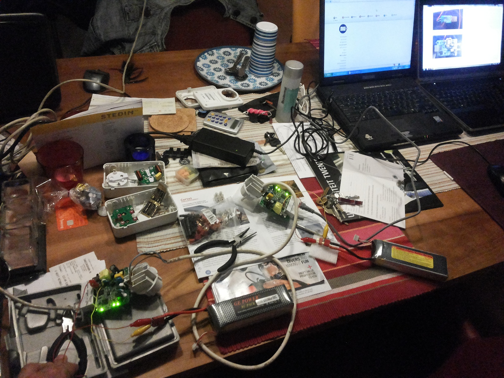

Since I got my powerline connectors working I do not need the UTP connector anymore. At least that is what I hope. See the topic in the tether section about this. Just for the record the picture of the working connection in the test setup.
Re: Dutch Rov.

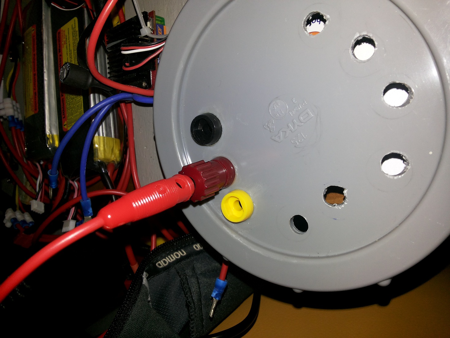

Oke now the powerline connecting is work, it gets rather hot I just found out when I mounted back in a part of the housing to see the lights together with the symbols.
Have to think about that for a bit. Back to the bulk connectors, building a seal with some inner tube to prevent the worst leaks now.

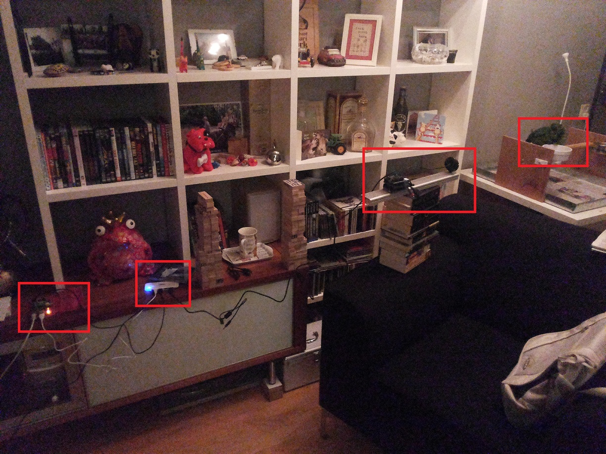

Small side project, our parrot (54 years old) has the habbit of dropping of its stand. It is a handicapt bird, missing some bits of his feet and unable to fly. So during our long weekend away on my new motor bike I used some of the internals of the ROV to send me an email each hour with a small picture to see if the bird was still in the right place and not on the floor.
The result, from left to right the equipment. Raspberry PI, USB Hub, Cheap webcam (plus my Arduino and mounting rail), Parrot on a stick :)
