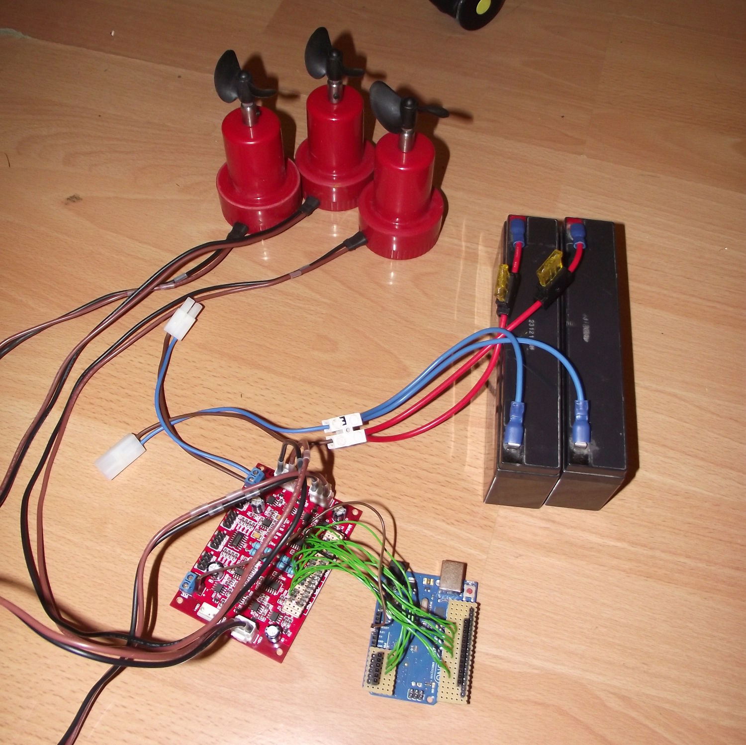

Here's the working control electronics. Batteries, motors, controller and Arduino Uno.

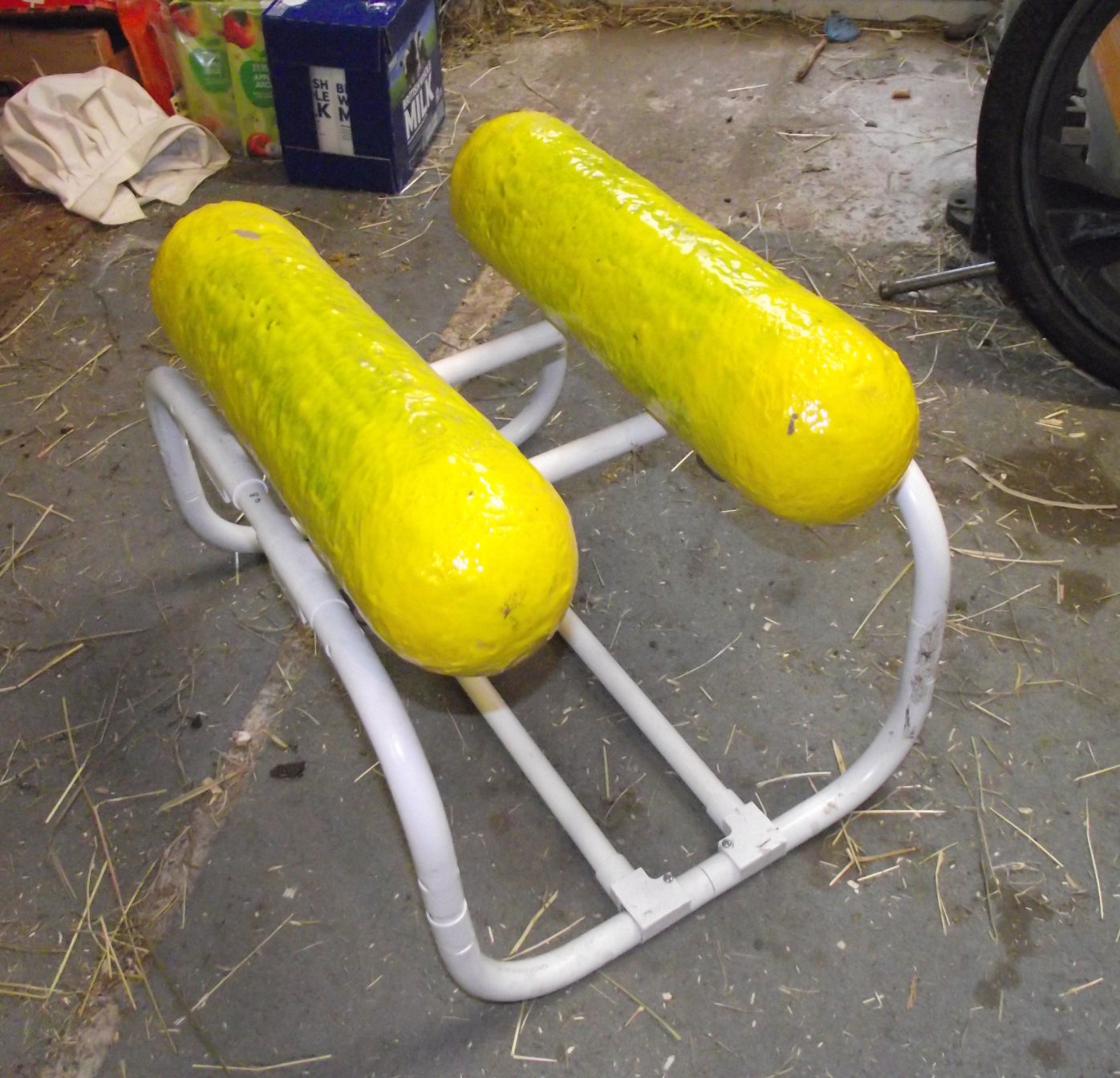

Here's the PVC framework with the bouyancy compartments in place. these are made in firbeglass and filled with polyeurethane foam. Overkill, maybe, but if one gets a puncture, it'll not flood.

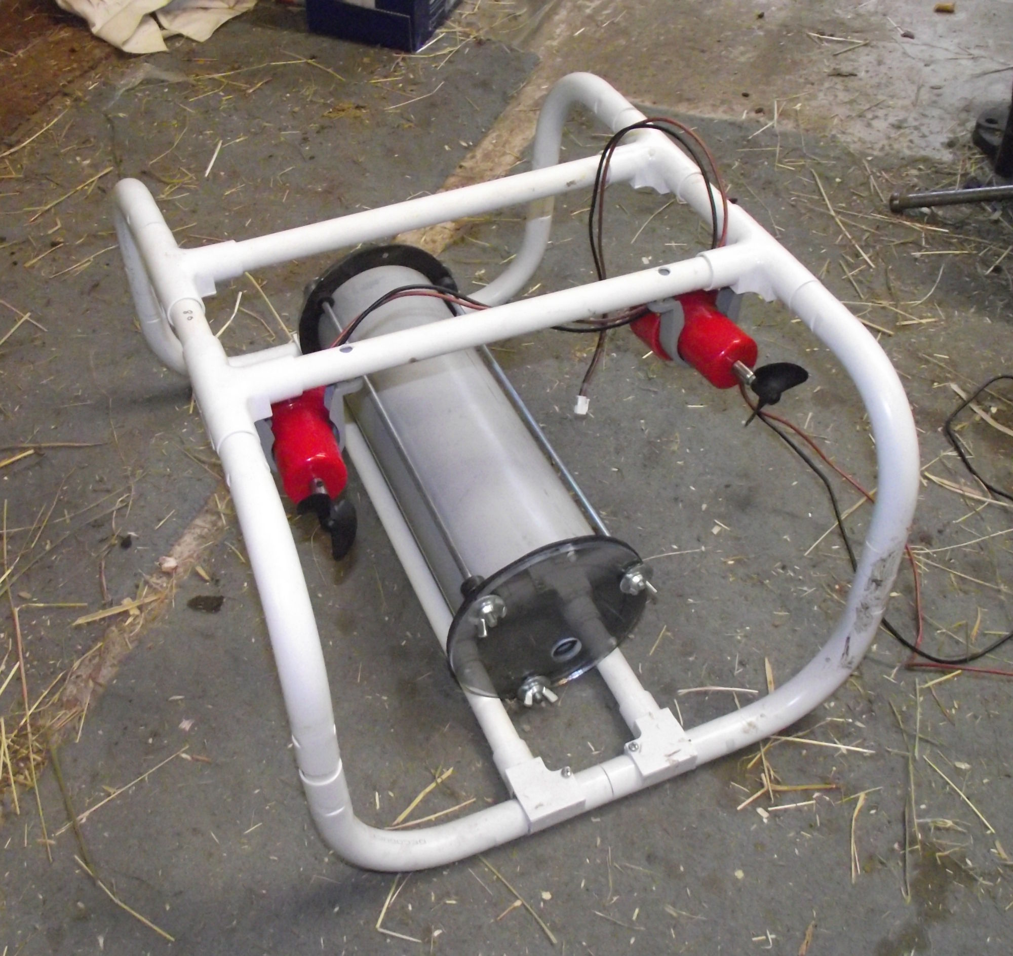

The bouyancy removed, showing the main electronics bay and the two forward drive motors and their mounting technique. Yes, they're drainpipe clamps. They're attached onto the chassis with brass M4 nuts and bolts.

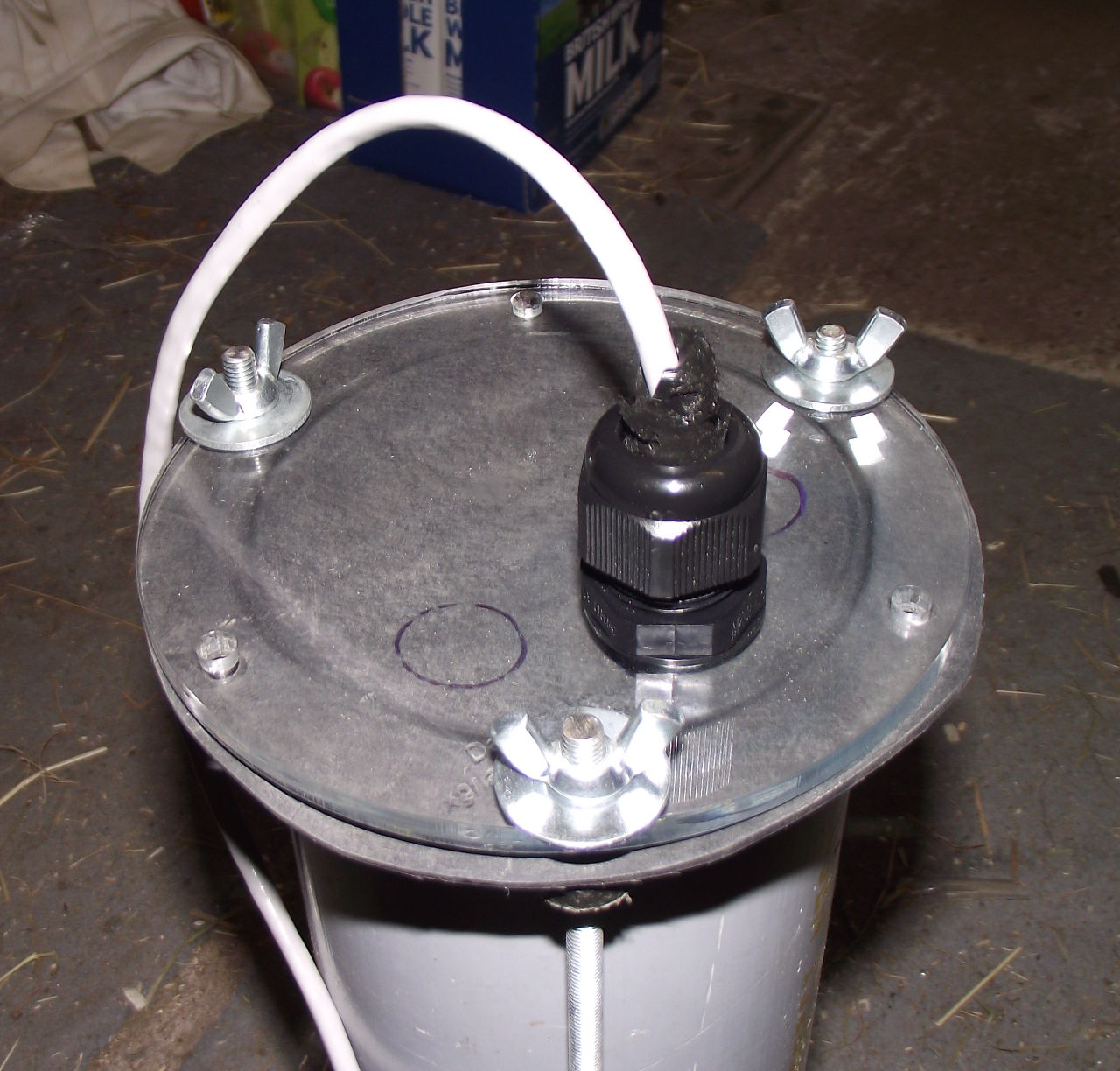

And the cable entry point. This is a stock electrical gland, but I filled it up with silicone, and let it set before screwing down the cable clamp. I haven't pressure tested it, but it works in shallow water.
