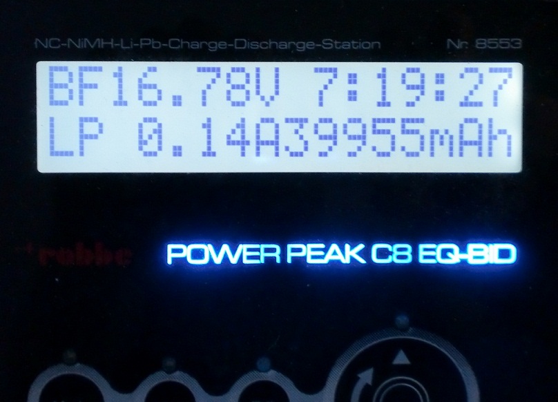

ROVER3D,
How long can you typically run your ROV with that battery pack?
And how long does it take to charge it back up to 100%?
Re: ROVER3D
Posted: Oct 22nd, 2013, 8:11 am
by ROVER3D
hey olegodo,
this is a very difficult question. whats a typical use?
sure it will run 4h in halfmode.. but my current rov isnt tested.
when i dimm leds to 80% they only take 50% of full-current. so there are many things you can do to stretch operating time.
Loading time at 6A:
