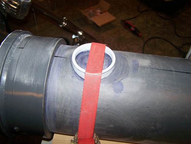

The idea of using a threaded plug penetrating the Hull posed the possibility of leaks around the threads in my mind. I opted to do it slightly different. I cut a 2" PVC coupling in half and began to file, grind and sand down each of the halves. One to fit firmly on the exterior of the Hull and one on the interior. After I was happy with the fitment I roughed up the surfaces with 80 grit sand paper. Then I applied purple PVC primer and then grey PVC glue to both the Hull and "Potting Well". I used a cargo strap to apply downward force to the exterior "Potting Well".
Glued and held with strap..JPG (33.81 KiB) Viewed 10776 times

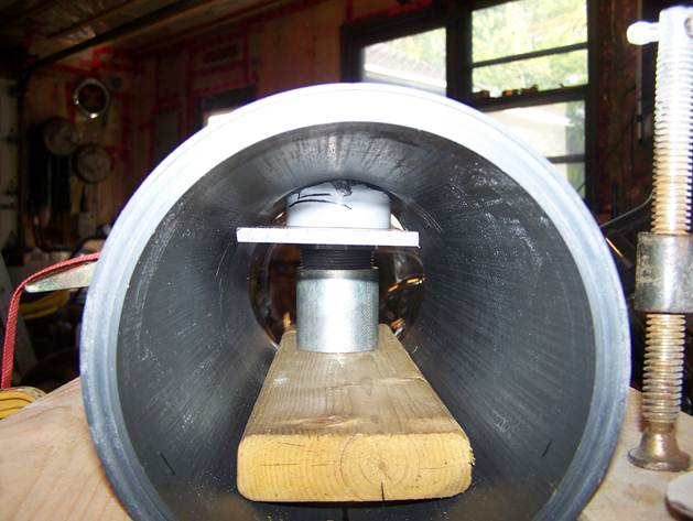

I used a homemade mini jackpost made from a galvanized 1 1/2 " water pipe coupling and a PVC threaded reducer to apply upward pressure to the Interior "Potting Well".
Mini Jack Post Tool.JPG (40.48 KiB) Viewed 10776 times

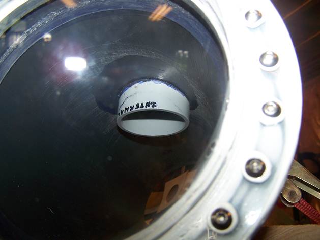

The finished product.
Exterior PVC Potting Well.JPG (35.67 KiB) Viewed 10776 times
Interior PVC Potting Well.jpg (26.02 KiB) Viewed 10776 times
