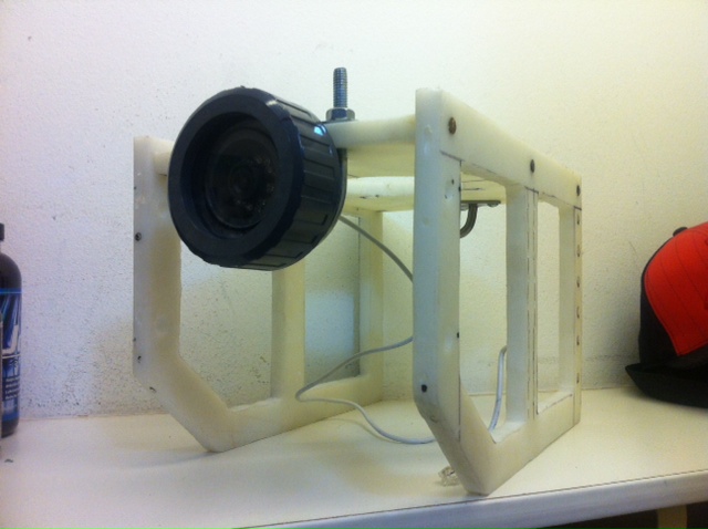

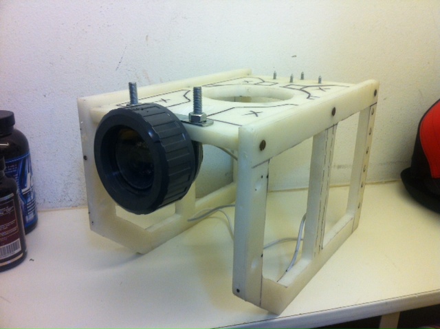

I ran across something today while I was out and about. I found a 3''x6''x12'' pvc foam block at a Florist! The foam is fairly sturdy. I'm pondering if two can be glued together to make a decent shape and formed that way. Its making me consider starting over before I get too far with the ok block I'm using now. I also got the DC motors, props and adapters, LED lights, and the camera finished. I have a second 1/2'' DELRIN frame I started a while ago i put on the back burner I might bring out of retirement and finish also. Two is better than one.

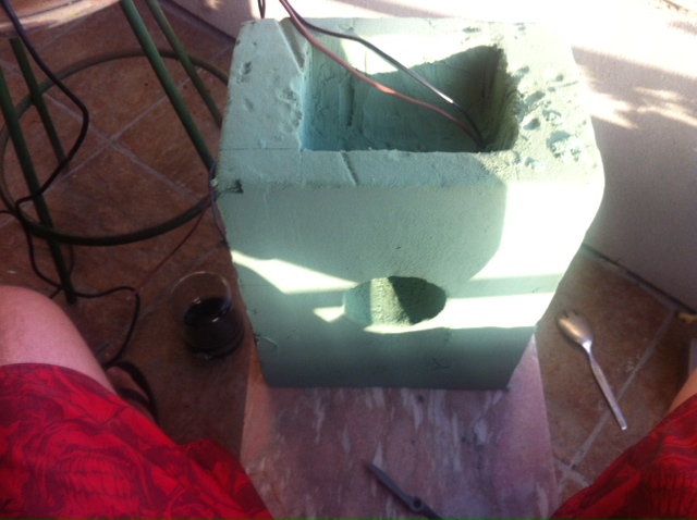

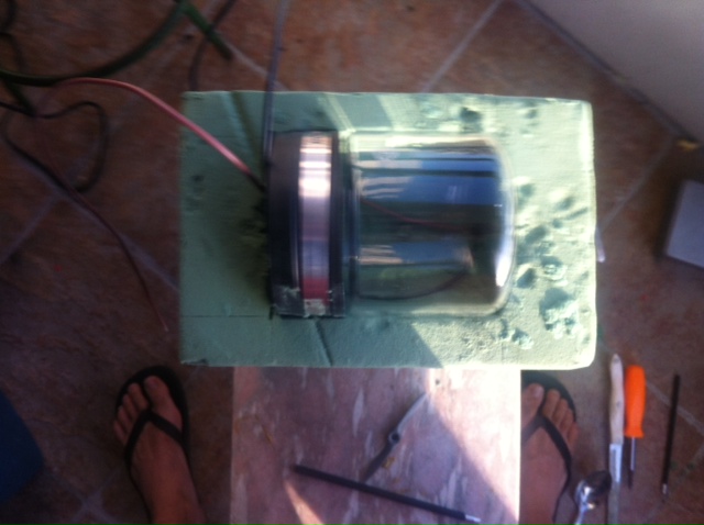

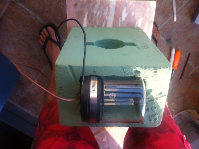

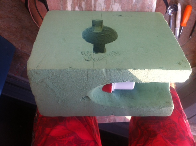

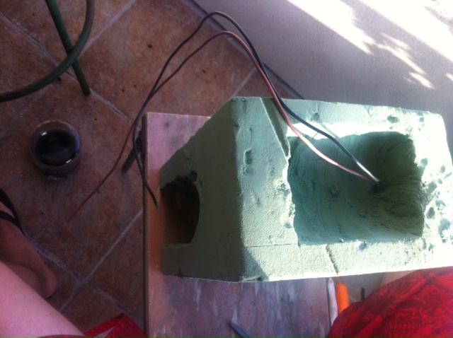

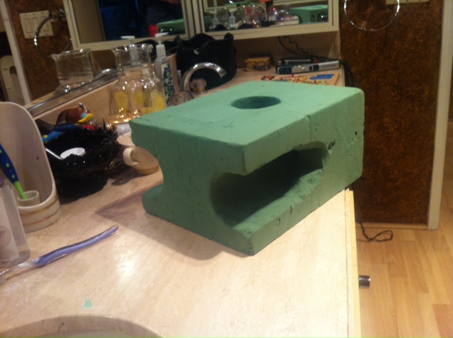

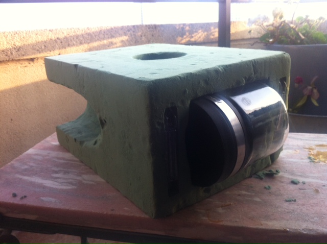

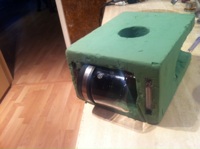

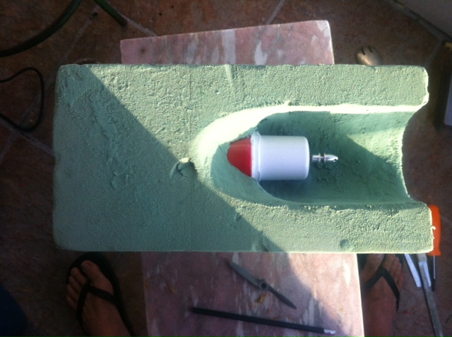

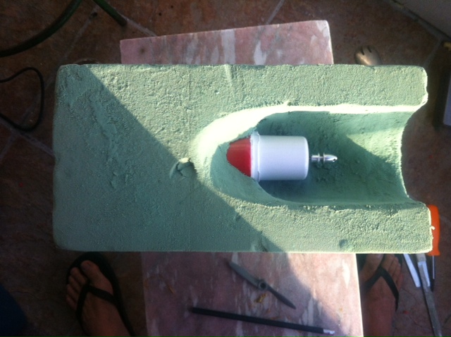

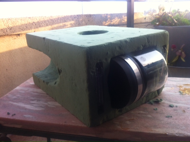

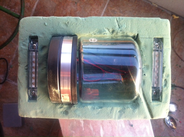

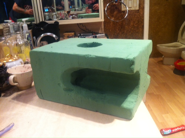

Ok some progress. Found a 6''x9''12'' block. Extremely easy to cut, mold, and manipulate. I used a tapered cup and just pushed and rotated it and it burrowed until the taper locked into it and then it breaks off clean. The rest I used assorted spoons ans knives and a pencil i pulled the eraser out of to make holes for the electrical wires to run. I plan on putting an Epoxy on the out side like a shell and then sanding, priming, and painting it. I also found a nice glass bowl thing and a rubber end cap to seal it. I will put all the components in it and sealing it.

I also took a few pictures of the Delrin Frame I started a while ago.

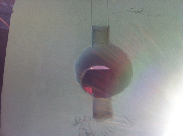

Started brushing the resin on. It soaks into the surface slightly and locks in. Take a few coats to get a smooth surface but its turning out better then I thought. More pics when Its done.

Update: I got the thrusters done. I did some testing with a new Prop and man does it put out some serious thrust. I dropped it into a full tub and when i powered it the whole thruster came out of the tub. Not exactly what I thought was going to happen. I used a 57MM 42 prop from offshore electric inc. Its a three blade high twist prop for race boats. I started with installing then the normal direction then for giggles tried the other way and that's when I got the surprise. I also received my dual relays. I will be wiring this thing up after I get the frame smoothed out and painted. I'm still not sure of a color. Maybe safety orange.
