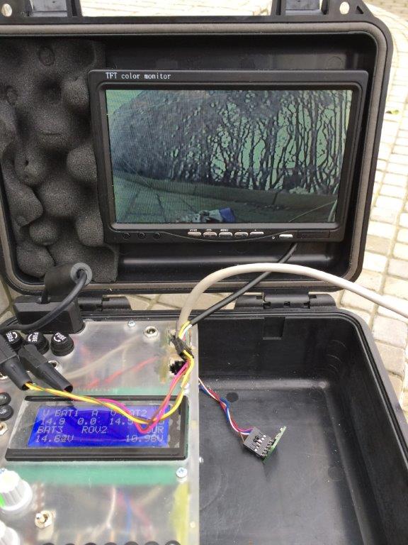

Surface box with PS 2 controller and cable drum.

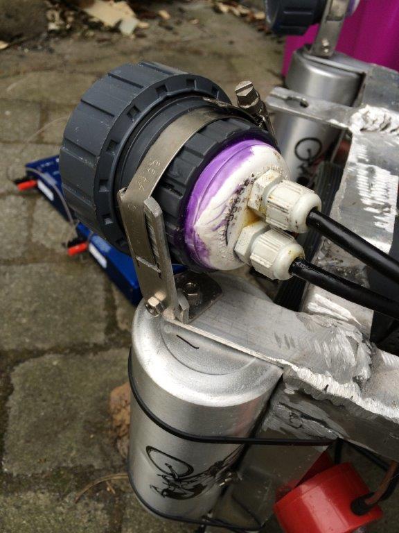

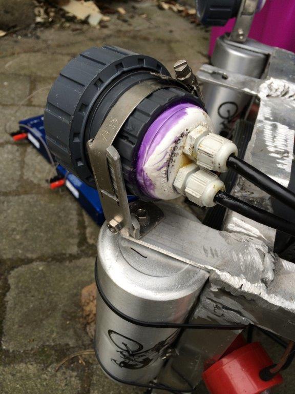

Flange and nut for dome

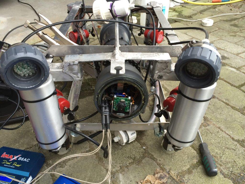

More pictures:

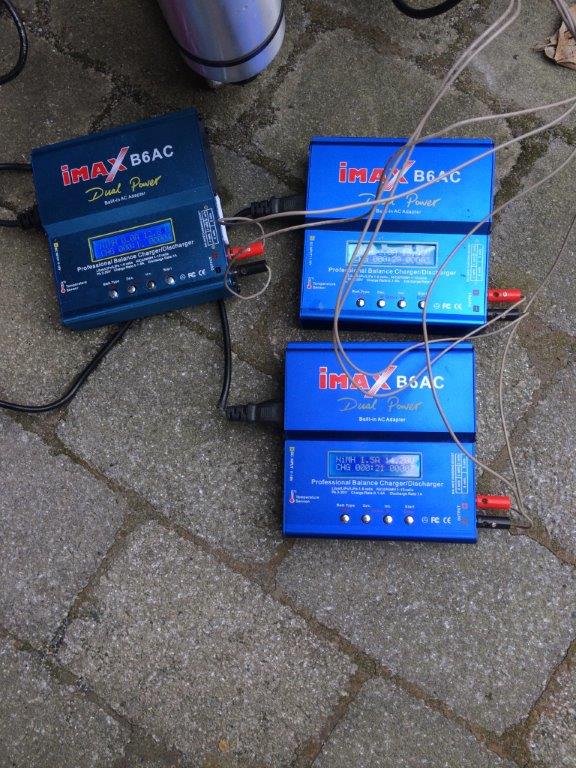

Charging point for 3 sets of batteries

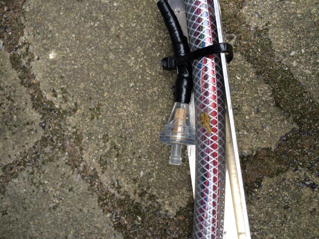

Filter for ballast system

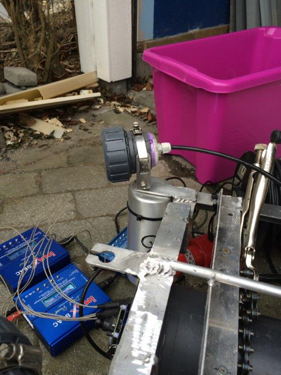

I have used 4" PVC piping for the main housing and ballast housing and 4" union for the connections.
I ordered the dome from UK. I can not remember the company name. Its a 3mm acrylic dome.

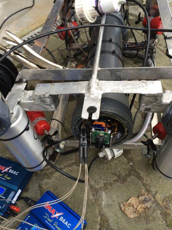

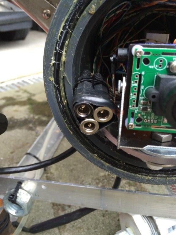

Camera is one simular to this one: http://www.ebay.com/itm/420TVL-1-3-SONY ... 19e062321d
Camera mount: http://www.hobbyking.com/hobbyking/stor ... ount_.html
I transfer the signal by using video balun system like this one: http://www.ebay.com/itm/2x-Coax-CAT5-Ca ... 3f2aa5f748 Video signal is wired up to the surface box real time. I can either connect it to the screen in the surface box or to a computer. Recording have been done by the computer.
