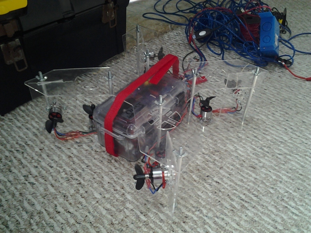

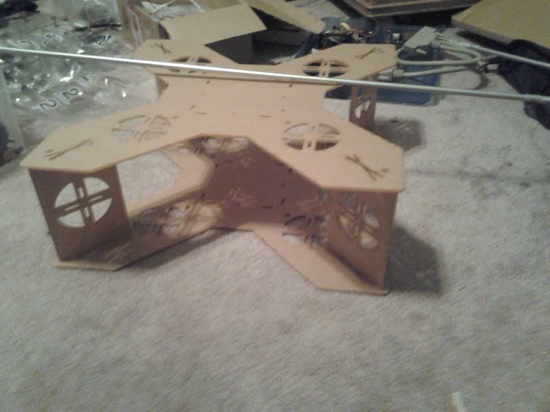

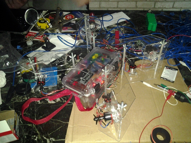

ltdcruze
Posts: 47
Joined: May 3rd, 2011, 7:32 pm
Re: Spartan ROV
Post by ltdcruze »
Been a bit busy lately, but finally got some time to update my ROV.
