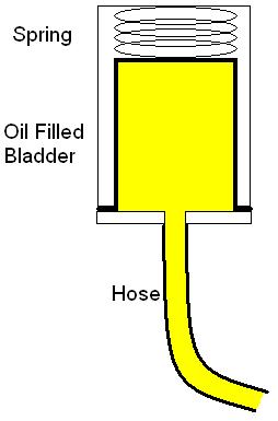

by Silver dollar
You don't need the balloon. The oil is not compressable, so if you don't have any airbubbles it will have the same volume 100 feet under water as on the ground.

Hi Silver Dollar,
It's virtually impossible to remove all the air bubbles, especially in a system like the one I'm designing, unless you vaccum everything (not really practical), so the compensator takes this into account.
It also takes into account any volumetric changes of the fluid due to changes in ambient temperature ;)

by marcane
The hoses to the thrusters will act as compensators, really dont think you need the baloon.. have you made the ESCs yourself? Can you run the motors directly into reverse without breake? That is an issue I have om my thrusters, i have to give the the thruster two reverse signals to actually get reverse.. im running brushless outrunner, car ESC and polulu mini maestro to run it from the computer..

It really depends on the volume of oil I end up with in the system, and I may at some point want to apply a slight positive pressure (with a spring) so if there is a leak fluid goes out rather than water coming in. If I get really fancy I may put a sensor on the compensator (the balloon was just for illustrating a concept) to measure the volume of fluid in it so I can tell if I have any leaks, and possibly how fast the leak is ;)
