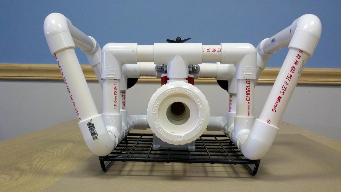

The new size is roughly 10" wide, 16" long, and 8" high.

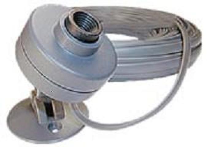

Also I plan on using a stripped down version of the Anaconda camera. If the housing is too tight, I will switch out the 1 1/4" PVC coupler and use the 2" coupler. (Steve's "How To" is all you need for PVC camera housing. Brilliant!)
:) one more request.... I know this isn't the Control Info section but I have a question about the simplest joystick wiring setup. I want to use only female crimp type connectors (No Soldering) to wire the joystick, relays, and thrusters. Hoping that anyone looking at the mockup can offer words of advice. :P thanks.

My advice is to solder all of your connections. The extra effort of soldering a few connections far outweighs the the hassle of trying to troubleshoot a flaky connection.
Looks very nice, though.

One other thing I didn't notice before... You might want to angle your camera downward a bit, that is if you plan on looking at the bottom without having to sit right on it. (which tends to kick up slit)
