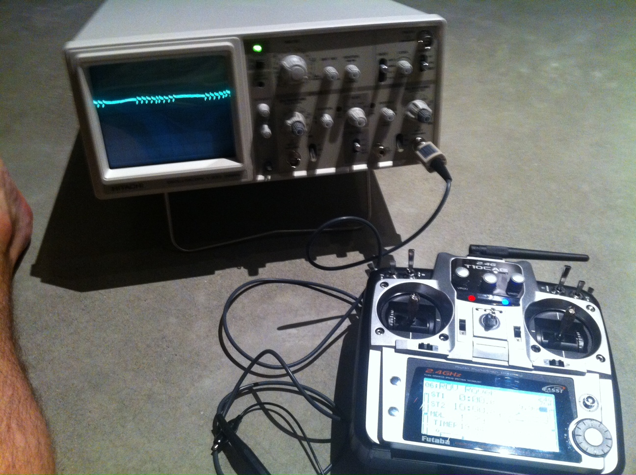

My Futaba T10C has a trainer port, I'm going to tear open the training cord and connect it to my O-scope and see what the "F" is going on.

Yes it's true, my training port is generating 9 channels of ppm data. What I learned is that I have no idea how to use a oscilloscope, so I googled it. What I saw was only a raw PPM signal with no mixing, I believe that I can select the mixing in the controller menu.

by looking at that scope trace, it appears you don't have the probe's ground properly connected.
I'm surprised by the no mixing though. however that isn't the end of the world if you are driving something like an arduino. just do all the mixing in there.
