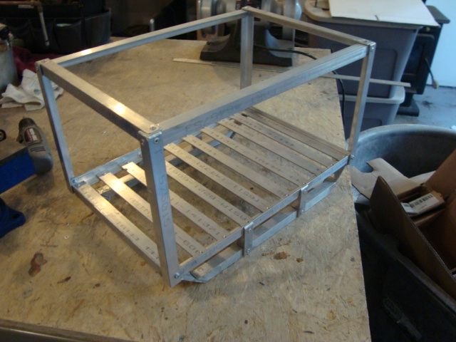

I have been working on the frame. Here is a picture.
Here is the frame
Here is the frame
Re: My ROV project
I assume that it is aluminum? What did you use for the fasteners at the corners, are those rivets?
Looks cool, It'll be neat to see how it looks when it's finished. 8-)
tanner331
Posts: 26
Joined: Mar 22nd, 2011, 7:14 pm
Re: My ROV project
Post by tanner331 »
Those are pop rivets most of the frame. The corners on the base are bolts with nuts so the top can be removed.

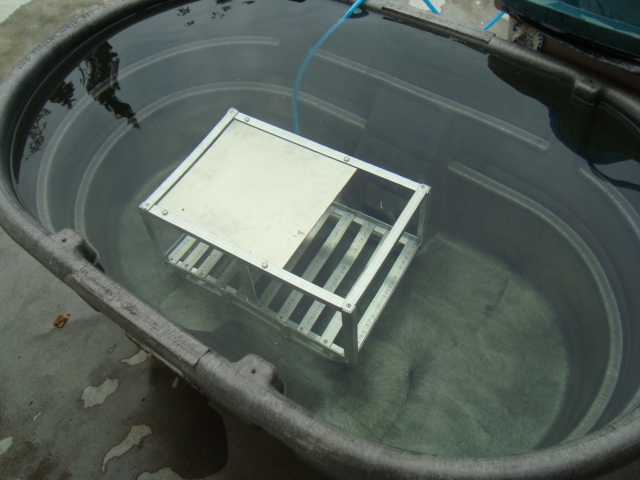

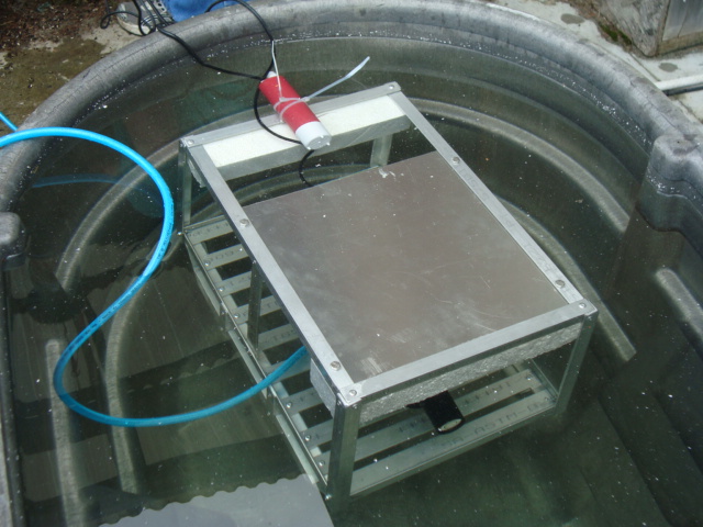

Here are a couple of pictures of my latest test. I tested the ballast, camera, and motor.

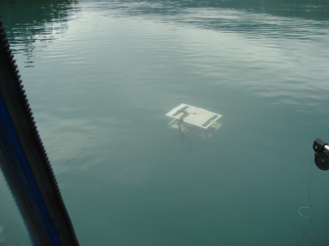

I did a test run of the ROV today.It went down to 50ft. The motor and the ballast tank worked perfectly. We forgot the plug for the camera so I don't have ROV view footage.I will post pictures soon.

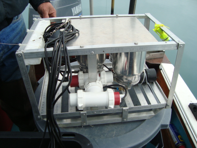

We did another test on the ROV the other day. We built the control board and attached all 4 motors. We sent the ROV down to 75ft. The motors worked perfectly at that depth.I will post footage of the ROV soon.

Here are the motor mounts
derelicte
Posts: 292
Re: My ROV project
Post by derelicte »
Very nice, but what is the air tank for?
tanner331
Posts: 26
Re: My ROV project
Post by tanner331 »
The ones on the ROV are the ballast tanks. They are used to raise and lower the ROV. The one on the control board is to pressurize the ballast tanks.
