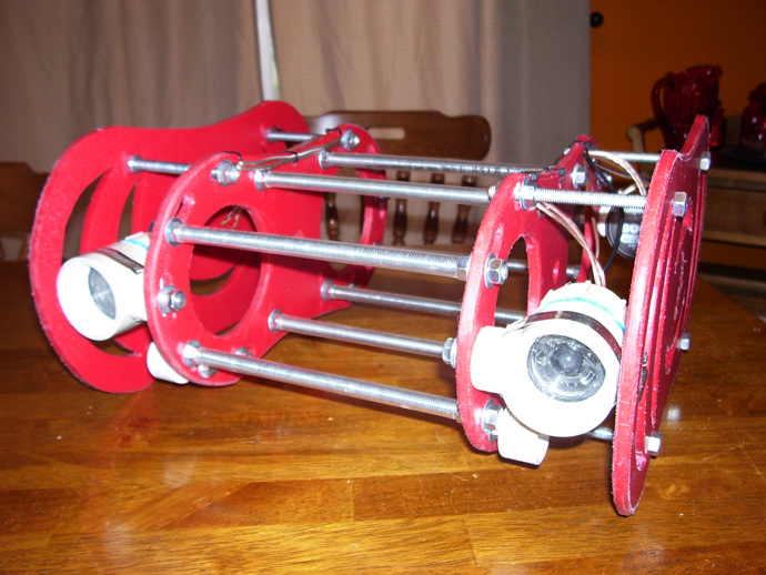

Hey gang,
I just wanted to show you how the rov is shaping up. Remember that there are still two other side plates to go on to protect the lateral thrusters, lights, and sensor array. Oh, by the way the strut were cut with a hacksaw. The struts are made of all thread so that I can "Dial in the compression of the o-rings that seal the end caps to the polycarbonate tubes where the camera and electronics are housed.

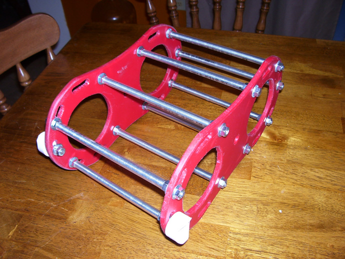

Just wanted to show you all the progress that is being made on the new rov. Still a far from finished. It currently weighs about 6.8 pounds.

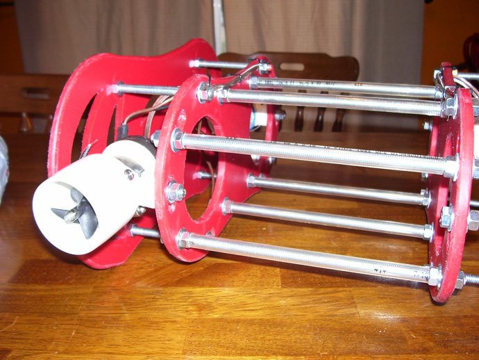

This angle is from the back showing a possible placement for one of the thrusters, but I may move it further to the front.

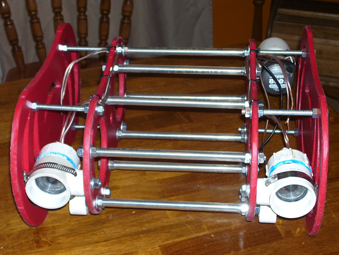

Just another angle from the front.
This is from the front of the ROV, but these are not the lights that are going on it.  They are just stand ins.

Hey gang I need your help. Like I said I got the new aluminum struts built, but need more washers and nuts for the outer side plates. Which only act as bumpers so to speak. If I put them back on then the rear thrusters will be moved forward to protect the kort nozzles. My question is is should I leave the outer sides off or put them back on? Any feedback would be nice.

wow the it looks like a professional grade ROV :D
tazdevl77
Posts: 15
Joined: Dec 20th, 2010, 12:00 pm
Re: Current work in progress.
Post by tazdevl77 »
PaulC, I'd leave them off. Less weight and less drag. Most ROV's I have looked at don't have protective plates and bumpers on them. Tim
PaulC
Posts: 102
Joined: Nov 13th, 2010, 9:19 am
Post by PaulC »
Thanks for all the comments and recommendations. I believe that I will leave them off for now. Do you think that I should move the lateral thrusters forward?
tazdevl77
Posts: 15
Post by tazdevl77 »
I would tuck the thrusters more forward if you could, make the ROV more compact and it will add a level of protection.. TIm

what type of thrusters are you using for your ROV? :?:
