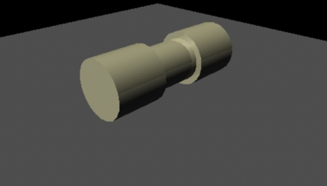

Pilikia I am sorry if I seem to have taken it the wrong way. I agree with everyones comment about the "Hang Up's" or the possibilities of hang ups. If anyone out there has any ideas about the shape of the capsules I am open to ideas. Maybe, if we all work together on this one we might just be able to all benefit. Things to remember about this we need it to be rather low cost, rigid, of course no hang ups if possible, I also think that most if not all materials need to be "off the shelve" so to speak. And if anyone has any ideas as to how long to make the tube portion of the capsule that would be great. I was thinking right of the cuff that it should be about in overall length including the caps should be 2 1/2 or 3 inches. I guess some serious testing is in order.
- capsule.jpeg (36.1 KiB) Viewed 11064 times

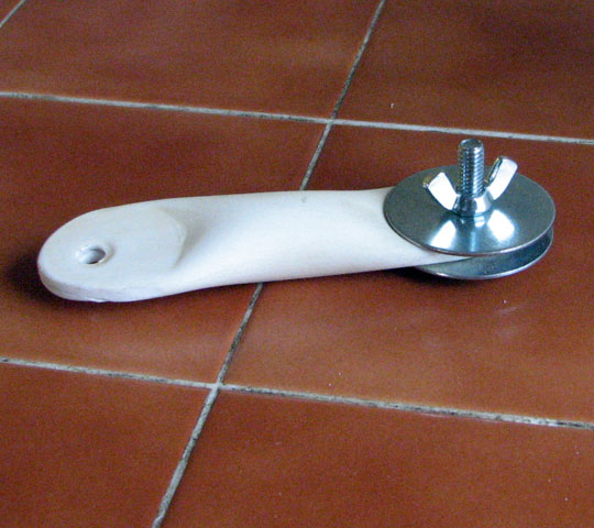

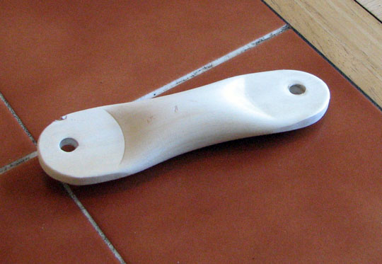

Hey Pilikia,
Did you just heat it up and squish the ends, and if so is it watertight?
Re: Tether buoyancy idea.
yes, in kitchen oven preheated to 250 for 15 minutes. Holes were pre-drilled and pipe cut axially with hacksaw to a depth just below the holes. Each clamp was two 2" x 5/16" fender washers and bolt with wingnut. I took it out of the oven, clamped one end, put it back in the oven with clamp on it to resoften the pipe, then took it out to clamp the other end with another clamp.
Is it watertight? Ummm... It does float, and I don't hear any water sloshing around inside it. Haven't taken it to depth. My intent is to put a little "worm" of epoxy clay behind the bolt, which will then be squished out while clamping to seal it. For this test, I didn't try including the epoxy clay. I just wanted to get the forming technique down.

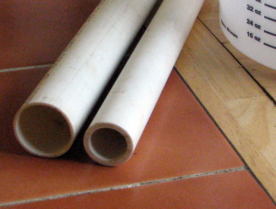

I'm surprised how little buoyancy it offers. I think Steve's observation that schedule 40 is heavy, and a bit overkill is a good point. Today I am trying it using 1" class 200 PVC pipe. It has a much thinner wall. Comparing equal lengths of 3/4" sch 40 and 1" class 200, the sch 40 is more than 40% heavier, which is robbing it of a lot of buoyancy.
Do you intend to have the floats permanently affixed to the tether? Or to attach them as the tether is deployed? Have you settled on your tether yet? If we knew its diameter and its weight per foot, it'd be pretty simple to determine what spacing any particular float requires. Or at least have an informed starting point for testing.

- Forming clamp
- FloatClamp.jpg (97.5 KiB) Viewed 11055 times
- 1" Class 200 PVC along side 3/4" sch 40
- class200pvc.jpg (82.77 KiB) Viewed 11055 times
- No. 64 rubberbands (consider a consumable)
- Float_on_Tether.jpg (91.68 KiB) Viewed 11055 times
