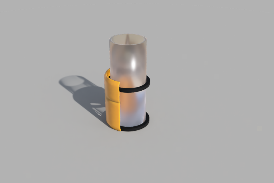

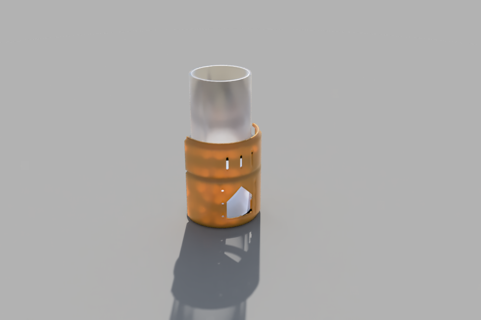

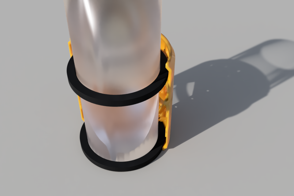

All the 3D printed parts aren't required to be waterproof. They are just the structural pieces. Te only waterproof part will be the blue robotics watertight enclosure (the plexiglass cylinder with the two caps made by them. <><

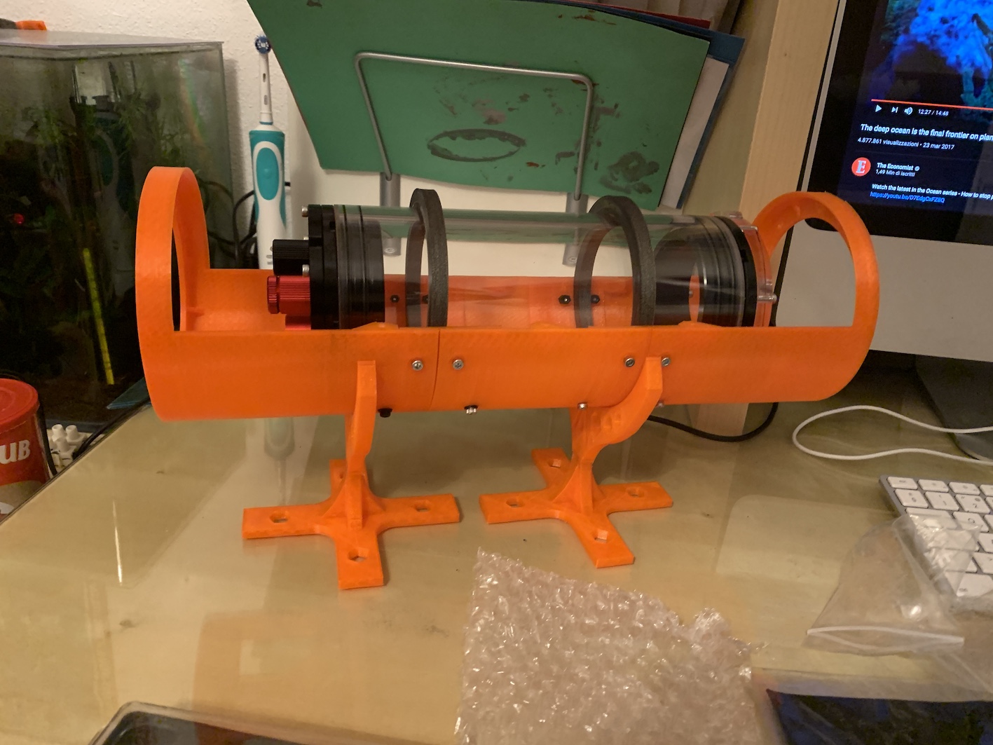

Little update... I made two TPU flexible "tube holders" for the blue robotics 3inch watertight enclosure. I already printed them and it fits great.
STL model:
tubeHolder3inch.stl.zip
(103.25 KiB) Downloaded 6530 times

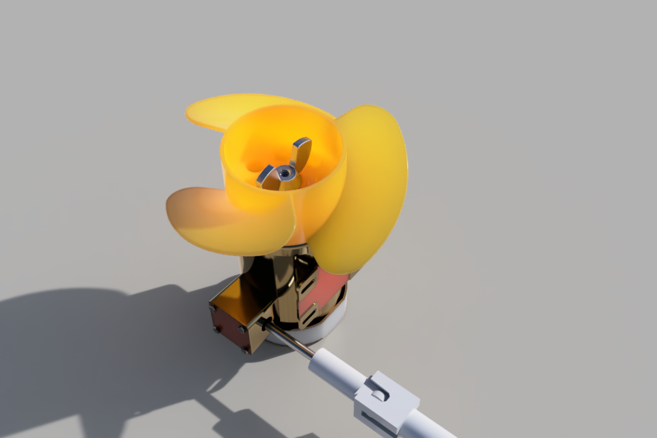

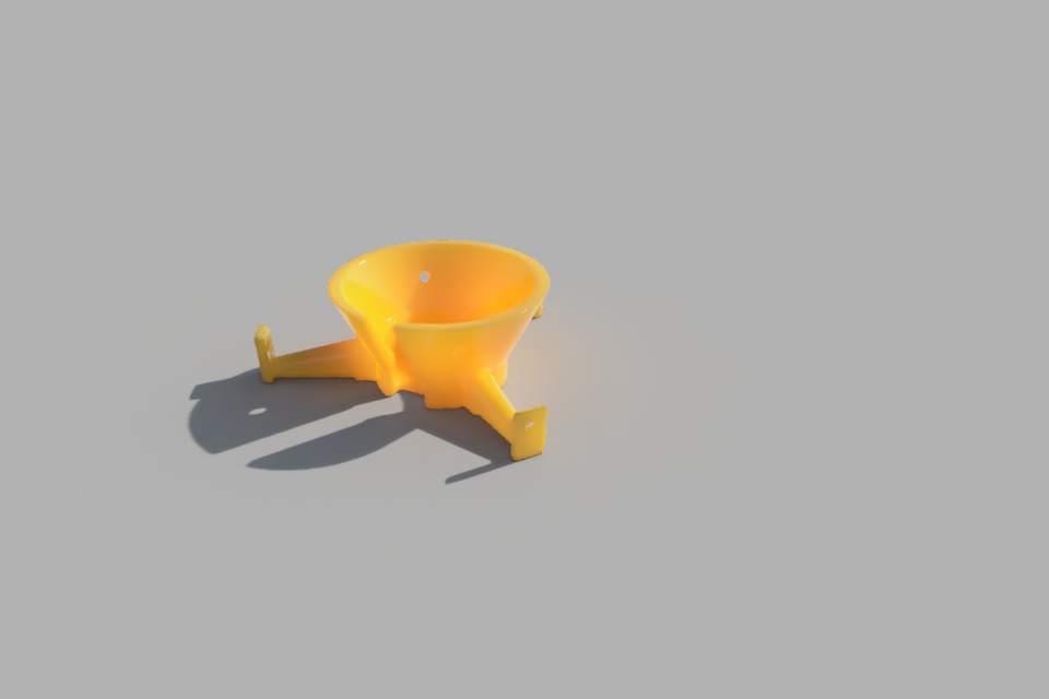

Here is the adapter for the prop I had to modify since I will use different motors than the creator. I am using Walkera QRX350 old motors.
Here are some renders (if you need the STL write me since its to big of a size to upload).

Here is the prop pieces adapted and created for my walker QRX350 motor. The motor and the cables in the rendering aren't exact, I added them just to see it "built" in the computer.

If you look, Blue Robotics went to a 3-bladed prop on the new T200 thrusters, and most professional ROV's also have 3 bladed props. I believe it's the most efficient in water. They are also usually different from boat props, boat props being designed to work best going forward, while ROV thrusters need to push both ways often. Like this with 3 blades cut off... https://www.banggood.com/QX-Motor-30mm- ... rehouse=CN

Oddmar wrote:If you look, Blue Robotics went to a 3-bladed prop on the new T200 thrusters, and most professional ROV's also have 3 bladed props. I believe it's the most efficient in water. They are also usually different from boat props, boat props being designed to work best going forward, while ROV thrusters need to push both ways often. Like this with 3 blades cut off... https://www.banggood.com/QX-Motor-30mm- ... rehouse=CN
Thankyou, just made the modifications.

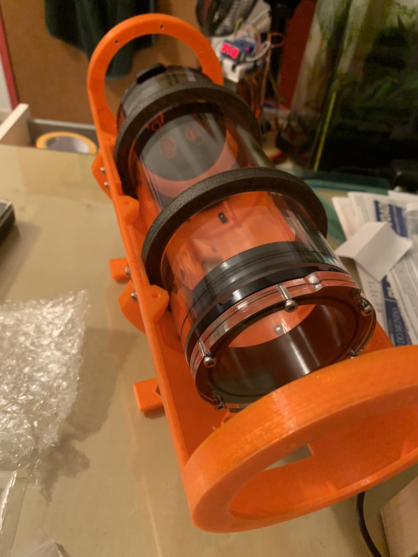

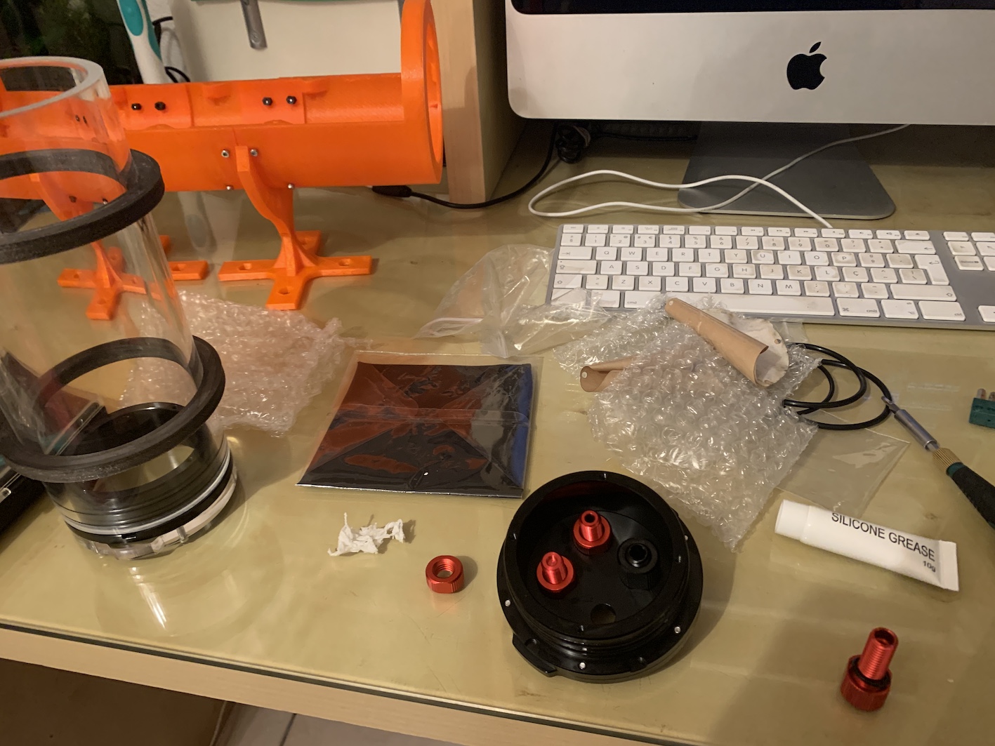

Just assembled BlueRobotics watertight enclosure and penetrators... Amazing!

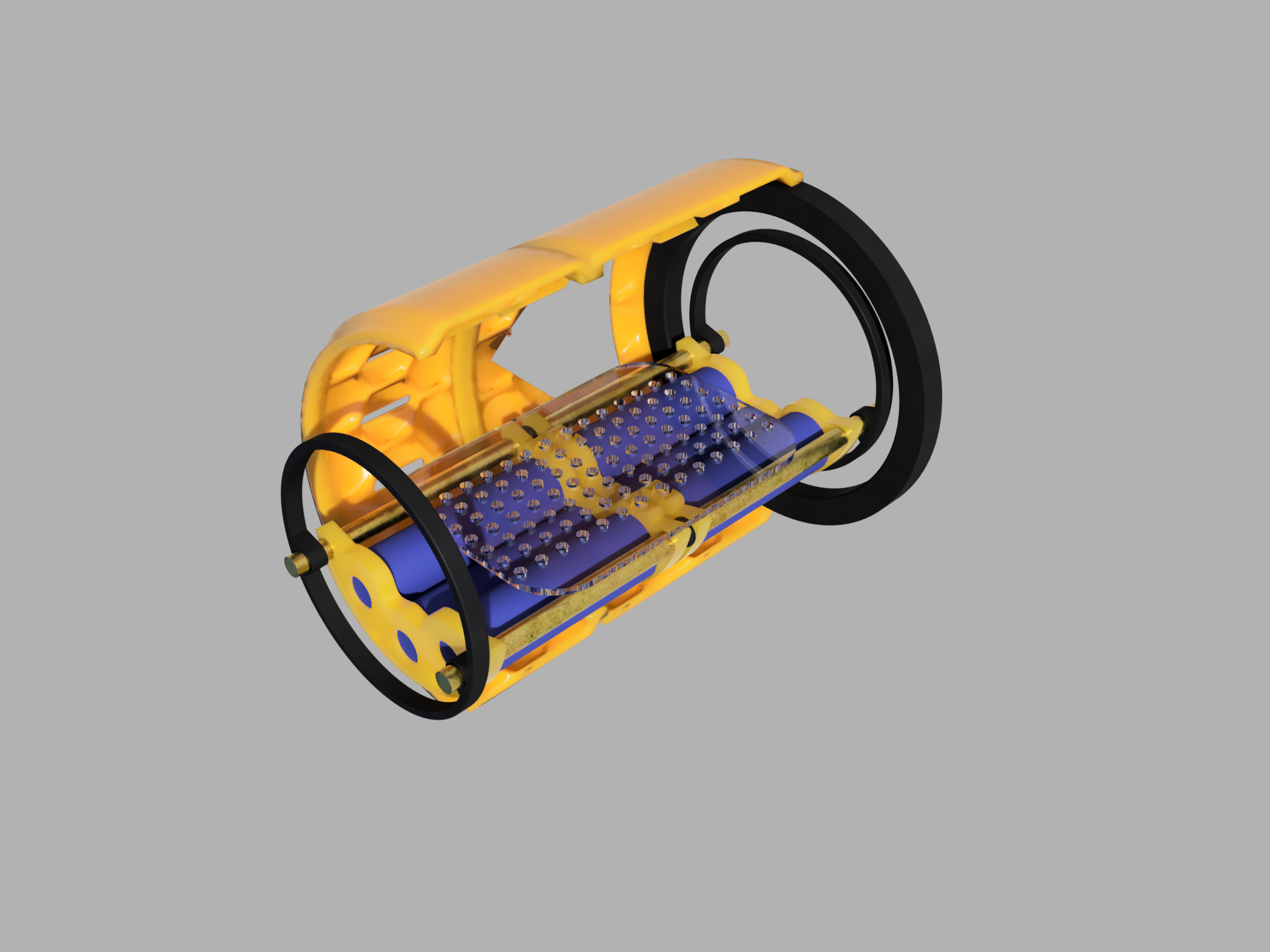

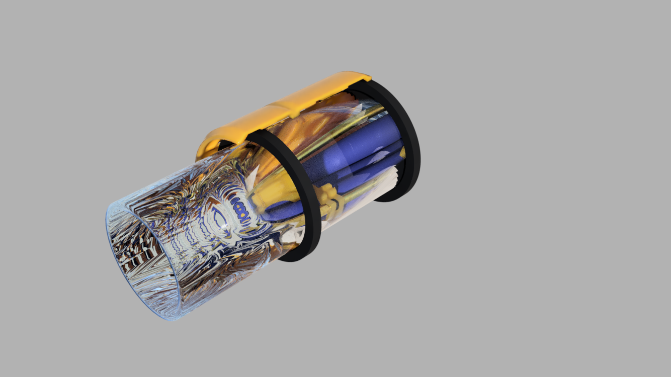

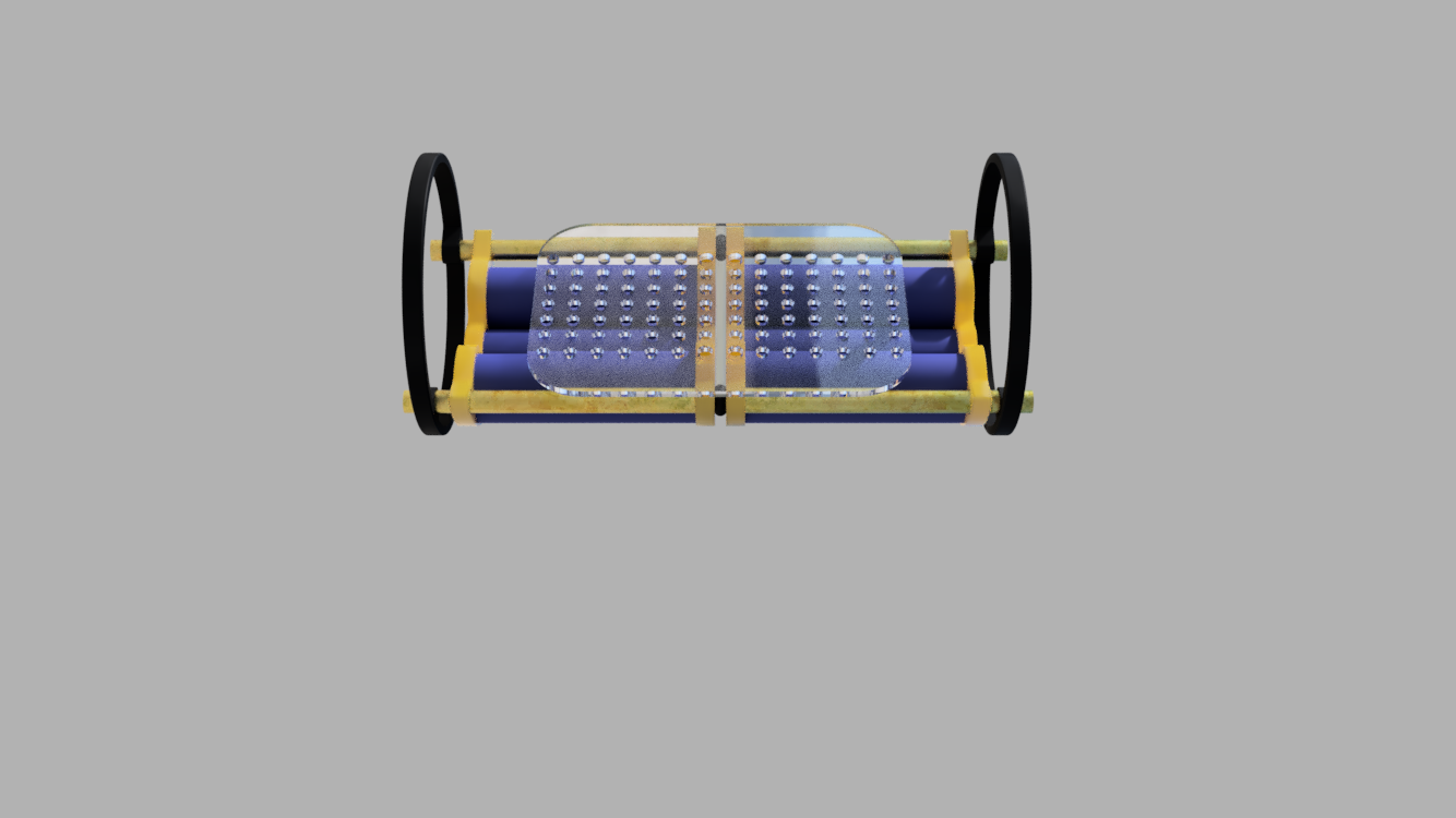

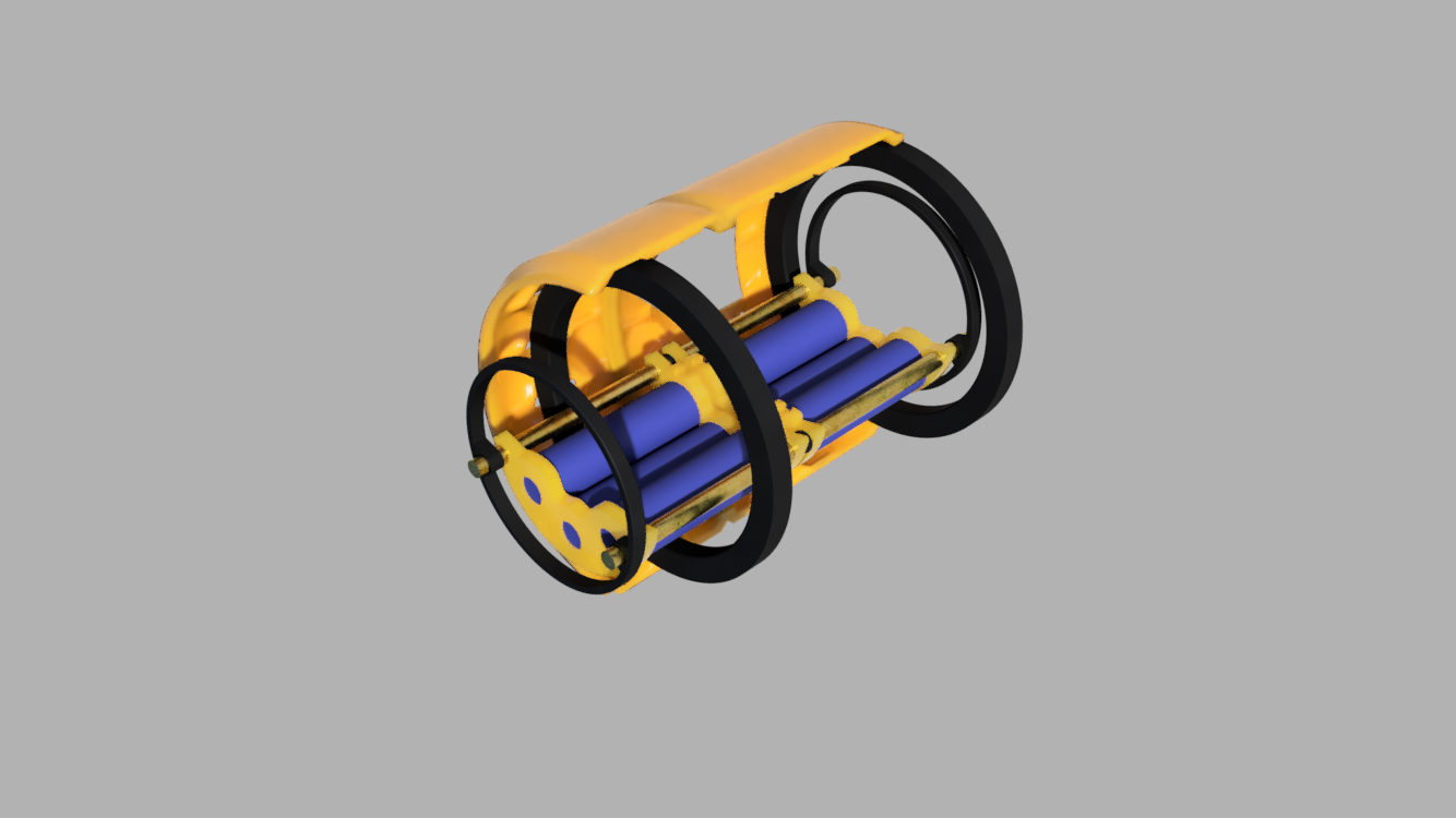

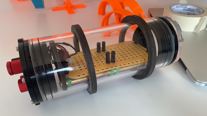

Just made the dry compartment system. The plan is to have 6 18650 batteries and the rest of the tube can be used for electronics.
And here is the exploded view:

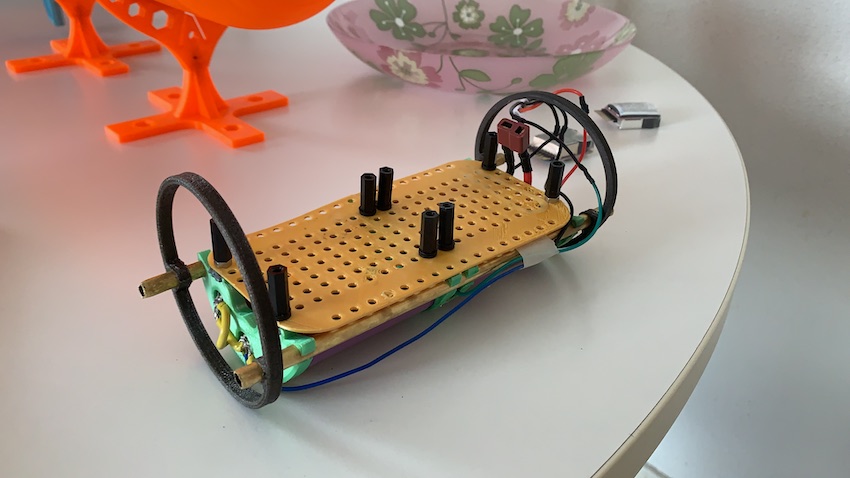

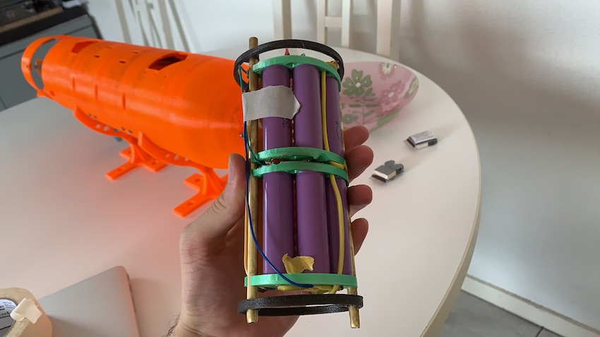

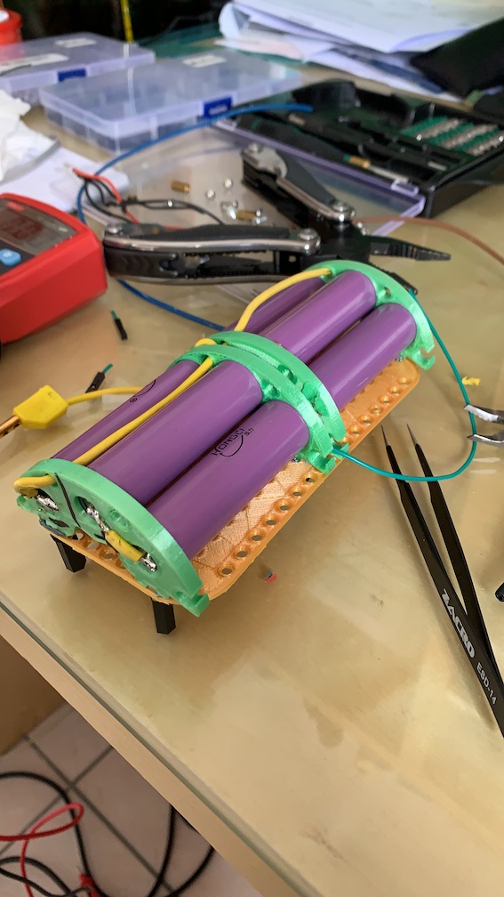

Just made the Dry compartment battery/attachment.

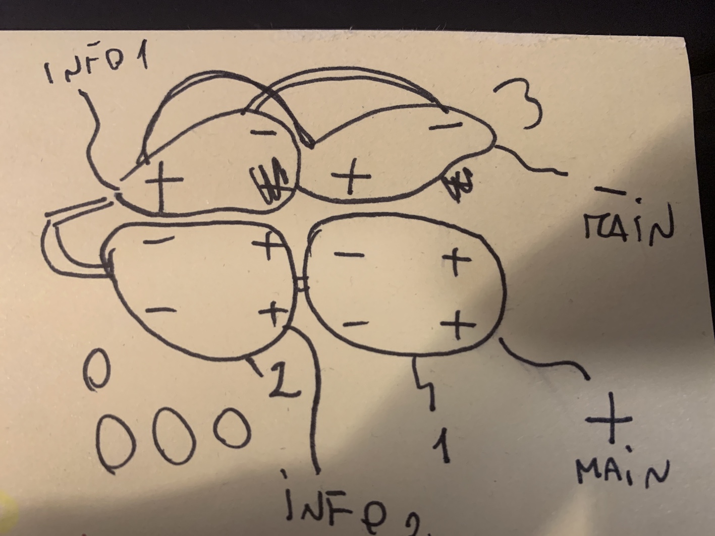

Here is a picture of the battery wiring (3S 2p):
And here are some pictures of the finished piece:
