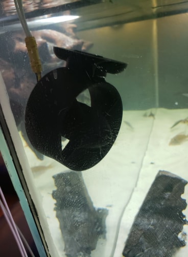

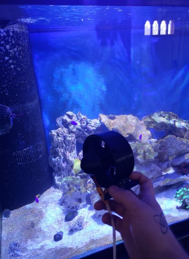

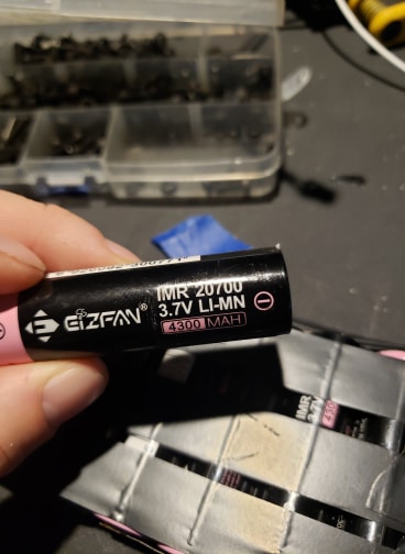

Got to test a motor today in freshwater and salt due to having a freshwater aquarium and a reef tank. My most important project is getting the end flanges cast everything else is just waiting for stuff to come in the mail. I have a pretty good idea on how I’m going to waterproof the through hulls. Battery wise I will be making my own 3 cell 17000Mah battery from 20700 cells more to come on that. I will post as much as I can over the next week but it will probably be slow.
3D printed flange to test fit it for stungness before its casted.
flange test fit.jpg (41.62 KiB) Viewed 8991 times
water change on the reef tank today do I tested the motor in saltwater, worked out fine.
saltwater test.jpg (40.59 KiB) Viewed 8991 times

3s 17000Mah battery made from these.

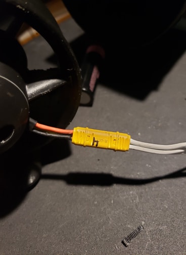

Best connectors ever!
awesome connector.jpg (27.27 KiB) Viewed 8991 times

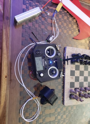

Test setup. Controller is just to send PWM to the ESC.
test setup.jpg (50.64 KiB) Viewed 8991 times

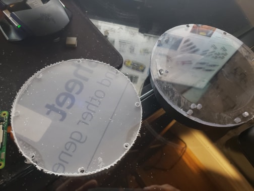

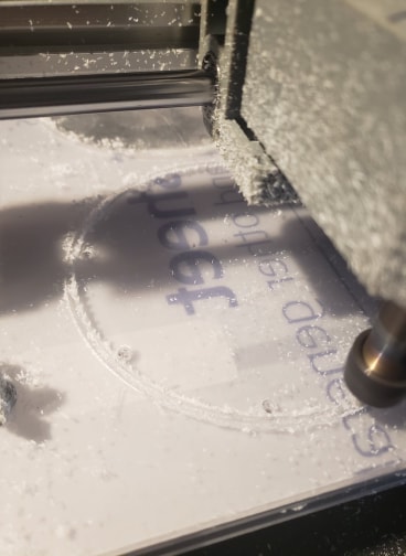

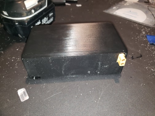

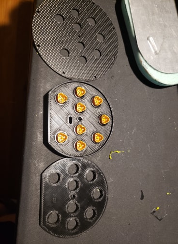

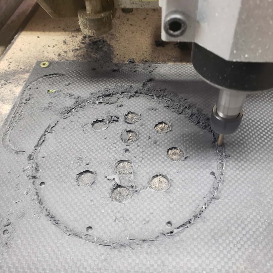

Took a break last week, had to wait for some parts to come in. Tried to cast the flange a few days ago but ended up running into a time crunch and wasn’t able to pour. I was able to CNC out the viewing port out of .25 inch lexan after a few mistakes. I am currently in the process of making the water tight through hull connections, designing LED fixtures, and the electronics tray. I just knocked out the battery set up last night. Here are some pictures.
making a T-1000
making a T-1000

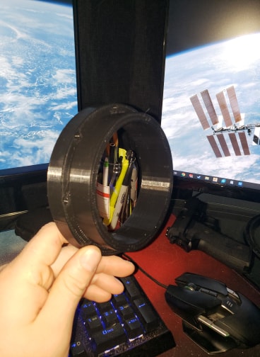

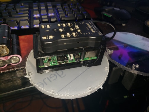

printed a housing for the RPI3 and Pixhawk

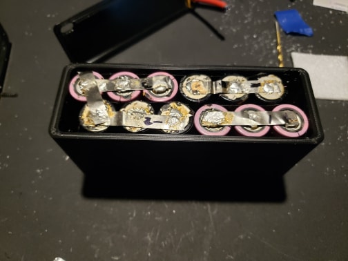

went with a 4S 12900mah battery design
battery box 23.jpg (42.11 KiB) Viewed 8962 times
battery box.jpg (31.39 KiB) Viewed 8962 times

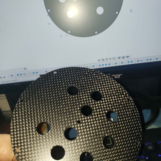

New update for today: I cut the aft pressure hull bulkhead out of carbon fiber plate. Still learning tolerance measurements for CNCing, my machines could be a couple of blonde ones off. So when CAD says the hole is going to be 12.67mm the machine gives me 12.44 after the cut. Still a work in progress, so I ordered 13mm drill bits to finish the main bulkhead holes. The bulkhead will be comprised of 3 3D printed parts that just hold the connectors in place to be completely submerged in epoxy hopefully granting complete water tightness.
