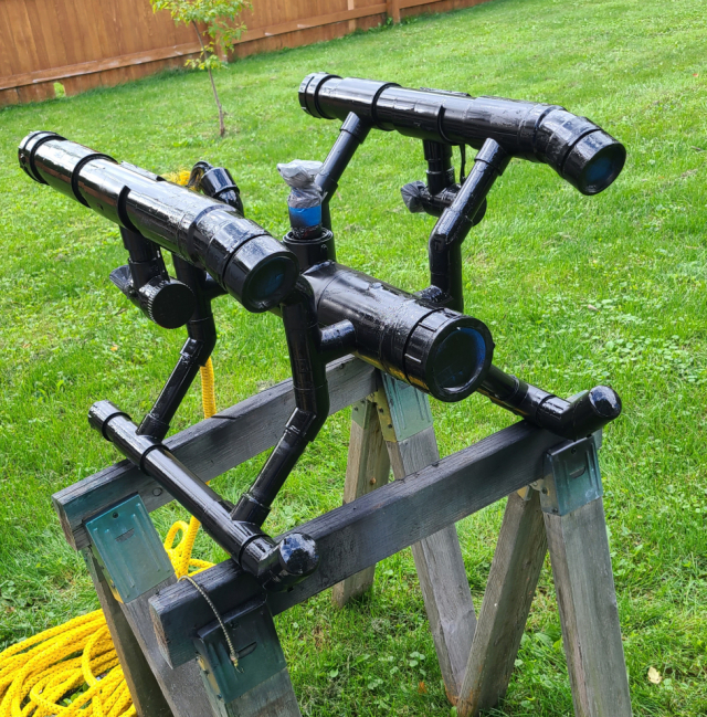

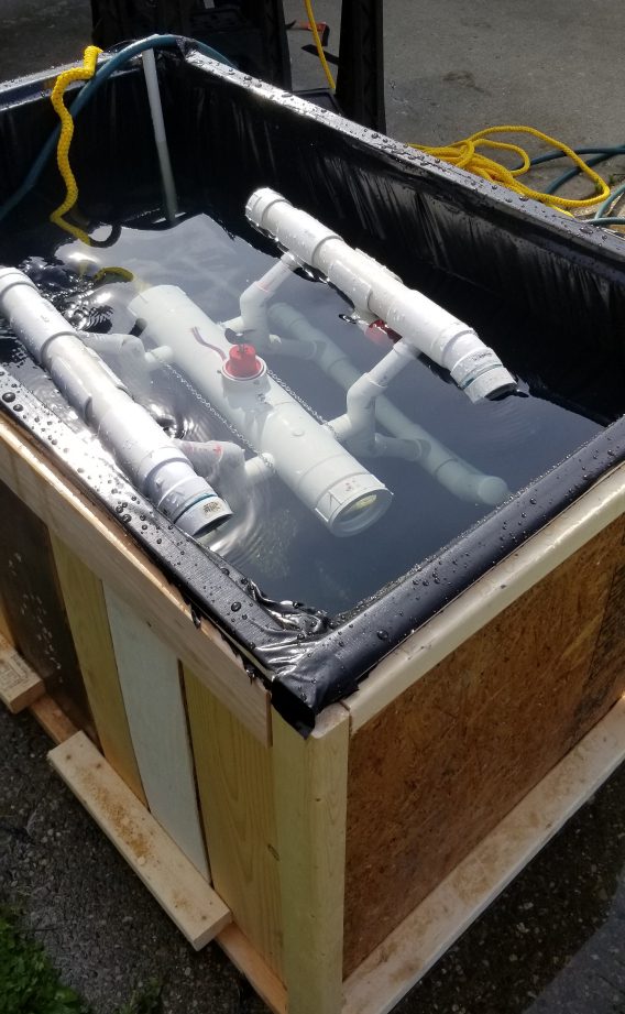

It's in the water controls are all good directionally but needs more weight to go down for sure, so off to the hardware store for more washers.

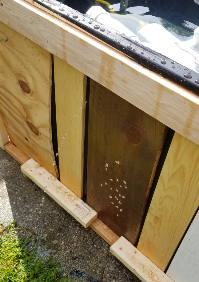

I sprung a leek in my pool lol
Re: X wing ROV
That amount of water weights a lot, so a small splinter can be enough. Nice to see your ROV in the water.

Just need 4 more pounds and it'll be perfectly weighted, only took 13 lb to sink it that's a lot of washer the 2 bottom runners will be full lol
Planning a trip up to northern Michigan in a couple weeks, have a cabin rented on the lake I think that'll be the perfect place to officially lake test it.

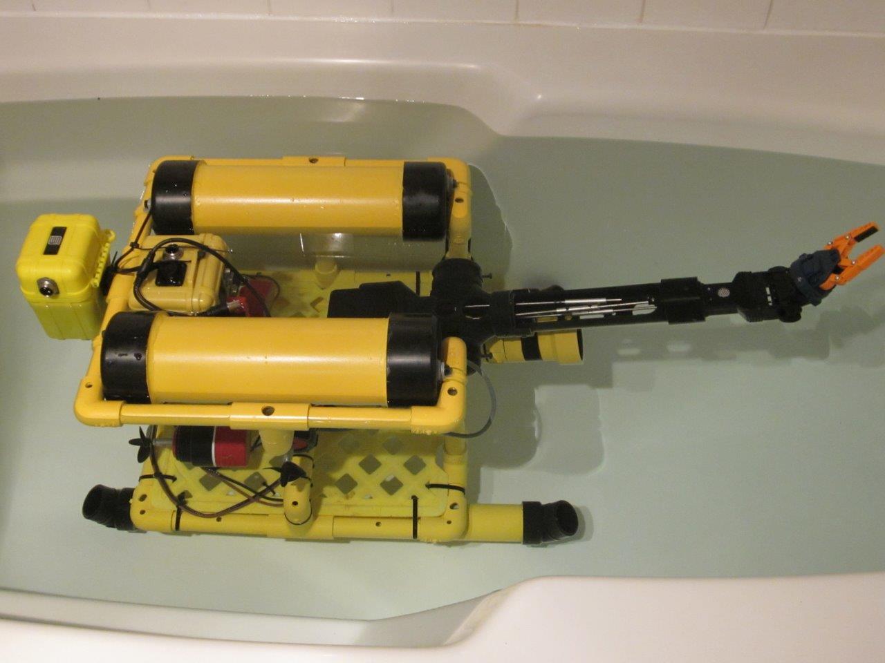

I did my ballast tests in the bathtub :P

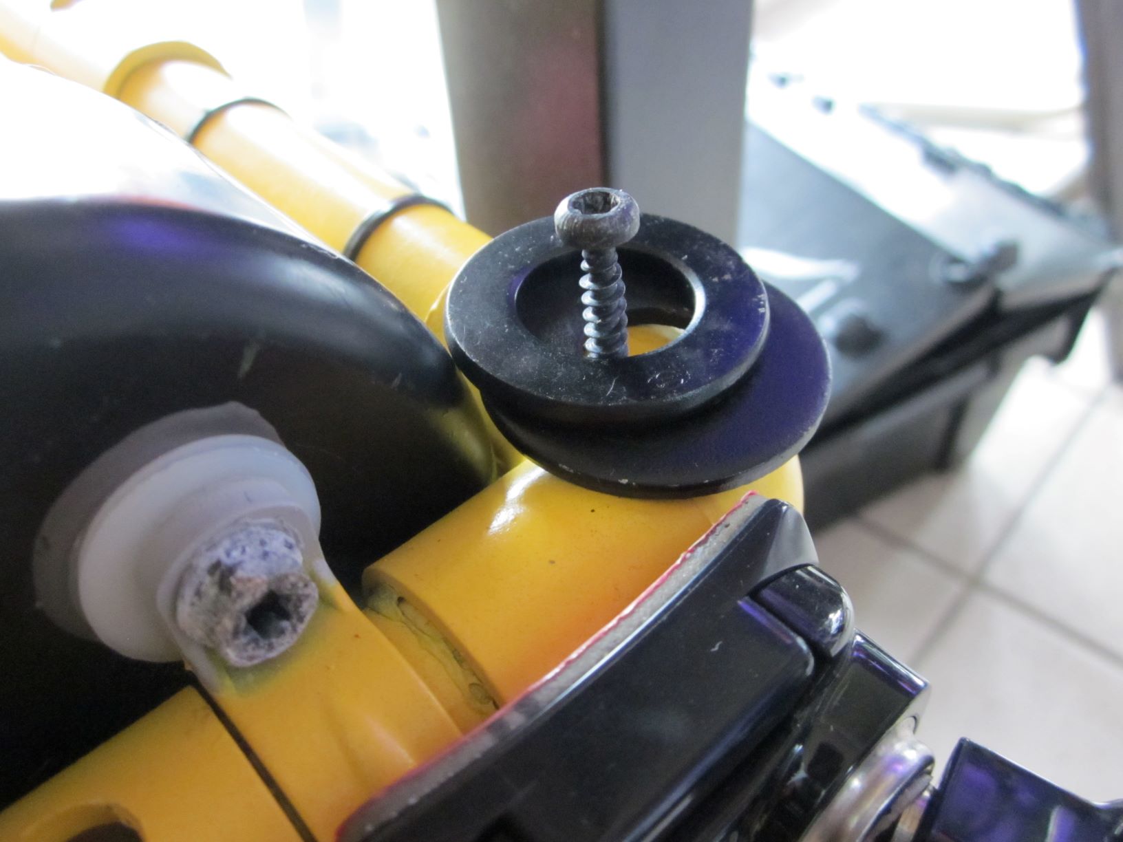

And to fine tune the ballast I put a screw on each top corner and added/removed large washers.

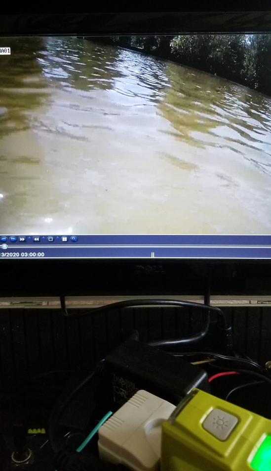

Mine was just a bit large for the tub I had to build a wooden frame and line it with a tarp and fill it. I thought it was dialed in but I guess I should've stopped with out adding the extra.
I'm pretty pleased that everything else went ok, couldn't see anything underwater really until it was sitting on the bottom then I could see on the camera. Might have to do with the IR and light kick back it'll be interesting to see in as pool.

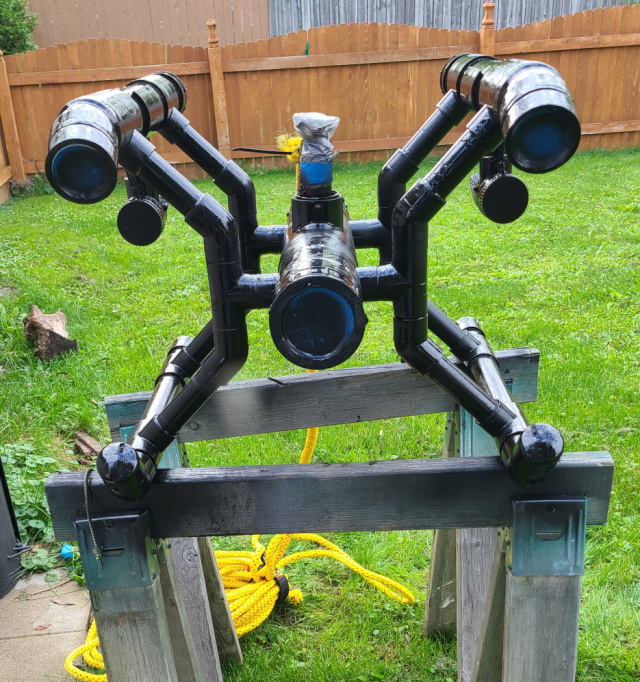

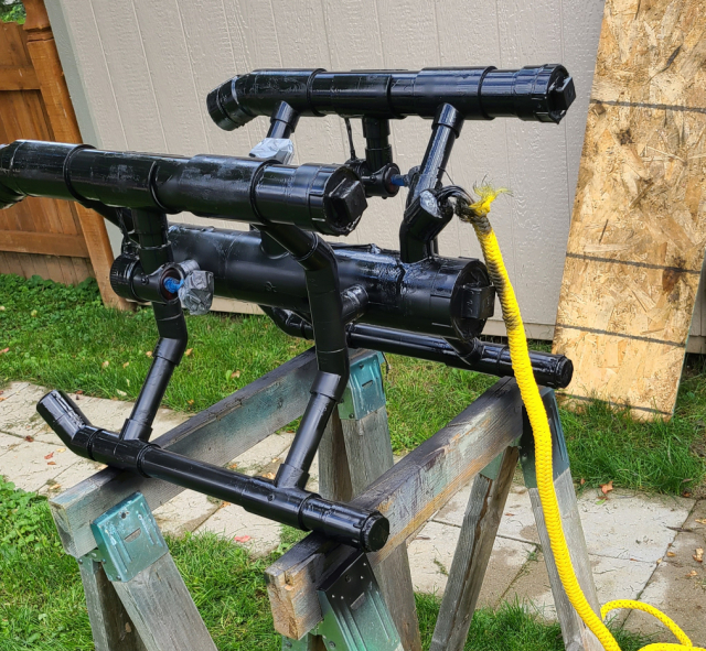

Monday I will sink it in the quarry, and hopefully it comes up lol
Excuse the blue tape covering the lights and camera.
I will be adding more color after the test dive.
