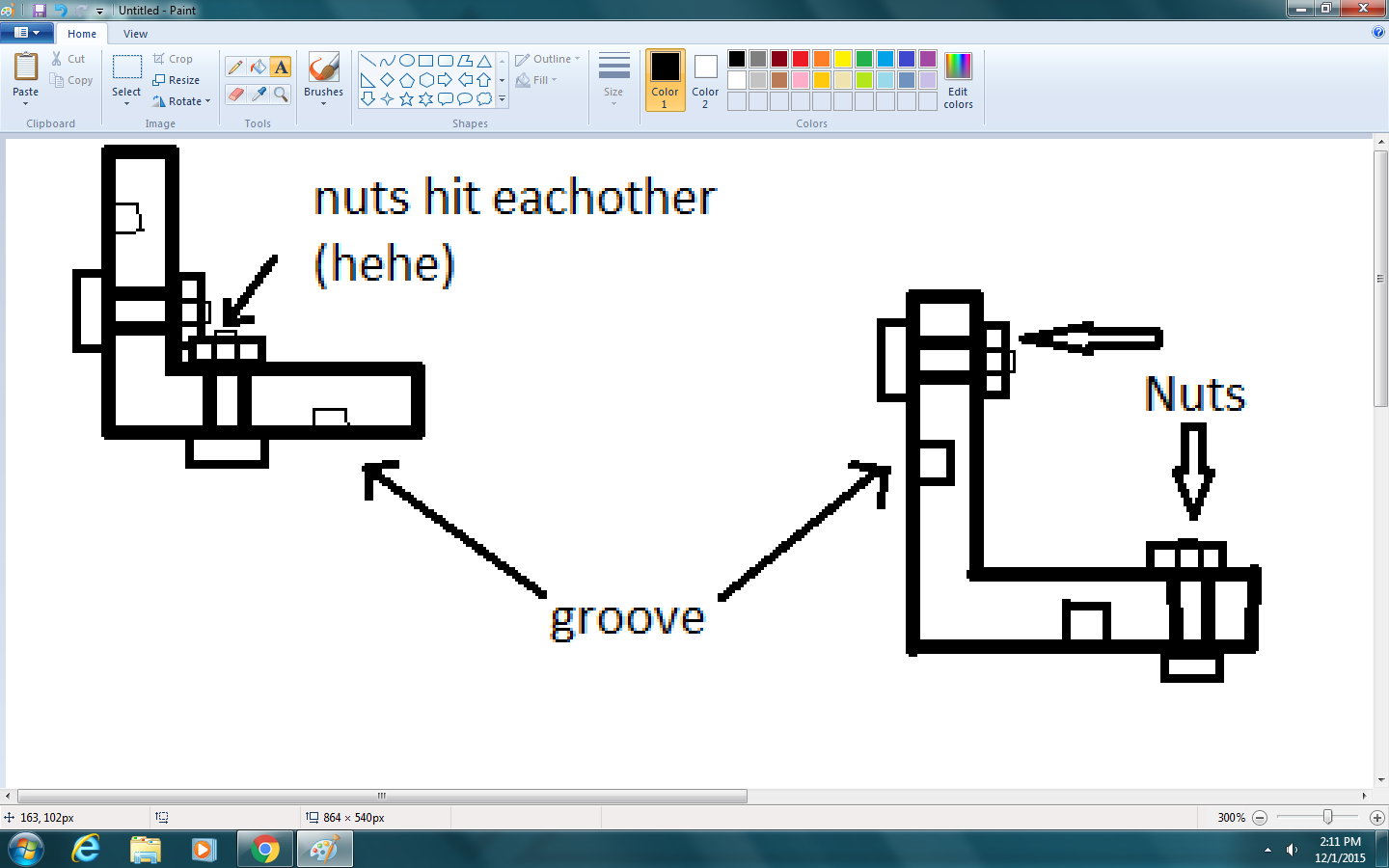

Which side of the seal should the bolt holes be on? I put them inside the groove because the inside behind the holes is recessed with a keyseat cutter for a nut if I move the hole too far outwards then the holes would not have enough clearance with adjacent nuts on other faces of the cube. (see picture)

Wrong side was a bit poorly worded perhaps, since with the current design the hole will make it in to the water tight container anyways. If you put them on the inside, each of the bolts must be completely waterproof. If you put them on the outside and make a design where the holes never penetrate the water tight container then they wouldn't have to be waterproofed. That's probably a better explanation of what I meant :)

Jaman42 wrote: Wrong side was a bit poorly worded perhaps, since with the current design the hole will make it in to the water tight container anyways. If you put them on the inside, each of the bolts must be completely waterproof. If you put them on the outside and make a design where the holes never penetrate the water tight container then they wouldn't have to be waterproofed. That's probably a better explanation of what I meant :)

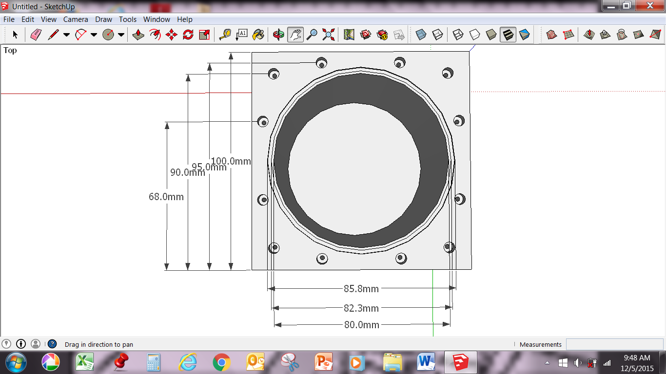

here is a schematic for the test cube face:
The o-ring groove is 0.712mm deep, and i'll be using a #042 o-ring.
I put three holes so that I could test weather just having four screws (one in each corner) would be sufficient, or if I needed eight (two in each corner).

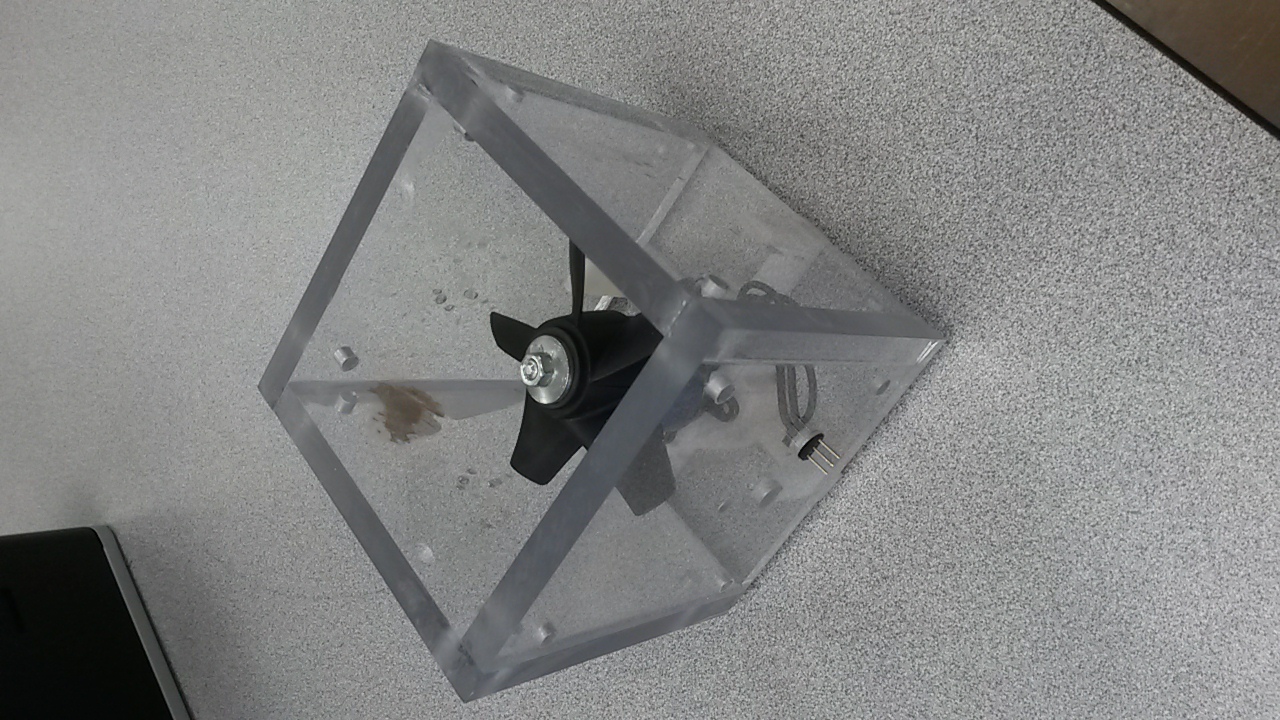

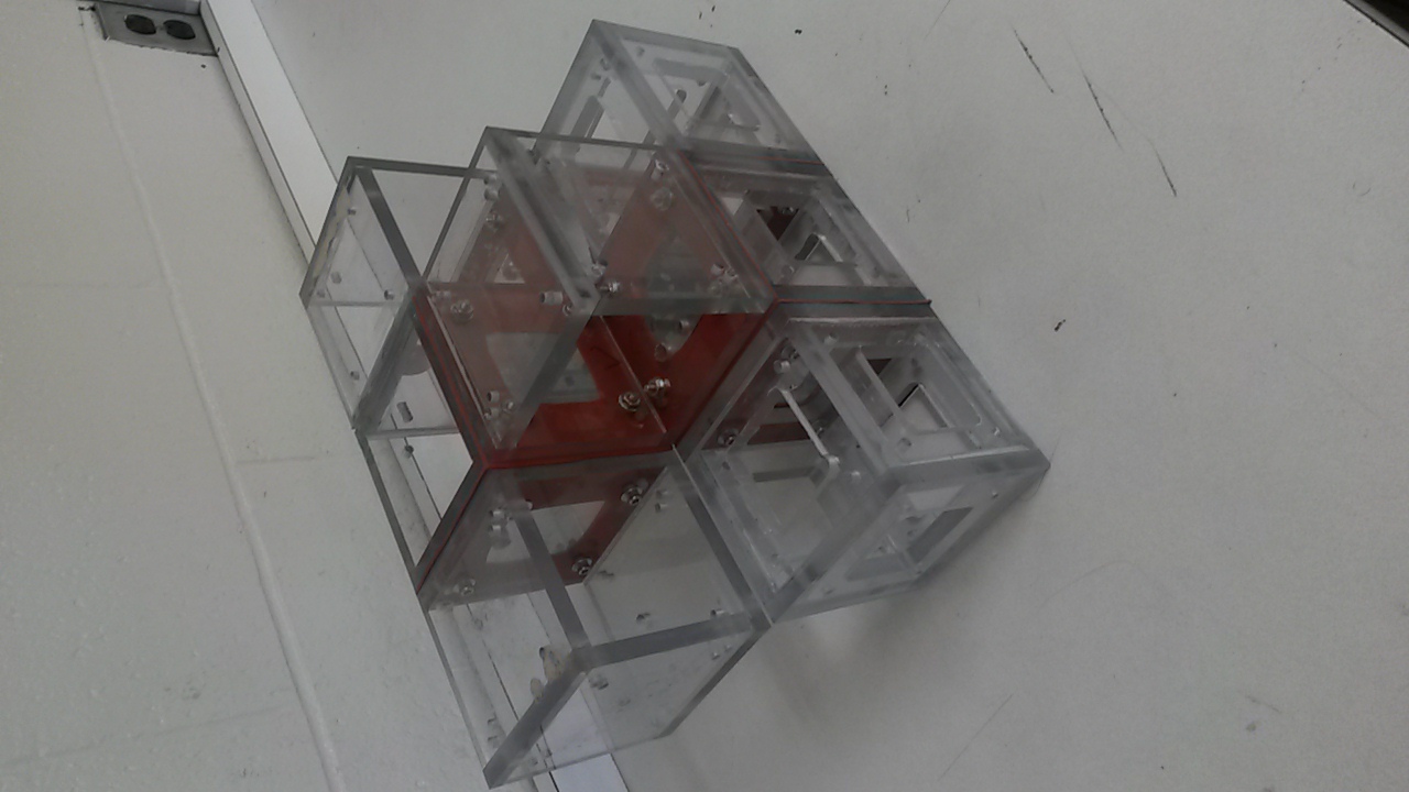

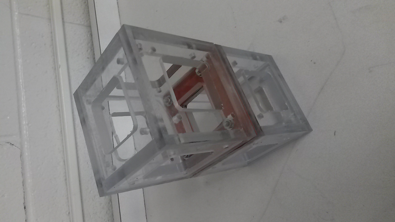

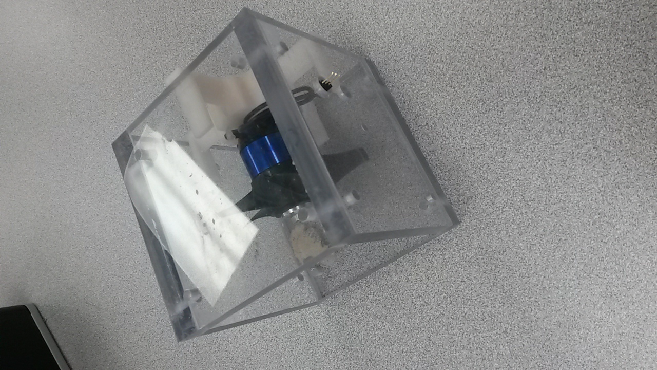

Here is my latest update after a lot of development: I have almost all of the cubes done; I ended up going wit 3/8" polycarbonate sheet which I CNC cut and chemically welded together for waterproof-ness and strength. Then I used 1/16" silicone sheet with a 40A durometer rating as a gasket for all of the cubes. The motors are mounted with a 3D printed structure into cubes with two faces missing so water can flow through freely. More updates to come :D

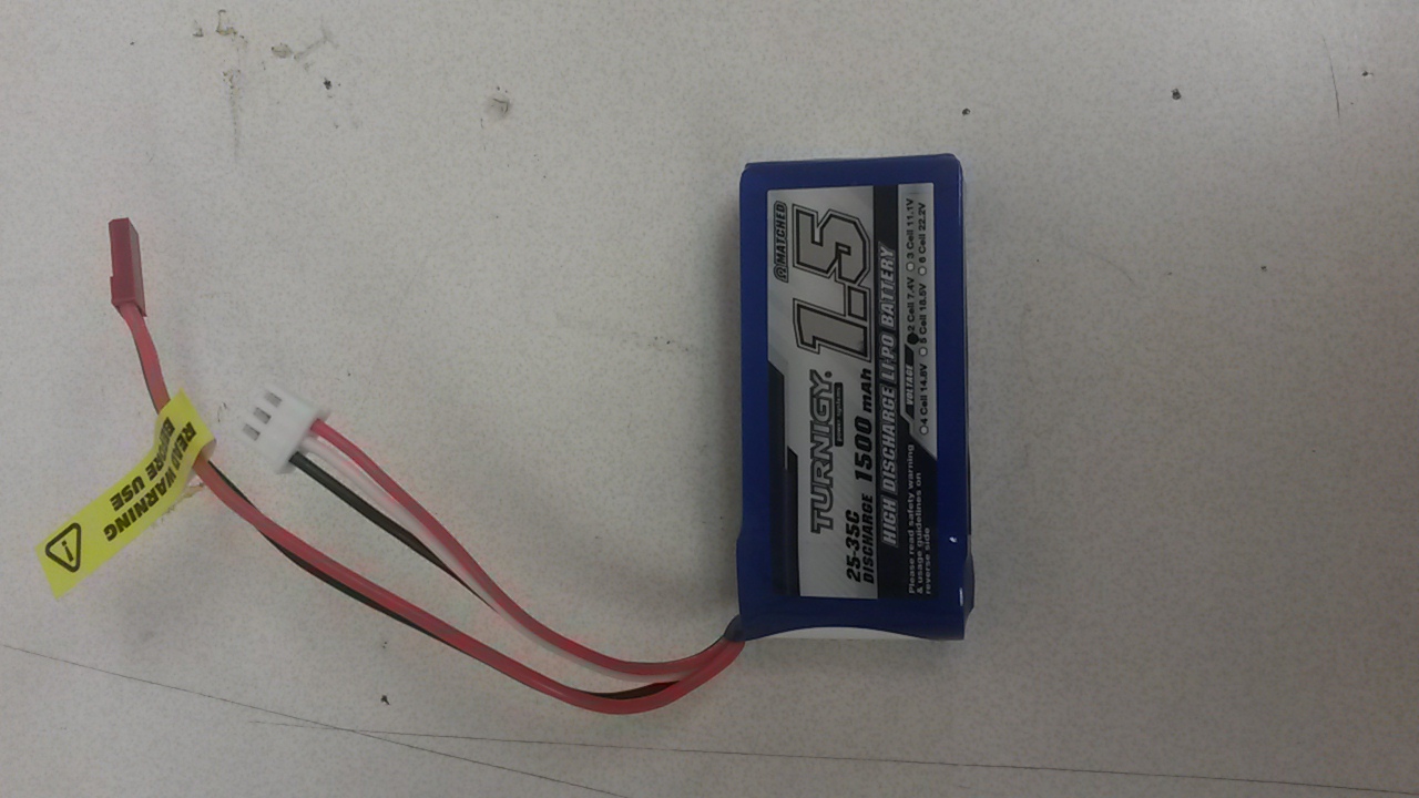

Here is the battery I'm using

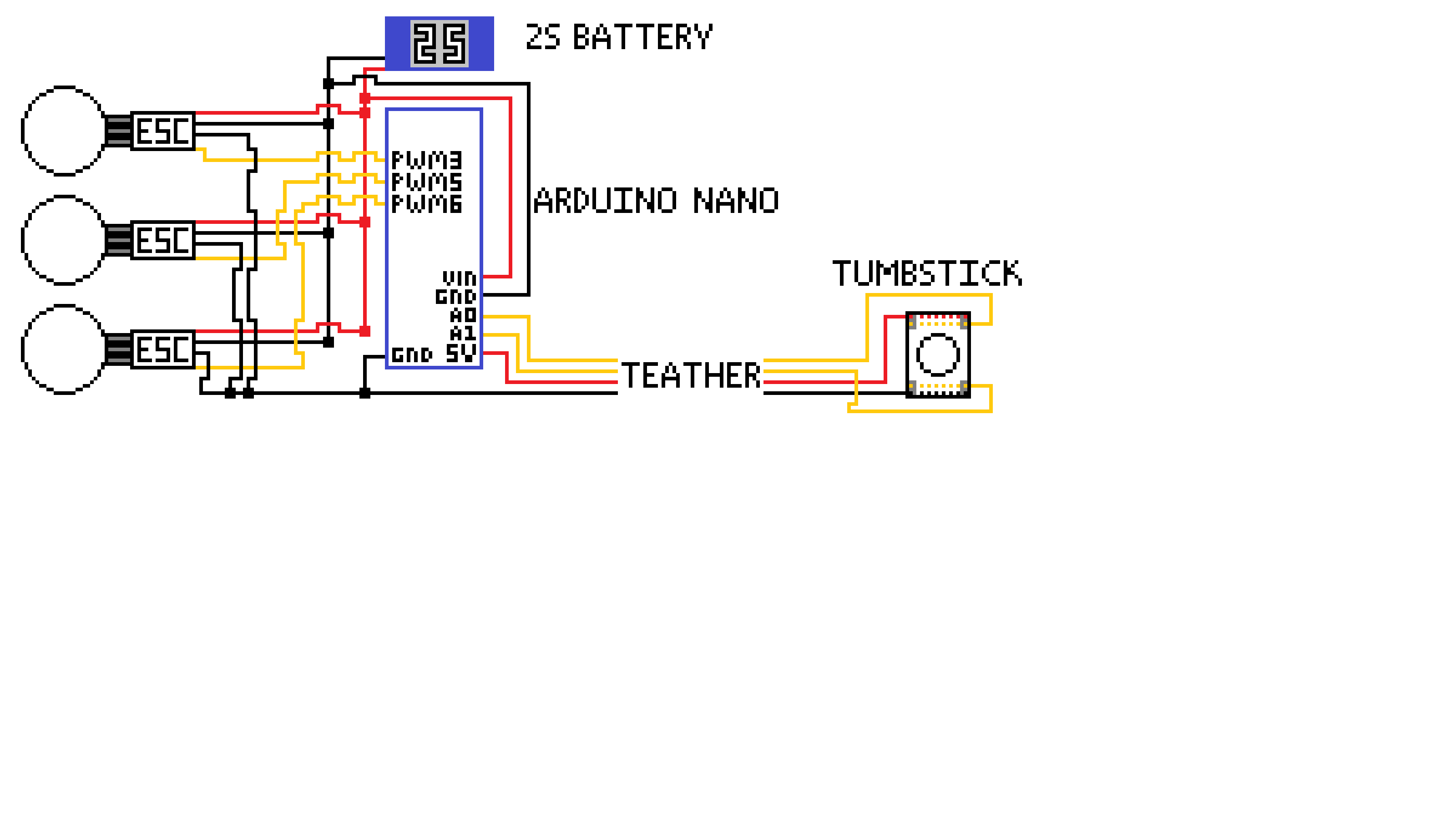

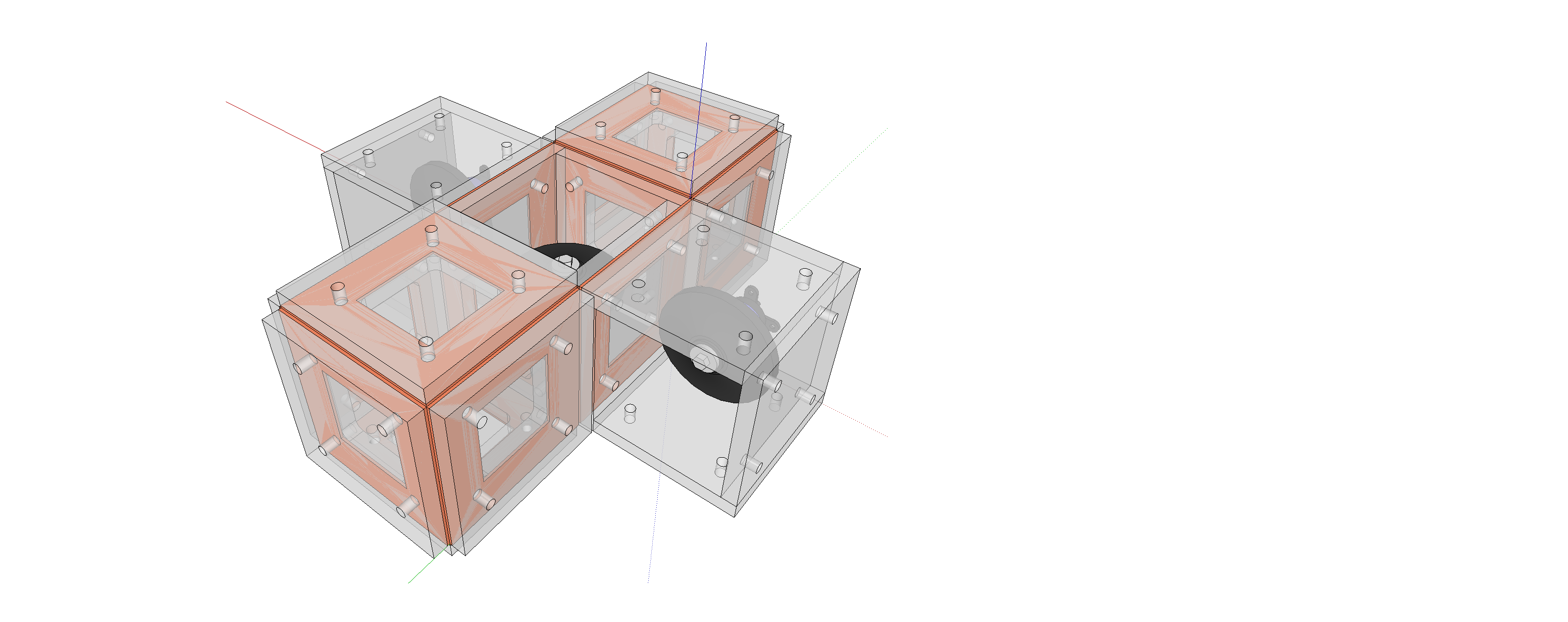

Hello fellas, life has gotten in the way of my ROV project for the last year but recently I've been able to put some work in. I am still pursuing the modular cube design. I like it because it allows me to adjust my design based on what I need at the time. In my current place I can't afford to finish the current designs with 12+ cubes, so I'm am now focusing on a 5 cube design as a proof-of-concept. Here is the configuration I'm using, and the wring diagram (excluding lights or camera setup). I have the standard three-thruster setup, the arduino/esc's will be in the front chamber, and the batteries will be in the back section.
