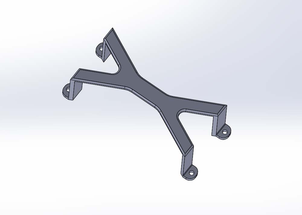

Re: Rov Reboot (3d Printed)
Slowly making progress, this is the simple Bracket that will hold the Relay box to the Main float.
I designed some recesses into the float so the mounts of the bracket will sit flush when screwed to the float. This will probably be a PITA to get it to fit right but I like the design challenge.

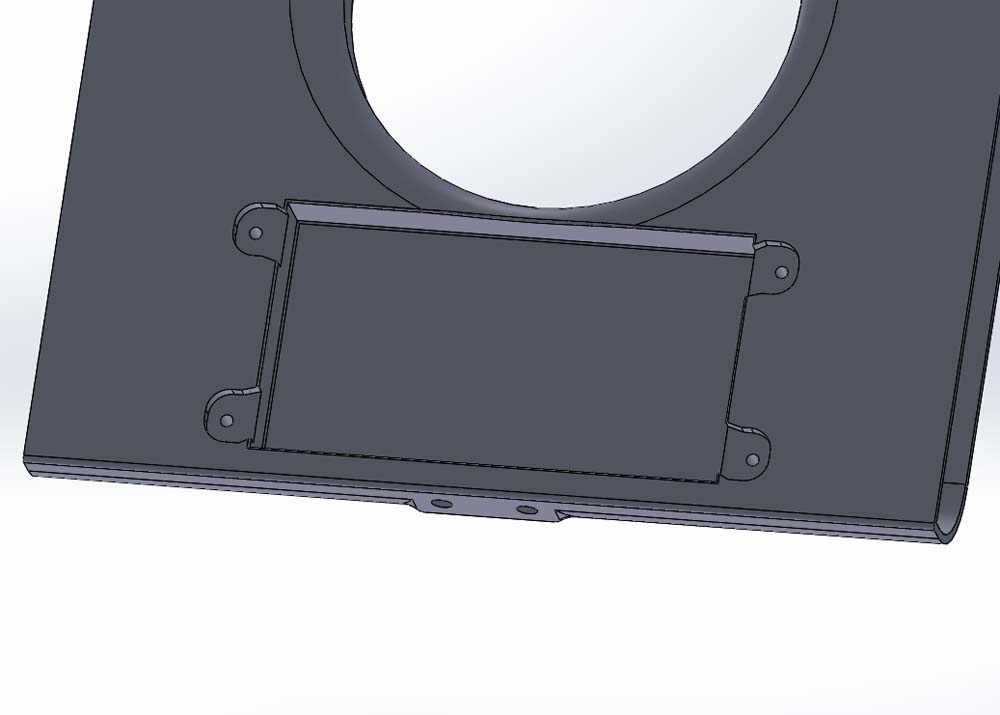

This is more or less what it should look like with the relay box mounted to the float.

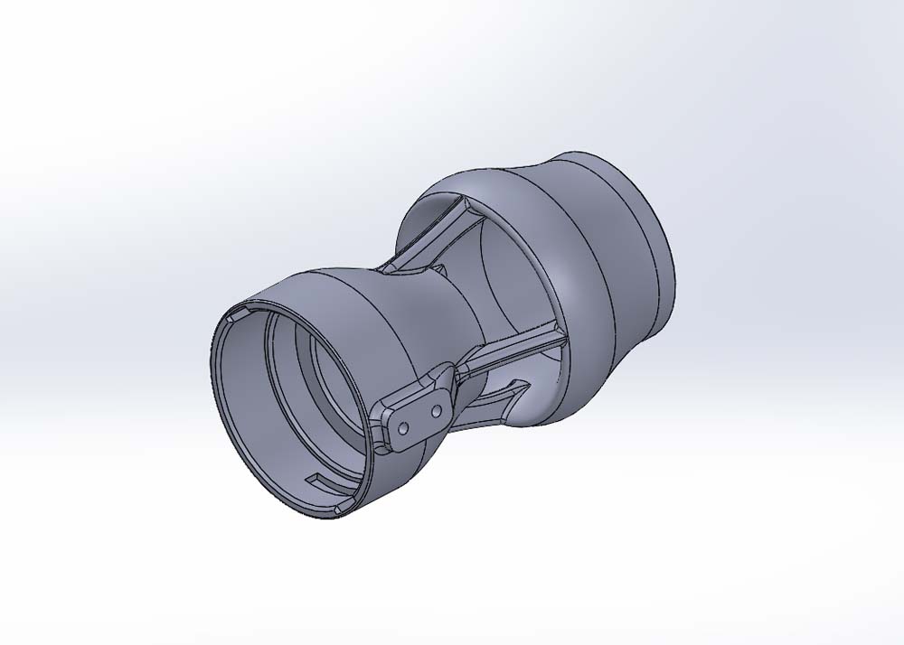

oceanrov31, give me a day or so to tweak some things on the Kort Nozzle Mount and I will post the stl. The adapters I use are custom machined, the specs are Shown Here.

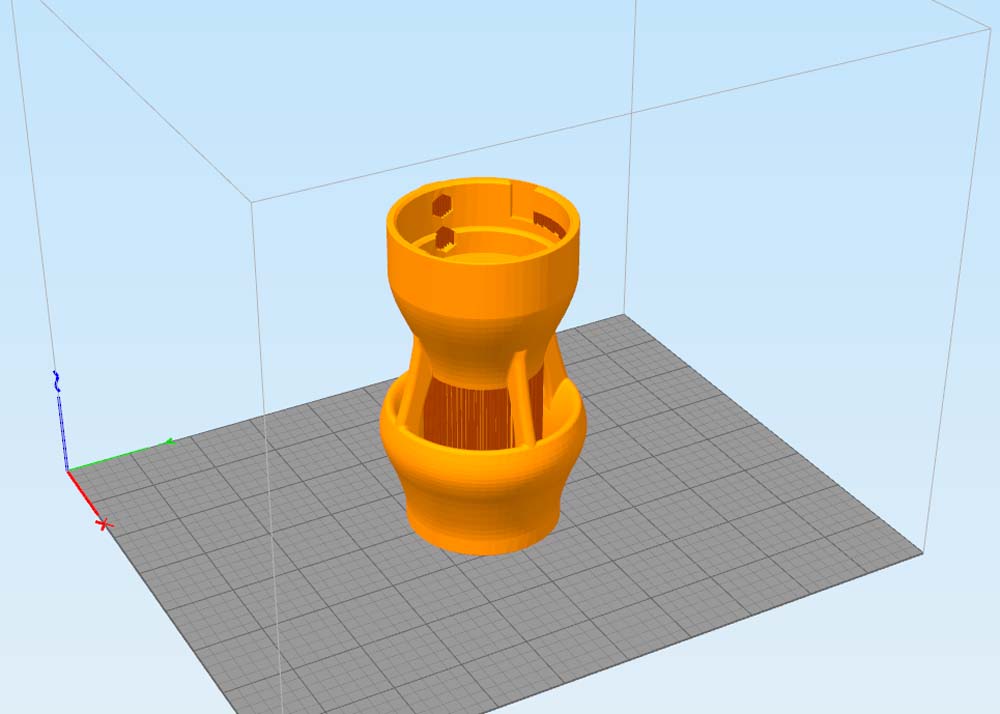

Here is the .stl of the Bilge Pump Thruster Kort Nozzle Mount. I printed it as shown above, printing in this orientation uses minimal supports, shown as dark orange in the picture.
Some fitment may still be required but it should be close. If it's a tight fit do not force the pump into the mount or the thin side walls may crack a little sanding with 80 grit sand paper is all it might need. Uses 6/32" Nuts and bolts for mounting.
I printed mine in ABS using Elmer's purple glue stick for bed adhesion.

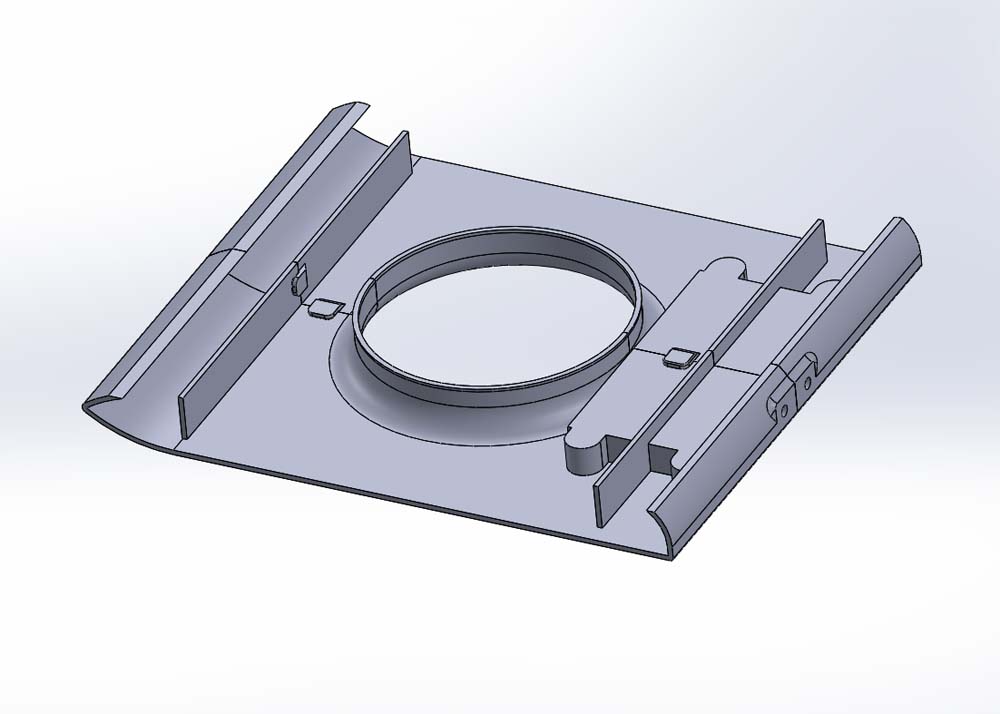

I made some more design changes on the float today. I'm going to try and print it in two halves and then join them together later. This will probably lead to more problems later on but I just don't have a block of 24 hours I can be home to babysit printing the whole thing at once so I'm going to see what happens. Above is the right side of the float, I chopped it in half and added some alignment tabs to aid it gluing it together later on.
This is a sectioned view of how the two halve "should" go together with the alignment tabs once printed.

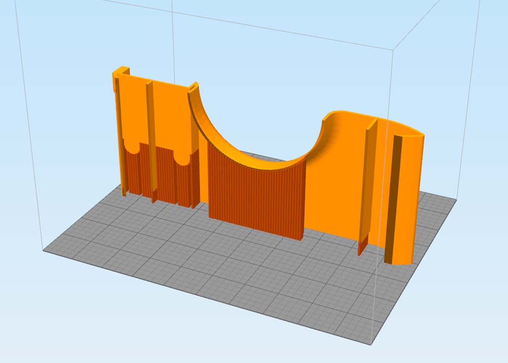

This is another section view this time in the slicing program showing the support material inside the float half. This half is going to take anywhere from 8-10 hours to print so we will see what happens come tomorrow morning.
