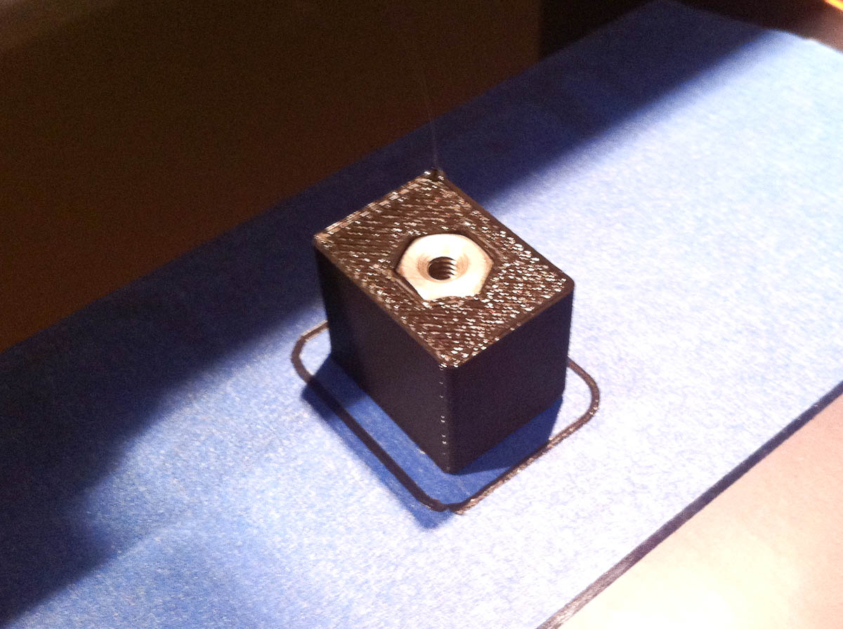

This is a 8/32" stainless steel coupler nut I will embed into the slider of the manipulator.
I have the printer setup to automatically stop at the right layer, the nut is dropped into the piece, and then the printing is resumed to full embed the nut into the piece.

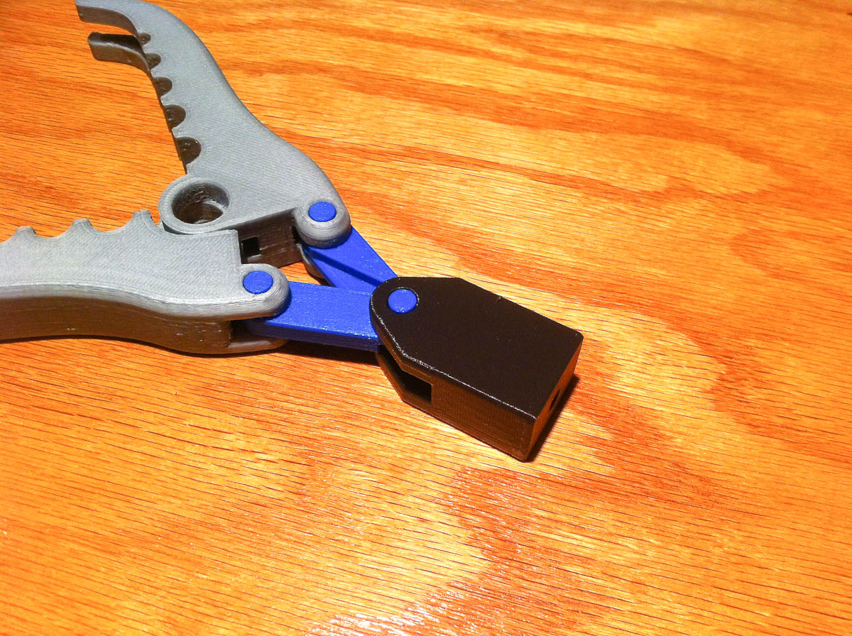

Here is the finished mechanics of the manipulator. Everything still seems like it will function as intended at this point.

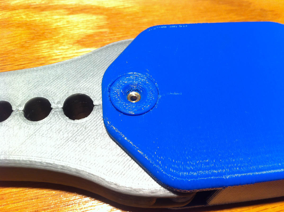

Next a 4/40 heat set insert is pressed into the main pin.
I simple printed washer and a single 4/40 flat head machine screw (I still have to get one) will hold everything together and will make changing out optional fingers pretty easy later on.

Looks good!
How did you get the printer to pause before you inserted the nut? Did you add the pause manually or can you configure it through the slicer software you use?
Re: 3D Printed Manipulator
olegodo, basically I manually edit the g-code to tell the printer to stop at the right layer so I do not have to babysit it for the entire print. I did a "How to" write up on another forum if you're interested, it can be found Here.
I use Simplify3D but I'm bet you can figure out the correct layer using other slicers.
