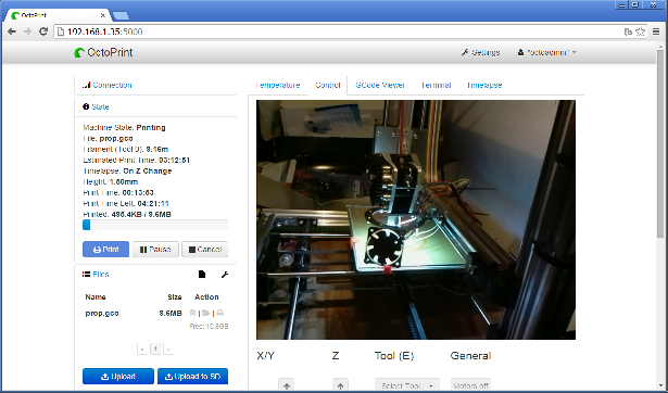

Re: Moki ROV (Another DUTCH ROV)
Got a little side-tracked
- print2.png (167.56 KiB) Viewed 6799 times
In my opinion, that's pretty much as on track as you can get when it comes to DIY stuff
grats!
Thanks...olegodo wrote:In my opinion, that's pretty much as on track as you can get when it comes to DIY stuffgrats!
And basically, its your fault... you supplied the "PrintProp" files (btw: thanks for that, again)
