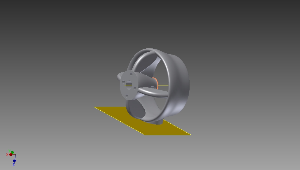

Here is what I have so far for my D2836 Turnigy motor. It is made for a 60mm prop cut down to 50mm.
Rice Nozzle design
Rice Nozzle design
Rice1 full.jpg (88.67 KiB) Viewed 11076 times

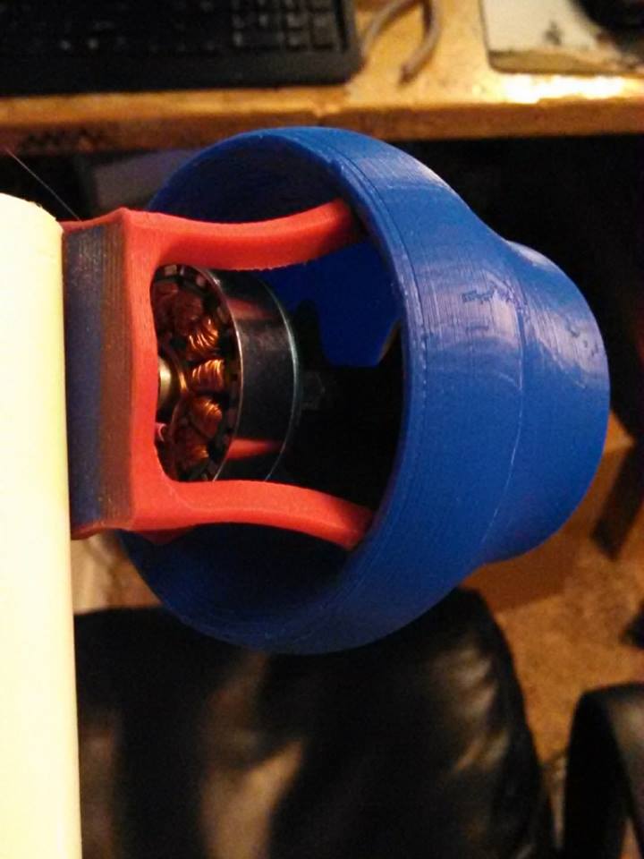

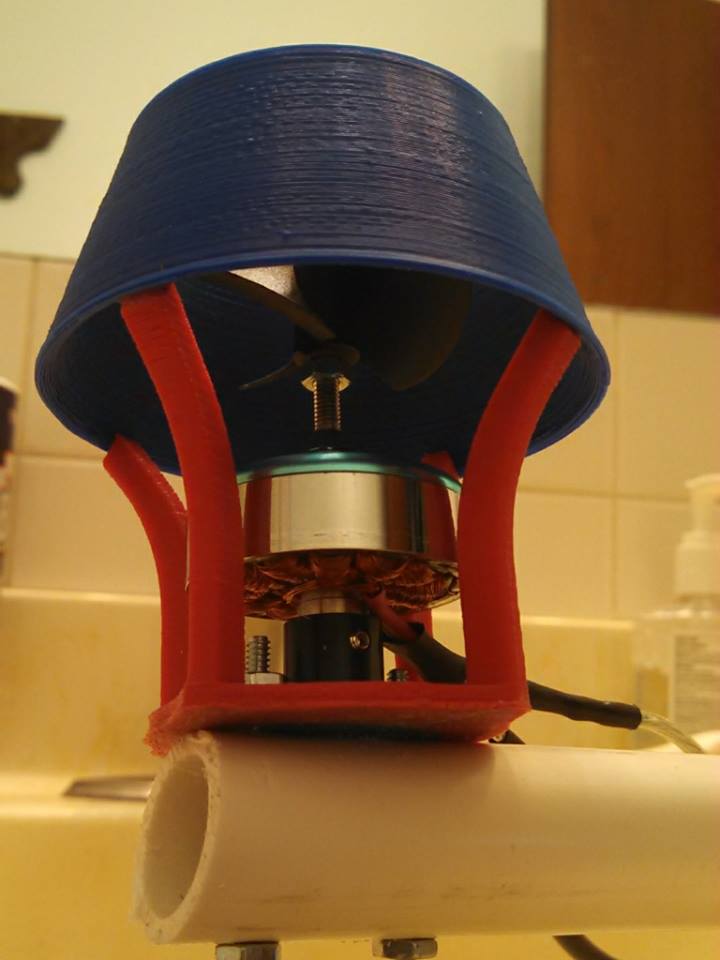

I actually printed a kort nozzle today (No particular shape, just thought it looked right), it is cambered and it's more than tripling my thrust output. I'm using a 700kv out runner with a 40x57mm prop. Before my nozzle I was measure about 2.1lbs (.95kg) of thrust to 6.6lbs (3kg). (Please keep in mind I'm using a sub-par baggage scale, but it did feel about right) Of course that's only in one direction I haven't yet measured reverse. I did read on Wikipedia that a NACA 4415 airfoil works well, I'll give that a try tomorrow.
As of right now, I'm trying to figure out if there are any feasible bi-directional nozzles out there, so far no luck. The only thing I can think of is a straight tube that just keeps the stream together.
Also, if anyone wants to send me airfoil's to try out I am more than happy to print them and do some testing.

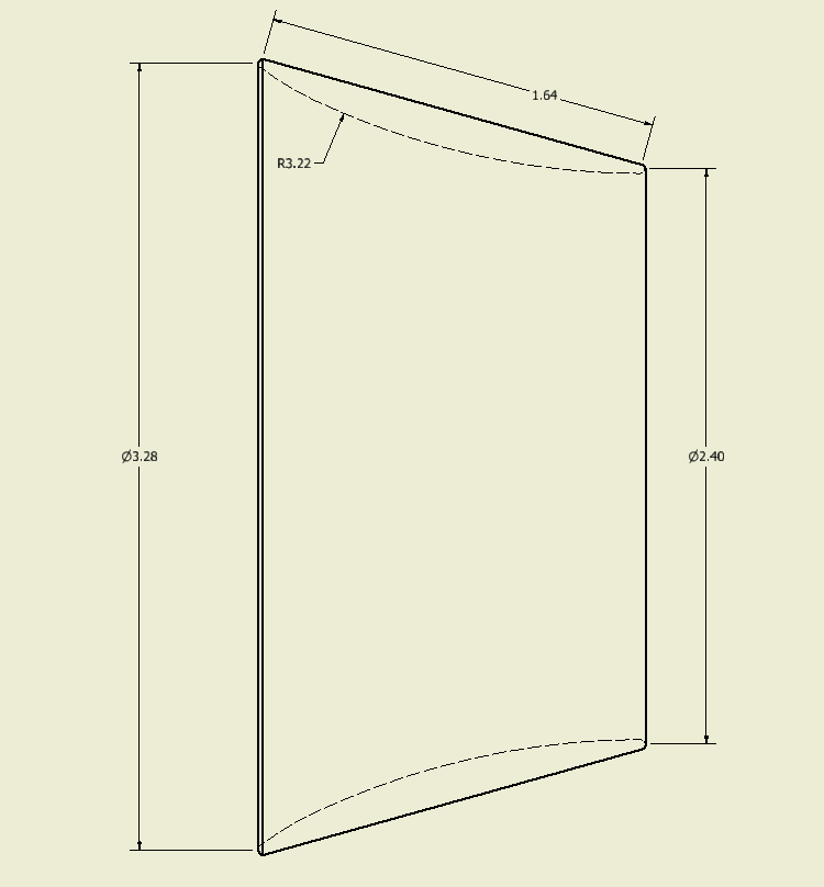

This is the cross section for the nozzle I tried. I had decent results.
kort controll cross.png (17.81 KiB) Viewed 11000 times

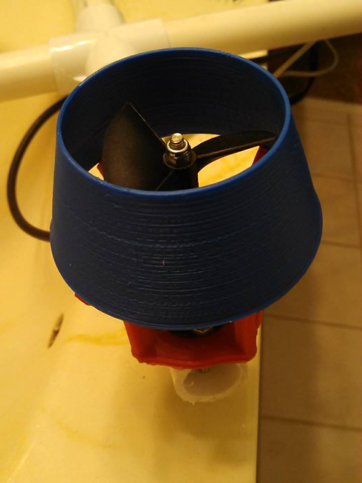

Moving forwards or, in this case back, I may have misled you all. I found my better luggage scale and retook some measurements, here's what I found:
Without a nozzle:
  • Forwards - 3.60lbs (1.63kg)
    Reverse - 2.03lbs (0.92kg)
With my arbitrary nozzle:
  • Forwards - 6.00lbs (2.72kg)
    Reverse - 2.00lbs (0.91kg)
And finally with the new Rice nozzle I pulled:
  • Forwards - 5.00lbs (2.10kg)
    Reverse - 2.6lbs (1.2kg)

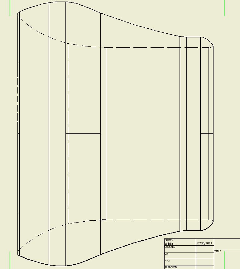

For the Rice, I traced it out as best I could in CAD, referenced from the patent drawing posted by scubersteve. Tomorrow I'll try out the NACA 4415. I've heard good things from Wikipedia, and it seems to be the most referenced airfoil (Hydrofoil?) that I could find. Although I really have no idea about angle of attack, so I'm just going to go off of the illustrations I could find. If anyone has any other suggestions please let me know.
I guess this is my life now, printing and testing kort nozzles. Oh well.

This is the cross section of the Rice nozzle I tried out.
the layers of the print didn't stick too well, and the first couple (the downwind section) but I think it's still an accurate test.

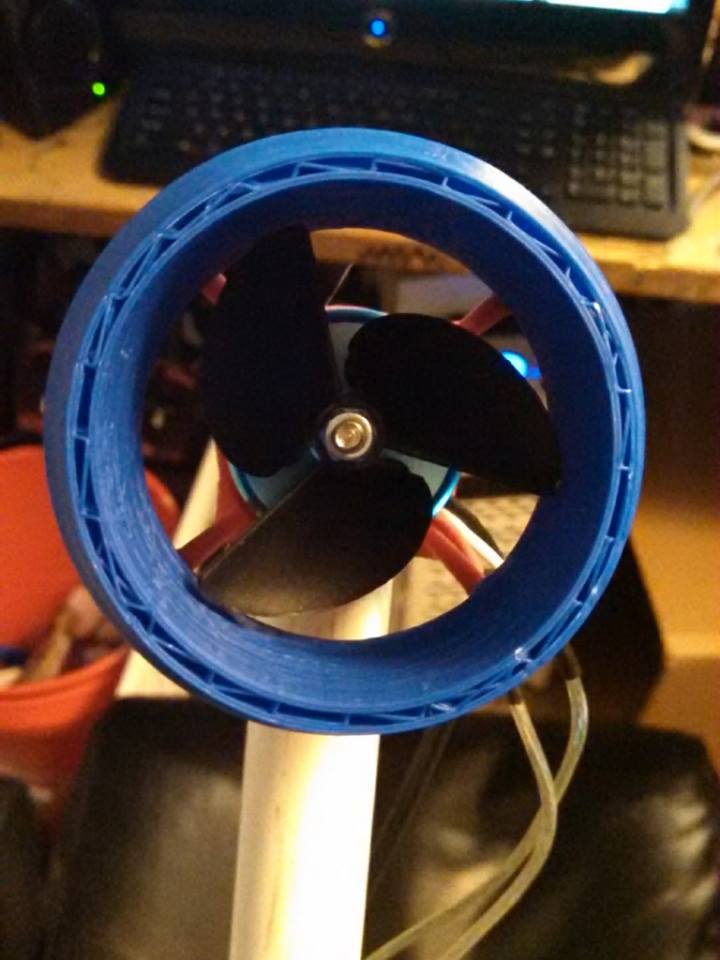

Today I wasn't able to get around to the NACA 4415, but I did try out a shorter variant of the Rice nozzle. Seeing as how so many different companies, individuals, and suppliers have such short nozzles. So I've shortened the Rice from it's original 2.5 inches (6.4 cm) to about 1.2 inches (3.1 cm). So far this has proven very ineffective:
  • Forwards - 4.08 lbs (1.85 kg)
    Reverse - 2.34 lbs (1.06 kg)
That being said I might do a retest of the shorter rice as I had a larger gap around the blade than I would've liked. So to be continued, I will try my hardest to get both of those tests in.
