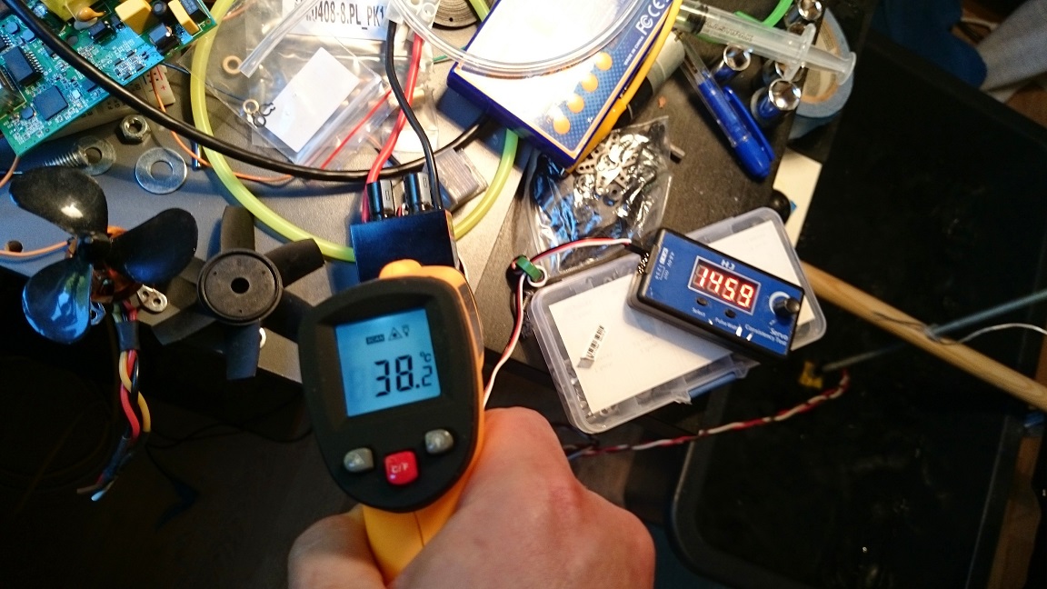

Temperature of the 50A ESC after all the testing and running at 50% for 20mins.<br />Note that this is without cooling and an ambient temp of 28c

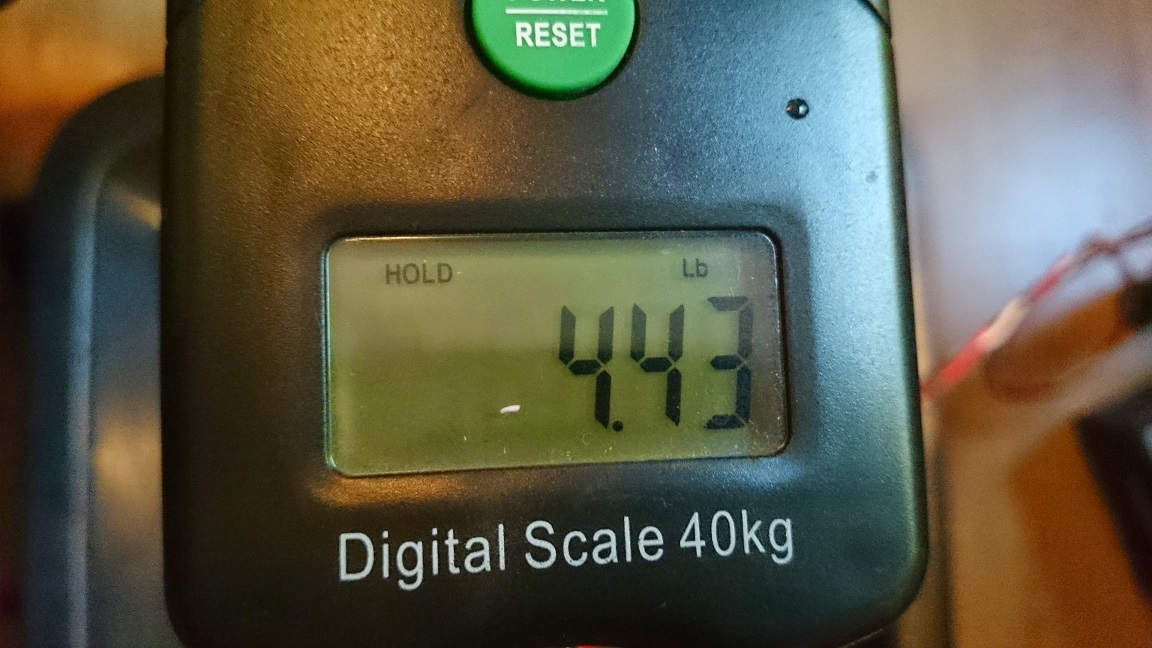

Close to max speed. pushing around 2kg (4,4lb). I have no idea what amps I am pulling here though. In reverse it managed around 0.9kg.

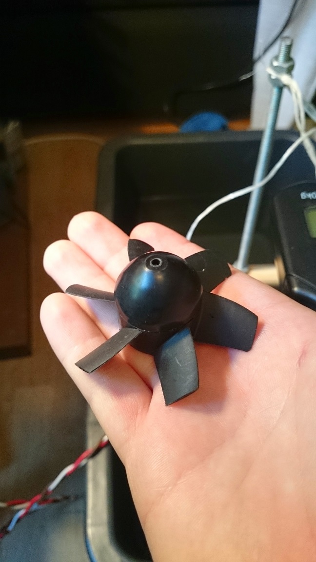

How the original fan/prop looks. 6 blades with way too steep angling.

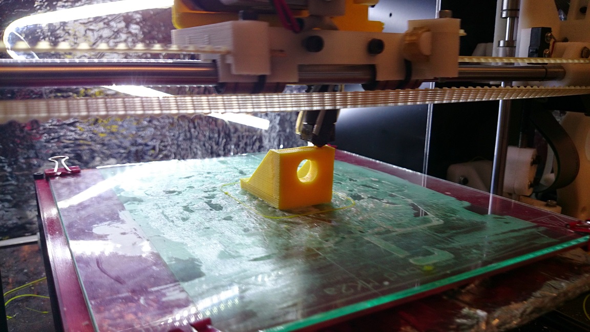

Had to print a piece to mount the EDF fan to my test rig.
