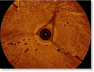

Far out - enjoyed the webpage. Some info on the ebay page too. I've been looking up SONAR stuff using different keywords in Google. Found alot of info but not come across that site before. Thanks.
That array in the fish on the website is oriented the "right" way for what I am doing/want to do. Will produce a "beam" that is narrow in azimuth but wider in elevation. If you spun the fish around so the head pointed north, east, south, west, and show the echoes as an azimuth-time plot on a polar display it would produce an image similar to the one below.

a_shorething: Yeah, I like that image, especially the shadows. The scanner or array needs to be on a stable-ish platform. Looking at some fishing forums I read comments noting calm conditions. With an ROV though, down below the influence of waves, I think the only thing to be concerned about is maintaining a steady heading. If the beam is narrow and the ROV yaws, some echoes will be missed. A wider beam will be more forgiving, though of course less detail. Initially I only wanted to identify navigational reference points such as pilings, and maybe get a bounce off a mooring chain or mooring block and maybe some stuff on the bottom. No way though will I be hoping for anything of such detail as that picture.
