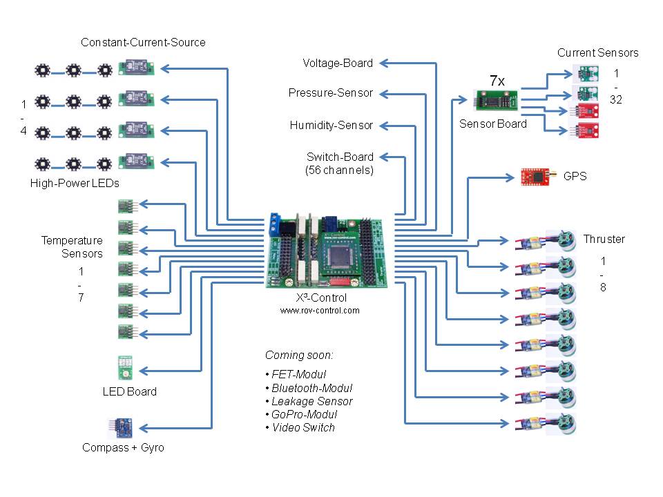

by ROVER3D
overview of X³-Control modules

Can I ask how you would hope to implement a gps receiver using this board? An antenna at topside?
Re: ROV-Control V3
Posted: Nov 15th, 2013, 8:01 am
by ROVER3D
For GPS you need a GPS-Receiver with seriell interface and NMEA-Protokoll. The X³-Control does not have an own receiver onboard.
GPS is only available on surface. So you can relocate findings after the position determination.

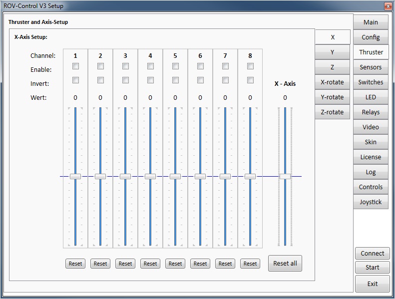

Is this all PC driven? No joystick control. Will it work with MAC?
Chuck
Re: ROV-Control V3
Posted: Nov 15th, 2013, 12:24 pm
by ROVER3D
Sorry, at the moment the software only works with windows XP or higher (recommend Windows 7)
For control you need a usb-joystick or gamecontroller (recommend 3-axis joystick e.g. Saitek X52 pro)
The software is designed for HOTAS (http://en.wikipedia.org/wiki/HOTAS).
For configuration the thrustersetup supports 6 axis to eight motor-channels. You can enable each channel to an axis and setup direction and power of each channel.
There will be many updates next time with new functions, sensor-interfaces, modules and of course you can add your suggestions for features to the ROV-Control Forum visit http://www.rov-control.com/forum/en/

Feel free to test ROV-Control V3 (beta)Demo for Windows XP/7/8
Please check System Requirements before installation!
http://www.rov-control.com/wiki/en/inde ... stallation
We are working on documentation and wiki...
Re: ROV-Control V3
Posted: Jan 15th, 2014, 3:32 pm
by Oldsirhippy
That is a very nice piece of setup software - I look forward to using it with one of your boards! :D
It worked fine in windows 8 up to my pressing exit.
