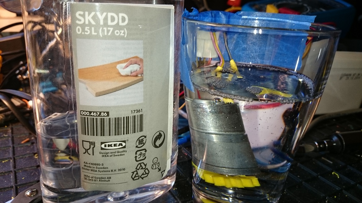

Small update.
Found some really cheap clear mineral oil at IKEA called "SKYDD". It is used for treating wood furniture and comes in 0.5l bottles.
So I filled a glass with oil and submerged a motor in. This time I let it sit for a while, and did what I could to shake all the air out from the motor.
Also I am only running the motor at 5v this time. I do suspect that they really can't handle the 12v they are rated for over a longer time.
It has now been sitting in oil for 3 days and running on 5v for 6-7 hours on two of the days. So a total of 12-14 hours of running in the oil.
So far I can't observe no change what so ever. The motors sounds the same as when I first started and there is no residue in the oil.
So this looks much more promising
Attached a picture of the motor submerged in oil. There is a printed gear glued to the shaft of this motor.

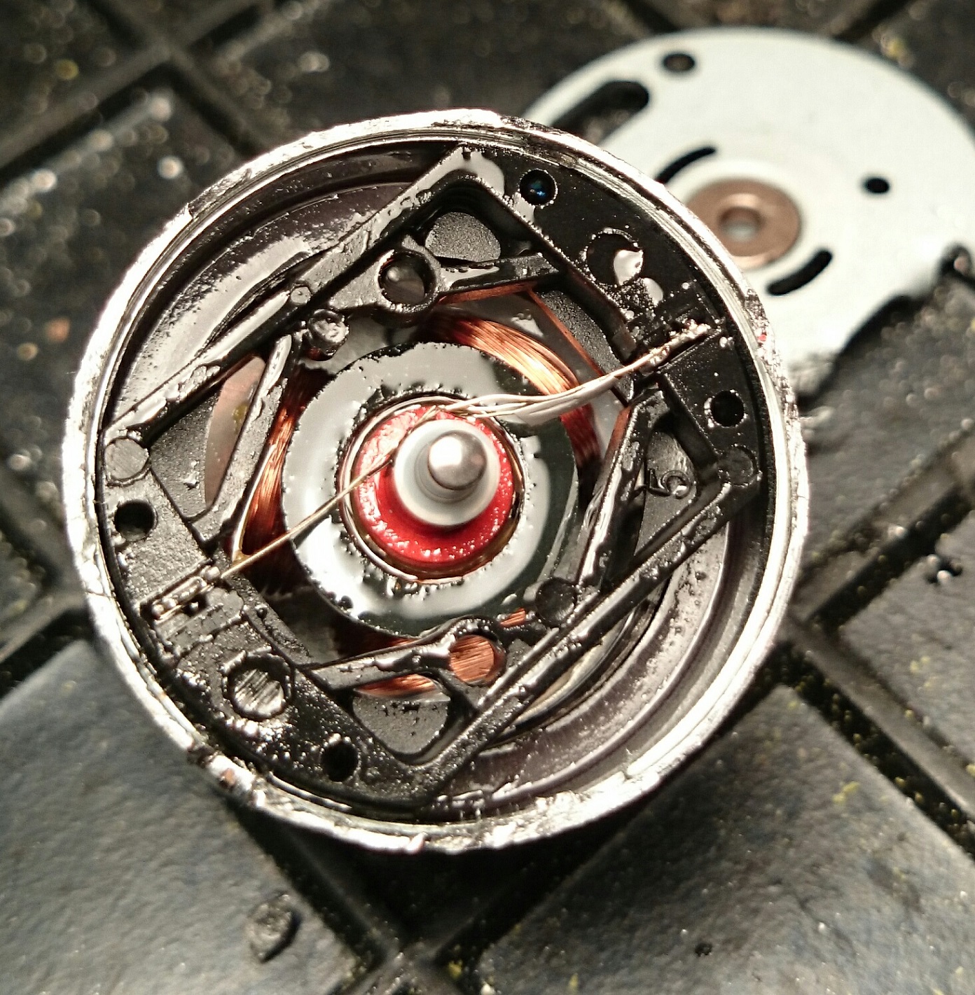

Update:
Eventually this motor also stopped turning. I don't exactly know when it happened, but some time during day number 4.
I opened the motor (had to really force it open) and discovered that these don't really have brushes, but just some copper/brass "arms" that contacts the rotor (?).
It seems that one of the arms has been forced over to the wrong side of the rotor. Maybe the oil ads friction?
There were no sign of wear at all other then the bent arm.

Pretty interesting, thanks for reporting your tests.
