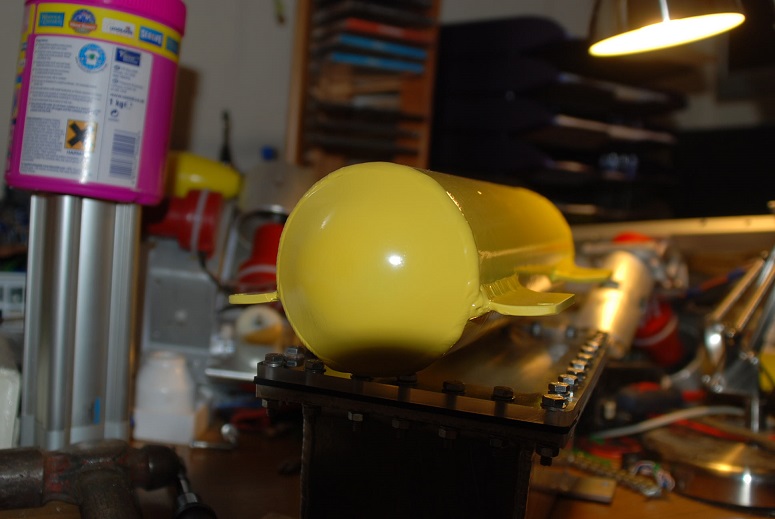

well at least the float is done.
- DSC_0021.JPG (121.59 KiB) Viewed 3236 times

Nice welding there hazzyb.
that box looks like a pro ROV valvepack.
