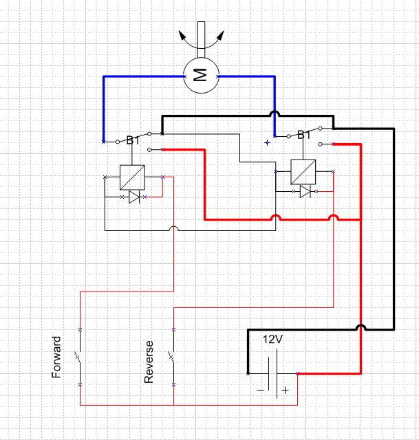

You do only need two single pole to connect one thruster. I can upload a shematic if you are interested.

I use this shematic for my ROV with a single pole relay.
ROV control.jpg (88.85 KiB) Viewed 11637 times
Then you can control one motor both ways with use of two control wires down to ROV.
You can find cheap single pole relays on this page http://www.taydaelectronics.com/mini-re ... ntact.html Only 0,64 UDS each. I have use these for my designs and they work perfect. Fast shipping as well.

Thank you for the suggestions, and the wiring diagram. The concept of using single pole relays is an intriguing one, however I shall need to look at that wiring diagram more closely to see if it is a suitable one, not being able to read them fluently it shall take me a while but it might be something well worth considering.
