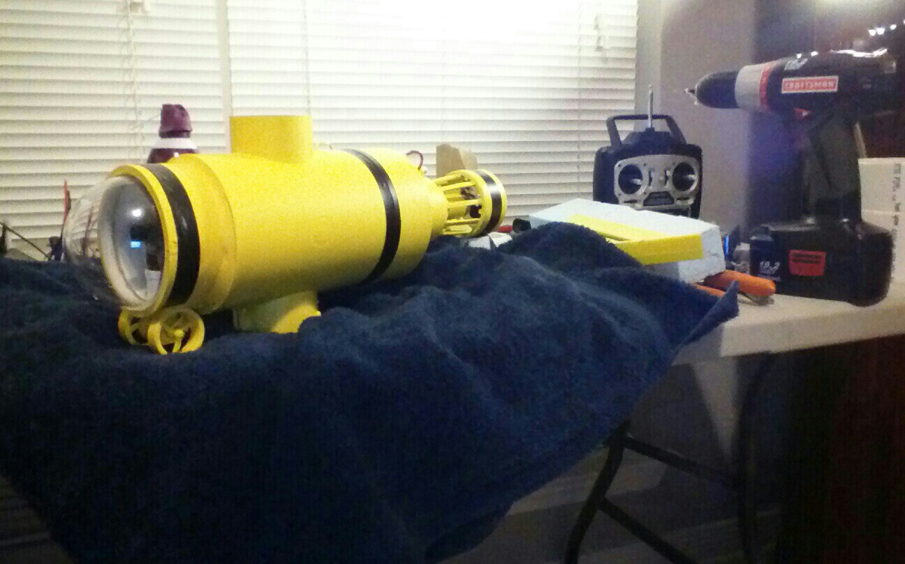

Camera(32) (2).jpg (181.11 KiB) Viewed 6488 times
I don't care for the plasti-dip as a rov coating.
It goes on too thin like spray paint and doesn't adhere very well.
Anyway, I did a little bathtub testing last night and didn't find any leaks.
Today I have to make up 13 ounces of ballast to get it trimmed out properly.

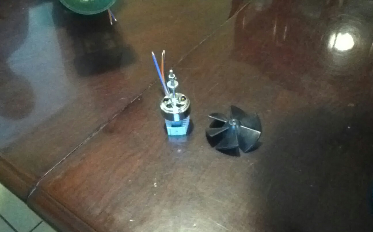

I'm in the process of replacing the vertical and horizontal thrusters with brushless motors and switching the control system over to a
ppm-to-pwm converter and using a tether. I found some nifty new props too.
The danger in trying to build something as cheap as possible is going too cheap. (which is what I apparently did the first time around on this project)
I guess this is Guppy 2.0
I'll post some updated pictures soon.

Re: The Guppy
Posted: Jul 2nd, 2013, 8:00 pm
by scubersteve
I like the look of your rov Ross. Why don't you have a build log going for it on here? I for one would like to see more of it.
That under ice unit you linked to was kinda crazy. As you said...taking through-hull thrusters to the extreme.
I really rather like my layout on this build with the through-hull vertical thruster and single horizontal thruster.
You can drive it like a car. Anyway, some new pics of my updated thrusters.

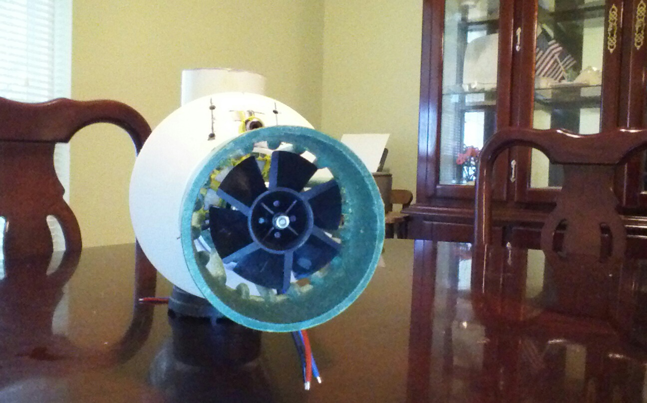

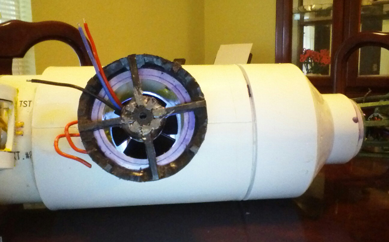

Re: The Guppy
Posted: Mar 9th, 2014, 11:07 pm
by scubersteve
Having to redo the Guppy...again.
The brushed bow thruster arrangement wasn't working out so I'm changing to a tank-drive setup.
I hope to have it back in the water by the end of the week.

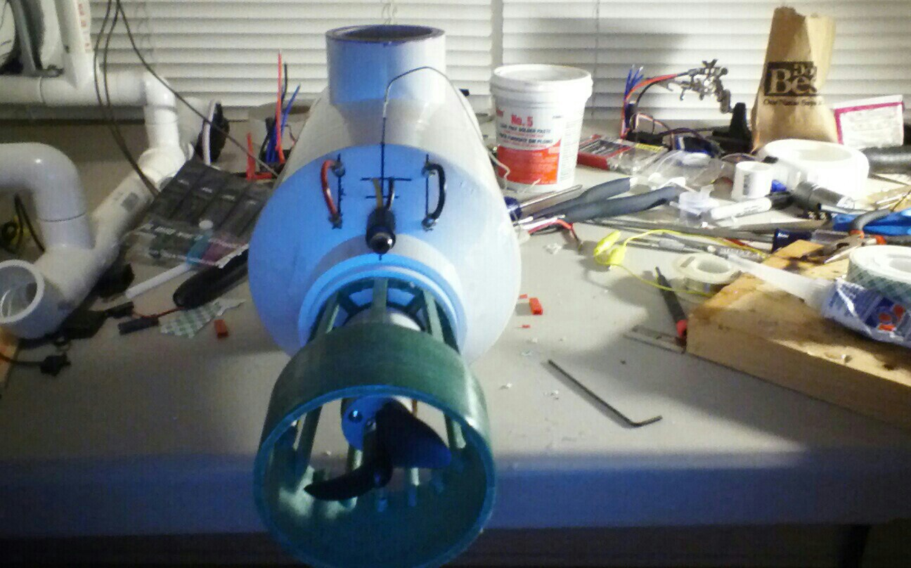

Re: The Guppy
Posted: Mar 9th, 2014, 11:09 pm
by scubersteve
Front view
