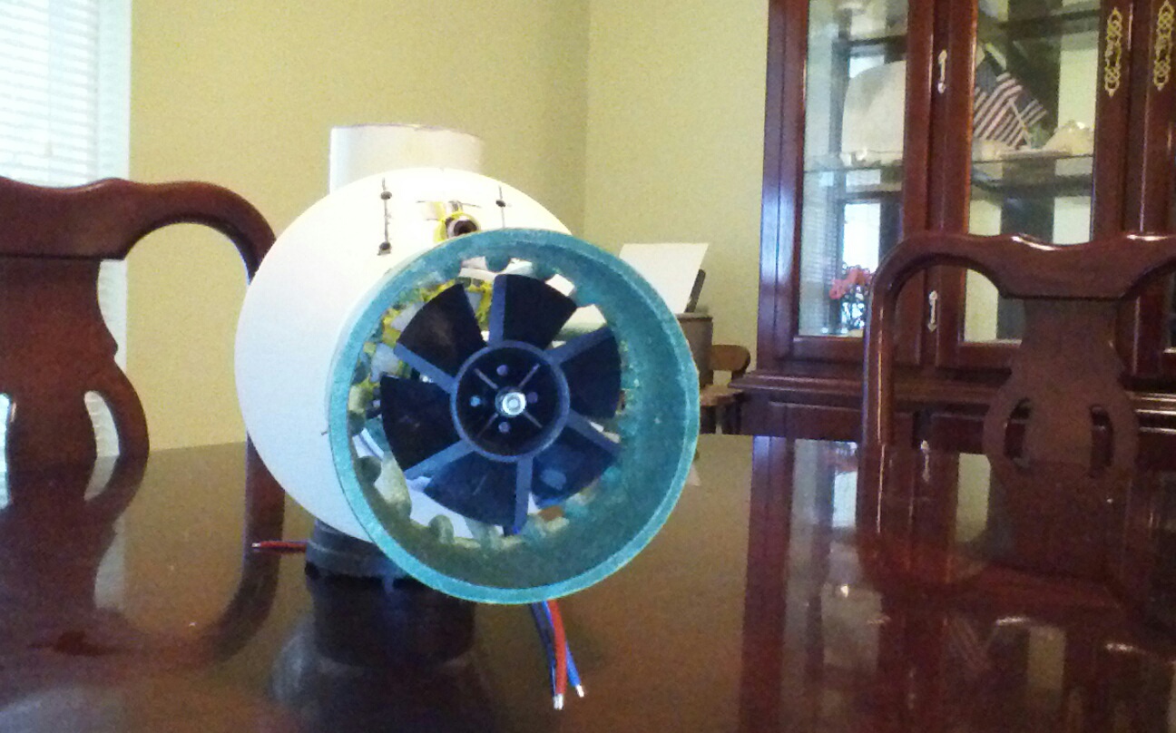

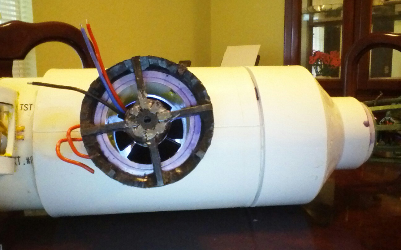

You can drive it like a car. Anyway, some new pics of my updated thrusters.
That under ice unit you linked to was kinda crazy. As you said...taking through-hull thrusters to the extreme.
I really rather like my layout on this build with the through-hull vertical thruster and single horizontal thruster.

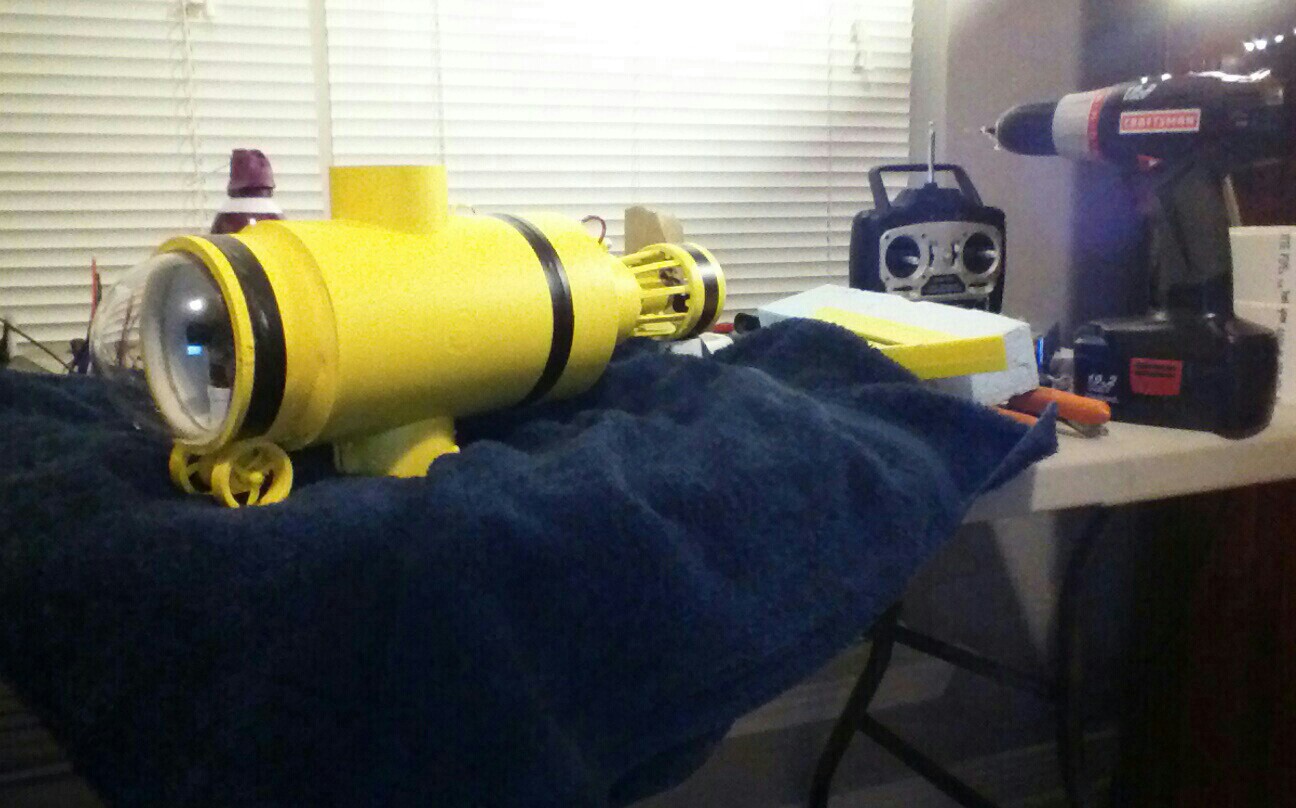

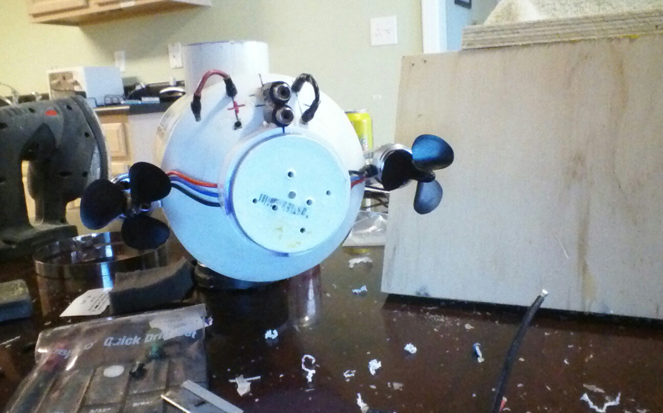

Having to redo the Guppy...again.
The brushed bow thruster arrangement wasn't working out so I'm changing to a tank-drive setup.
I hope to have it back in the water by the end of the week.
