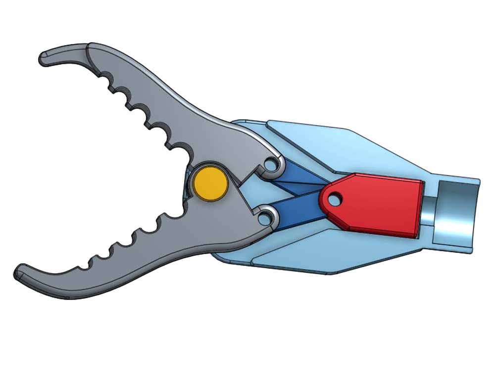

I was introduced to this new online based CAD program the other day called Onshape so I decided to design this a new Manipulator to see how well the program worked.

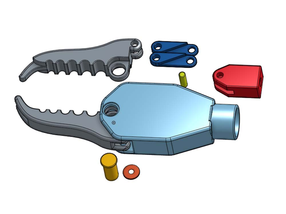

After a few hours of work these are the basics parts of the design that I cam up with. The hand and gripper finger portions of the manipulator will be 3D printed and attach to a PVC arm and motor housing much like some of the other manipulators that I've done in the past.
This is what the parts will look like when assembled.
Here are a few cut away views to show how it works.
It will work of the same thread rod principle I have also used in the post. The actuator rod (not shown) will thread into the red slide block.

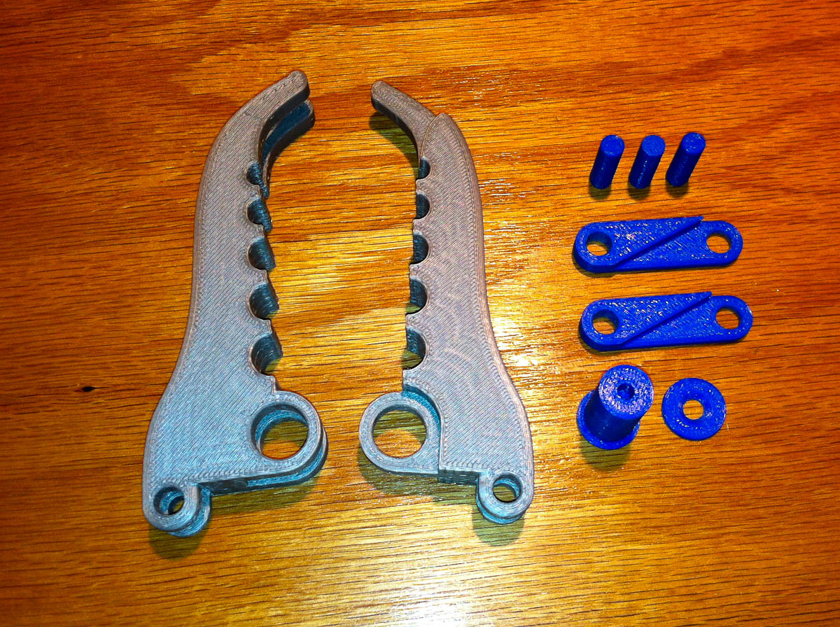

I've already printed out some of the parts at this point.
The basic mechanics seem like they are going to work I just need to print the main body of the hand. This will probably take a good 4-5 hours so I just need to find the time to do this now.
-Steve :grip:

Sweet!! Will it also rotate when finished?
What kind of printer are you using? I'm getting close to finishing my version of your Seafox and i'm already thinking ahead to the next one. Might just have to get myself a printer for that(if my wife lets me).
Re: 3D Printed Manipulator
I was thinking about trying to get it to rotate.... instead of rotating at the wrist I might make the entire housing rotate but I haven't gotten that far in the design yet.
I print with Makergear M2's.

Really nice!!Are going to use gear motor or servo ?

I haven't started drawing up my manipulator yet, I might steal some of your ideas ;)
I am a little concerned about the strength of those pins though. Keep us updated!
It's going to use a geared motor.
The Pins??? Hell I'm concerned about the strength of the whole thing, :lol: but yeah this will be a good test.
Updates will continue shortly...... the hand portion is printing right now. :grip:
It's looking good so far. It's a little bit bigger than I envisioned though, I think it was about half this size in my head. :|
I need to print the slider next I'm just waiting on a special nut that will get imbedded into the print for the threaded rod.

Looks great, do you think you could share the file once you get it working like you want? I would like so modify it to fit my cordless screwdriver or is that what you are going for? I like the fact it has overlap which will help pickup thin objects like rope or wire.

TigerShark wrote:Looks great, do you think you could share the file once you get it working like you want?
Of course... you guys should know by now that I share everything I do. :D (I was open source before there was "open source", wait does that make me a Rov hipster or something?) :lol: I'm not sure what the cad format is though with Onshape I'll have to look into that still.
I'm just going to use a normal geared motor but same difference as a cordless screwdriver I guess.
-Steve
