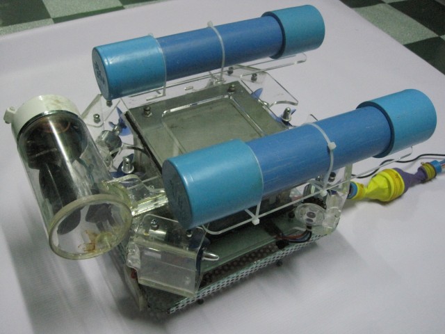

perfo wrote:Thanks for the post. They are slightly smaller motors and ESC than I've ordered so what size is your ROV and do you think these are big enough? Have you got two for forward reverse ?
at 7 GBP per motor replacing them every few years isn't a major downer. Where as the bilge pumps do need a bit of fiddling with to prepare them.
I guess a squirt with WD40 after a dive would probably help. How do you get on for cooling? Are the ESC inside the ROV ?
The size of my ROV is around 1 feet squared and weight is around 3 kg.
We used four horizontal thrusters but the motors turn only half speed when moving forward. When moving 45 deg to forward, two diagonal motors turn at full speed.
The thruster assembly provides more than enough thrust for my ROV. The max speed is around 1 m/s!
The thrust won't be a problem unless you have a very big and heavy ROV.
If you can see in the photo, our ROV consists of two stainless steel plates which sandwich the control box. They are used as heat sinks.
The only glitch with the thruster assembly is the propellers produce less thrust in reverse than in forward.
I'll try to post about my ROV in the near future.
WOW, thanks for the post. I wish there was a 'yearbook' kind of thing for everyone's ROV with a brief write-up or link to more info. I've never seen one quite like this. I have been thinking about doing some kind of thru-hull thing and using it as a heat sink with a pass-through for the heat-generating items like lights, motors and whatnot.
This setup addresses that really well. COOL! (also thanks for the info on the amount of thrust required for a small class ROV). I had started another thread about the different power requirements for different sized (weighted) ROVs and it didn't really go anywhere. Good to see that a small unit like this is amply supplied by small motors.

perfo wrote:I like the ideas...thanks...
Good to know the smaller (cheaper) motors do a fine job. 1m/s (2.3 Mph ish ?) is plenty enough for me..in fact its a bit scary fast for my plans.. I'm not sure I could be trusted with something that is verging on torpedo speeds :)
Haha that's why we don't drive it at full speed for long.
The problem with a small rov is the cable is large relative to the ROV and so the stiffness of the cable has considerable effect on the movement and the maneuverability of the vehicle. You should address that in your ROV.
