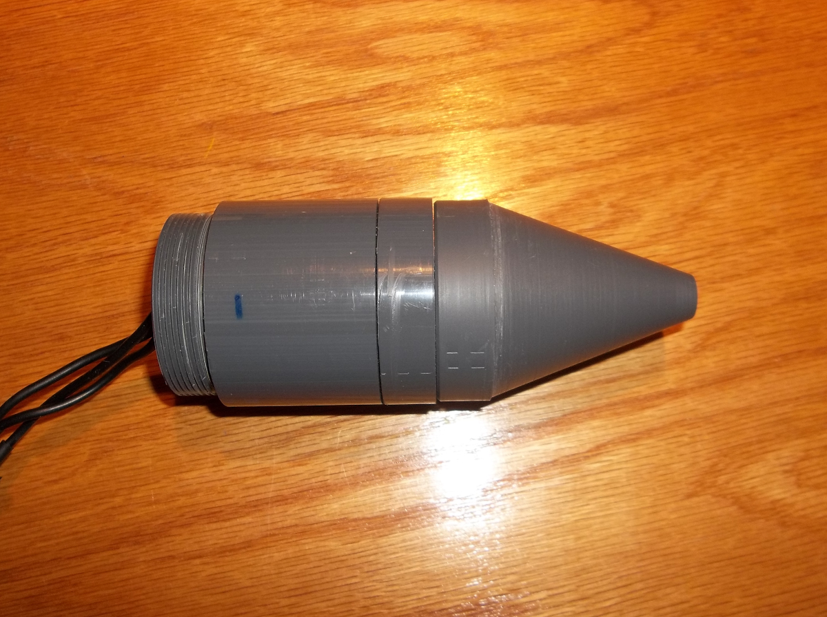

Well here it is all ready get wet and start some testing.

I got this in the test tub today and while it kind of worked it needs some tweaking. It spins right up but before it can reach full throttle the magnets break away from each other. I might try adjusting the gap and see if that helps but it might just need more magnets. I didn't bother testing the thrust or amps draw because I only was trying to see if the coupler worked. Anyway I'm going to try the gap adjustment first and then go from there.....

I think its more just breaking loose because of the drag of the prop at higher speeds. Even if I increase the throttle as slowly as I can it still breaks away before hitting top rpm. The whole protecting the motor aspect encase of a tangling is exactly what I'm going for though. That's why I designed the motor mount to be adjustable so I could dial in the break away force to allow for such things. Hopeful once I add a few magnets it will be strong enough so I can get to that point.
