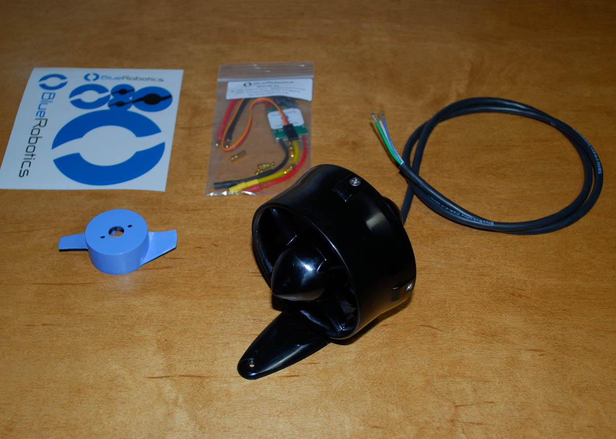

I jumped on the kickstarter as soon as I saw it and backed the thruster and added on the speed controller. They threw in the mount as a stretch goal and it's should be easy to mount to any flat surface.

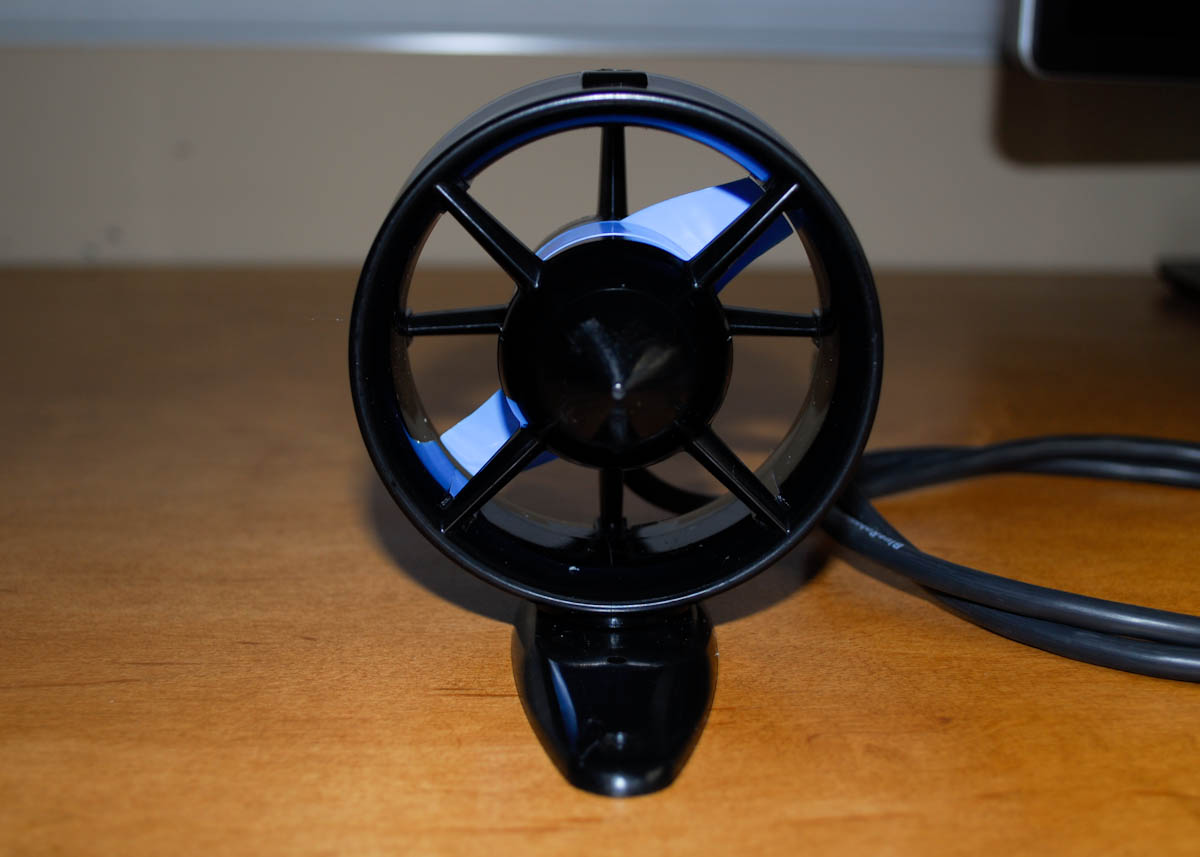

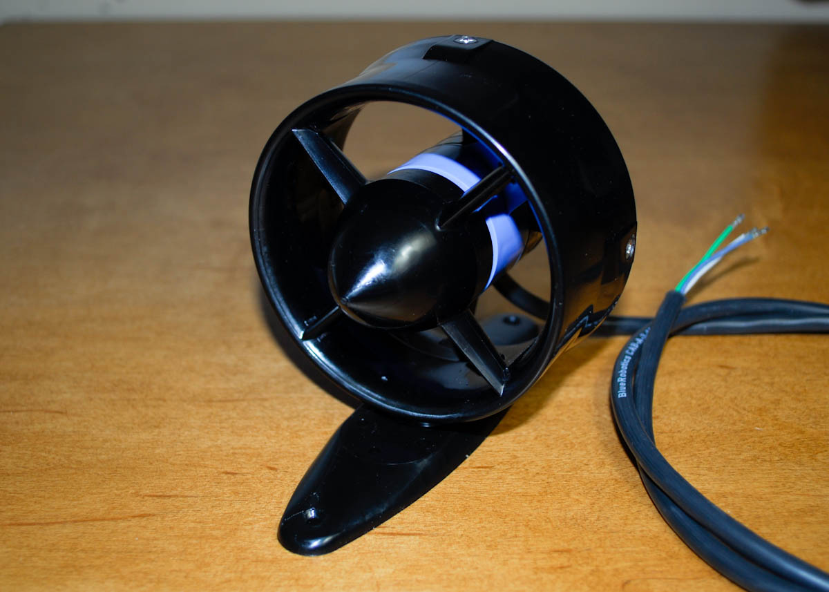

My initial reaction was pure awe, these things look awesome. If these work as well as they are suppose to these are going to change the home building Rov game a lot.
The size is perfect for most of the Rov's us home builders are making.

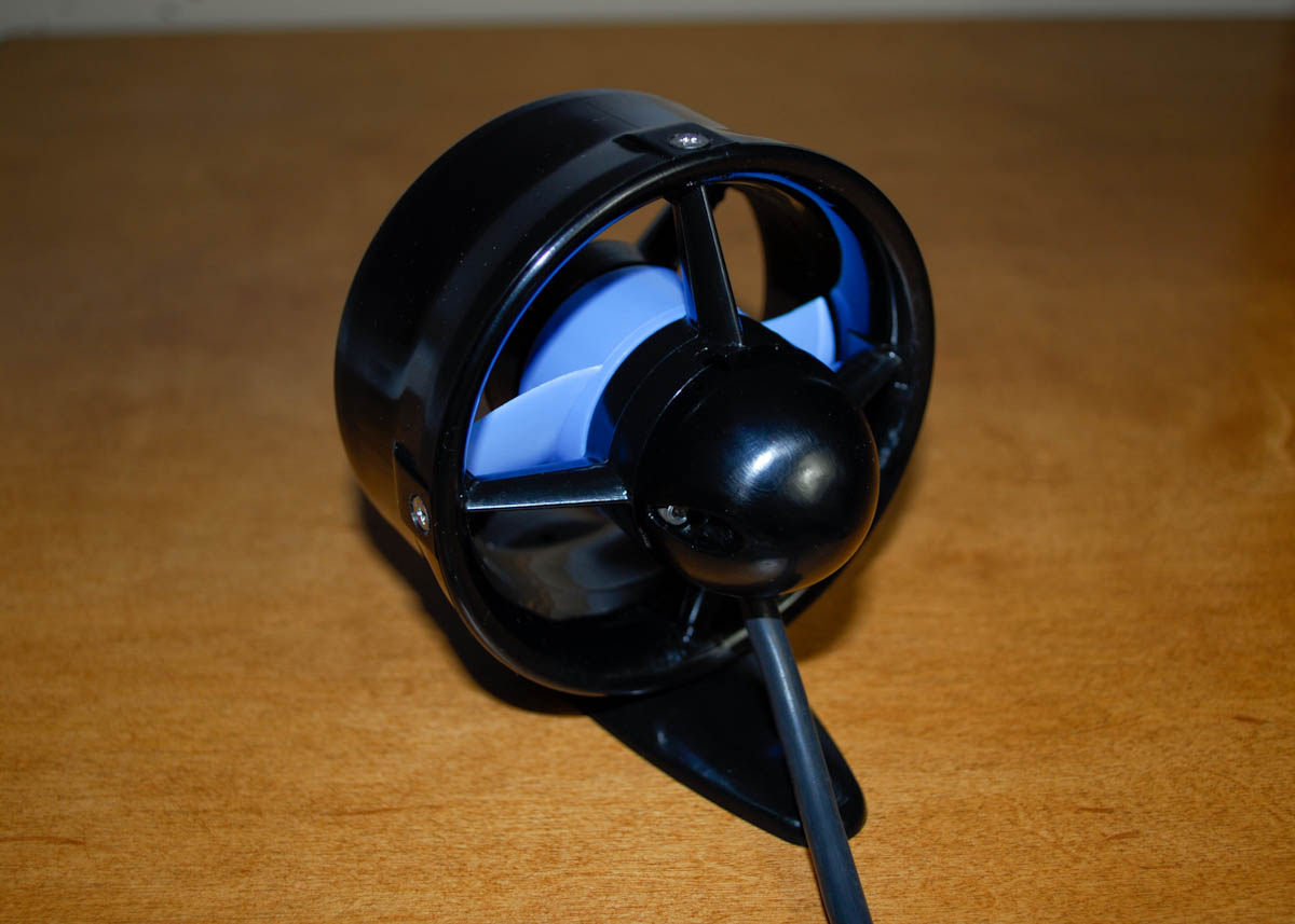

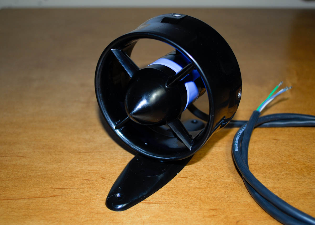

It's about the same overall size of a bilge pump thruster with the nozzle being just around 3.75" in diameter.

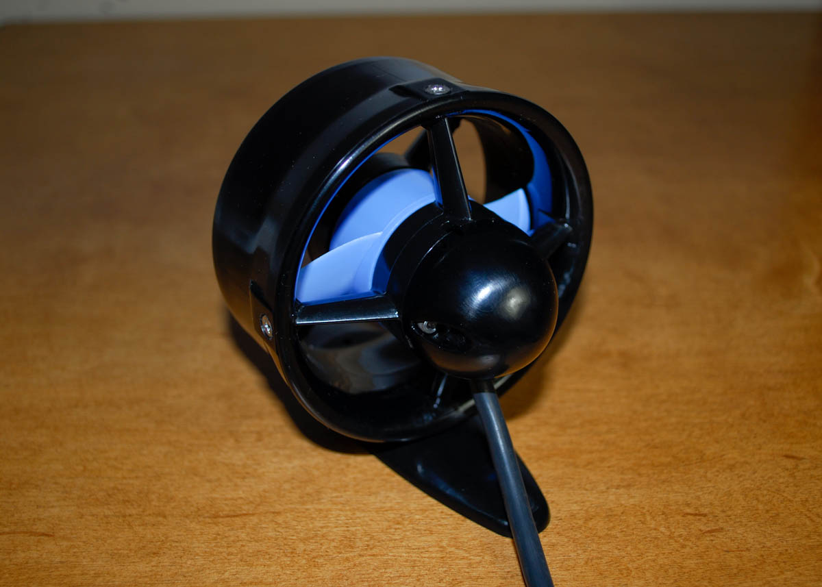

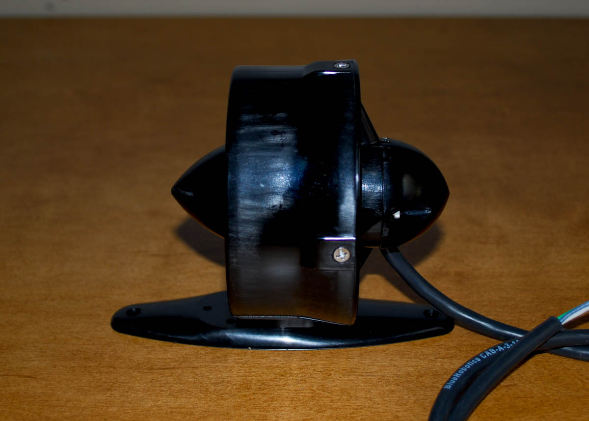

This picture is a bit deceiving as the nozzle looks all scratched up. Rest assured those are just marks from when its popped out of the injection mold and are hardly visible to the naked eye. (Here they are just really accentuated by the flash on my camera.)

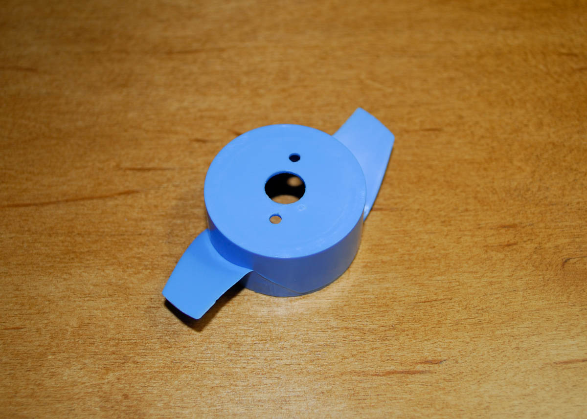

The blade of the prop look really tiny but this thing is suppose to put out around 5lbs of thrust.

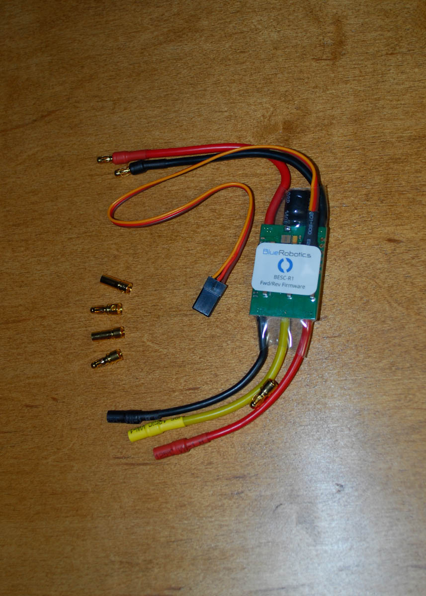

While they do have a version with an integrated speed control I chose the external speed control encase I burn it out it testing this thing. (I'm not to versed on the Brushless stuff and I all ready fried one controller testing my magnetic drive project.

How do you plan to cool the ESCs?
TCIII/SSN626B
Re: BlueRobotics T100 Thruster (First Look and Testing)
I honestly haven't thought about it, I only bought this one so I could test them to see if they are worth recommending to people looking for cheap thrusters.
If I was going to make an Rov with these I'd probably just get the ones with integrated speed controllers so I wouldn't have to worry about cooling or even housing space for that matter.

Hi Steve,
I also bought three of the T100 Thrusters, but with the built-in ESCs so I would not have to be concerned about cooling the ESCs.
Depending on how well Blue Robotics has sized their ESC in relation to the motor's maximum expected current draw I would keep a finger on the ESC's FETs to make sure that they do not overheat. Though knowing how thorough Blue Robotics has been in proofing their designs, I would suspect that the ESC is robust enough to work in free air for short periods.
TCIII/SSN626B
Good point I'll keep an eye on that. Another thing I should point out to others is I'm sure we will rarely be at full throttle on any Rov thruster for that long of a period with the exception of diving and surfacing but even then I doubt full throttle is required.

If you still have your test rig set up, I would really like to know what the voltage is from the battery when the thruster is at full throttle. Sounds like you might be getting a pretty large voltage drop at the battery or through the cable to the ESC. The thruster should draw about 13 amps at 12 V at full throttle and get more thrust.
Regarding the ESC, it is rated at 30 amps and barely warms up when used with the T100. I wouldn't worry about it too much. The BlueESC is built for about 25 amps in air and more in water.
