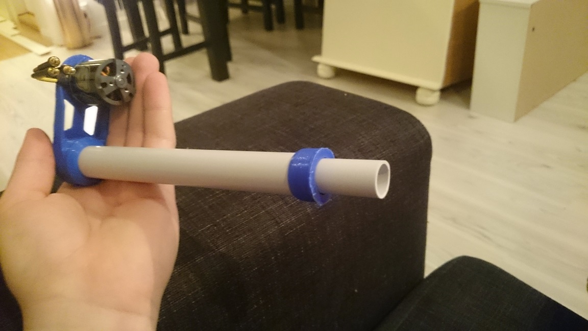

So not much done here in a while. But printed the first two parts for my next prototype today.
Who can guess what this hopefully will be when it's done?
Posts: 289
Location: New Jersey Shore
Re: I'm jumping in!
Post by a_shorething »
I give up. I think you said you were working on some kind of gripper or grabber. Is this the arm for that?

Re: I'm jumping in!
Post by olegodo »
Yes. Using the same design ideas as with the thrusters. That is, running the motor and everything else flooded with water (With protective measures taken ofc)
For this first prototype, the motor will drive a 1:10 gearing, with built in clutch. this will then rotate a threaded rod inside the tubes. The piston, the smallest diameter tube in the picture, will have a nut in it. transforming it from rotational motion to linear motion.
The idea is that the clutch will start slipping when the piston is at the ends of its travel or when the load is to high. The clutch will also be adjustable.
I will try using the same motor as the thrusters, but I might need to move over to one with a bigger diameter to get more torque. we will see!

I know we spoke about the possibility of using stepper motors for different things. Maybe this is the right application for that. Low speed, precise operation, high torque (and low cost). The NEMA 17 is a good choice I would think. The only issue would be: Can you do the same kind of protective measures on a stepper that you can on a brushless motor?
olegodo
Posts: 222
Location: Bergen, Norway
Re: I'm jumping in!
Post by olegodo »
The size, weight and need for an enclosure kind of turned me off using nema17 steppers. I have them so if this method doesn't work I can still try that approach.
I really don't think the accuracy of the steppers are needed for this application. After all the gear reduction I will be using with the brush less motors I believe it will be plenty accurate.
We will see in a few weeks after the holidays and new years happenings are over :)
